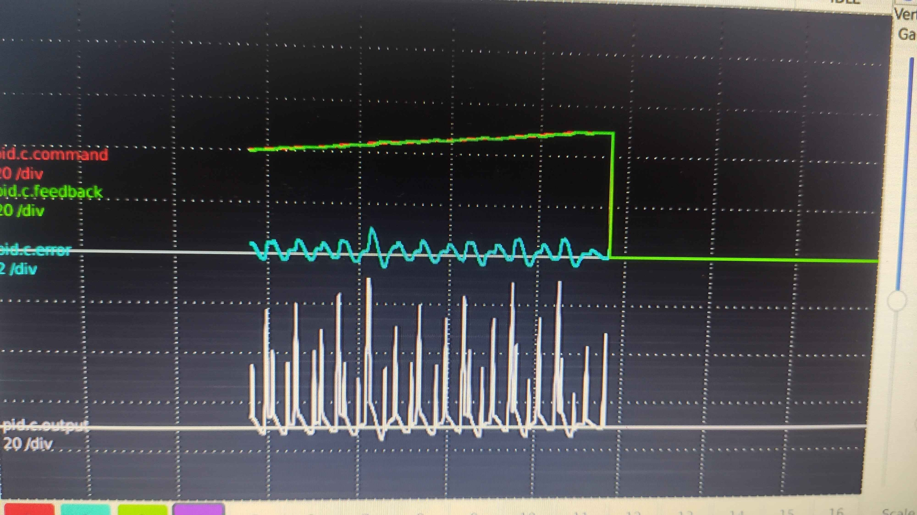

14 Apr 2026 15:43 #345554 by PCW
Replied by PCW on topic Lathe C axis homing
Can you plot (with halscope) the C axis commanded and feedback positions?
That would help diagnose the issue.

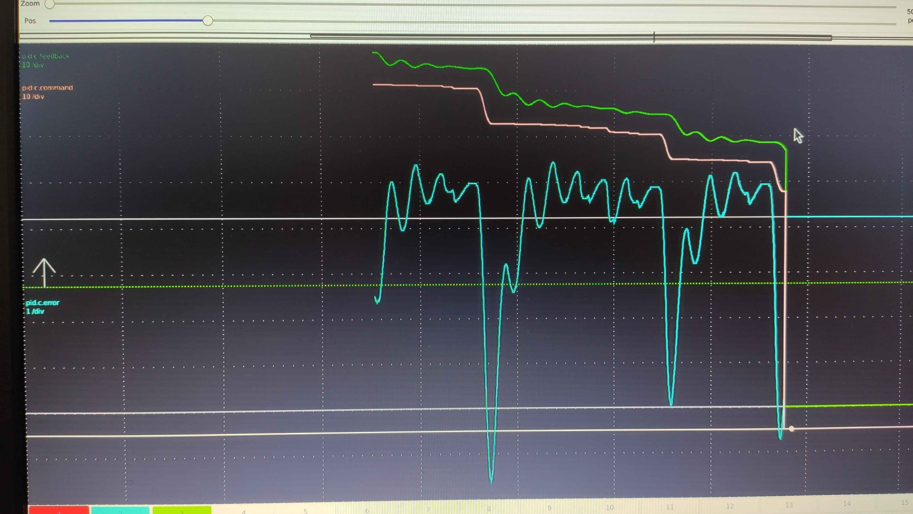

14 Apr 2026 17:03 #345557 by jetbadger
Replied by jetbadger on topic Lathe C axis homing
I have these snippets right now. The first is the original behaviour and the next one is after a full day of tweaking the PID values and acceleration. In both the axis moves very slowly.
14 Apr 2026 18:23 #345562 by PCW
I guess my question now would be: Why are there relatively huge steps in the commanded position?

15 Apr 2026 01:32 #345569 by jetbadger
That's exactly the issue I can't get rid of. This is just with G0Cxx commands. I'm suspecting if I zoomed in the second plot enough it would look the same just at higher frequency. For example when homing it acts fine but that's probably because the commanded position is instantly much different and the PID loop takes care of reaching it. But here the commanded position supposed to trail ahead by some degree to let the PID do it's thing I suppose and it just doesn't seem to work with the joint either reaching the position and output going to 0 and then falling behind and shooting up, rinse and repeat... If I lower the P ratio to where it trails just behind, the commanded position slows down aswell eventually leading to coarse steps like before.
