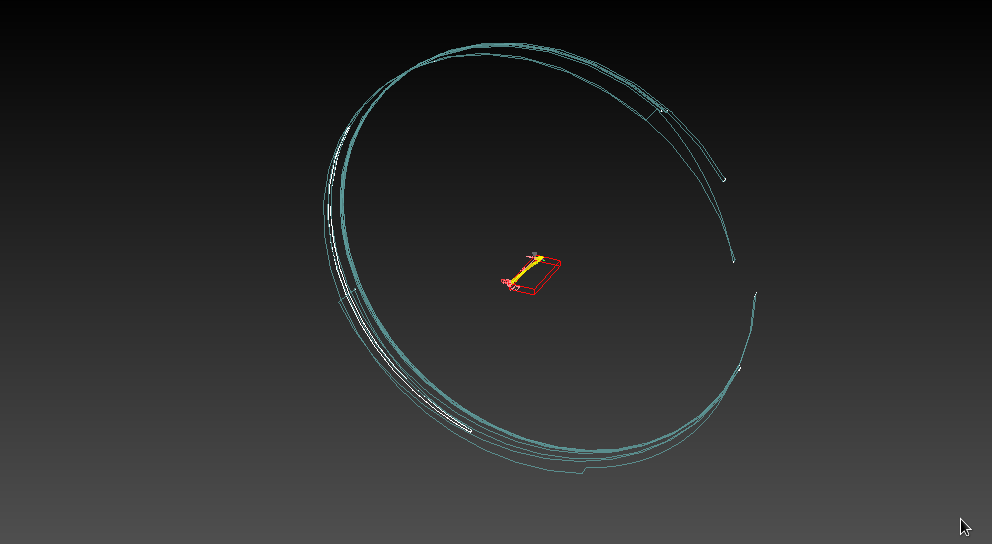

I have a 4-axis MPCNC with a rotary B axis mounted at the far end of the Y travel (machine Y=700mm). The rotary axis is fixed — it does not move along Y.
G-code is generated by CAM with program zero at the chuck face, all moves go in Y-.
The problem: the backplotter does not display the toolpath correctly. Instead of showing the wrapped toolpath around the tube near the chuck, it draws a large circle. I believe this happens because the backplotter uses machine zero as the centre of rotation rather than the actual chuck position.
Setup:
- LinuxCNC 2.9.8 stable
- trivkins coordinates=XXYYZB, 6 joints
- qtdragon_hd interface
- GEOMETRY = !-BXYZ
Is there any way to tell the backplotter where the centre of rotation is?

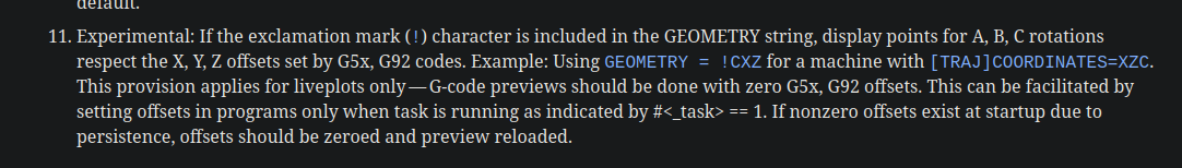

Note that the _preview_ does not take offsets into account:
linuxcnc.org/docs/stable/html/config/ini...sub:ini:sec:rs274ngc

I am aware of the ! prefix in GEOMETRY — it is already set in my config (GEOMETRY = !-BXYZ).
However, as the documentation states, this provision applies for liveplots only. I am using qtdragon_hd, not AXIS. Does the ! prefix in GEOMETRY have any effect on the qtdragon_hd backplotter, or is it AXIS-specific only?

I have never seen a - used there.
Replied by tommylight on topic Rotary axis backplot — centre of rotation not following WCS offset
Remove the - after the !I am aware of the ! prefix in GEOMETRY — it is already set in my config (GEOMETRY = !-BXYZ).

Yes, for hal scaling and output and encoder count direction, but i do not know if that works for geometry.

But the main question is still open: is there any way to tell the backplotter where the centre of rotation is, when the rotary chuck is not at machine Y=0?
In my case the chuck is fixed at Y=700mm. The backplotter always rotates around Y=0 (machine origin), so the wrapped toolpath displays as a large circle far from the actual machine envelope instead of showing correctly near the chuck.
I have already seen the 2013 thread where andypugh said there is no solution.
Is this still the case in 2.9.8, or has anything changed since then?
