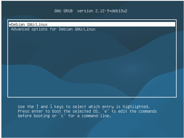

07 Aug 2026 22:50 #348546
by MaHa
Replied by MaHa on topic Ver 10 NEW install
I was able to reproduce this in a virtualbox test-installation. After entering a wrong name/passw i was locked out. This solution gave me access again. And after that procedure, even entering the password wrong once, did'nt lock me out. Just enter correct password and login.
after this popup
Press the e key to open the boot parameter editor
Locate the text snippet ro quiet splash (or just ro).
Replace ro with rw and append init=/bin/bash to the end of the line. The end of your line should look exactly like this:
rw quiet splash init=/bin/bash
Press F10 to boot with these temporary settings.
Reset Your Password
The system will bypass the usual login screen and drop you directly into a root command prompt terminal (indicated by #).
Ensure the system partition is writeable by running:
mount -n -o remount,rw /
If you do not remember your exact system username, view it by typing:
ls /home
Type the password reset command followed by your account username:
passwd username
Enter your new password twice when prompted. Note: The text will not appear on the screen

- 5280
- Posts: 21
08 Aug 2026 16:11 #348560
by 5280
Replied by 5280 on topic Ver 10 NEW install
thanks for the effort.. I think it is called a locked loop I have seen this also.
I have found that if i do a
ctrl + alt + F3
it takes me to the terminal login screen at which point I am able to log in with user name and password that was setup during setup and then do things in terminal mode. terminal mode seems to be working just fine. I have done the updates and the upgrade. per info on terminal screens but nothing past that at this point.
AI says there is fix for this locked loop thing but I have not done it yet. will do it later on.. now i have to learn all the command line stuff if i live that long .?
Thanks again for the help.
Ken

08 Aug 2026 17:33 - 08 Aug 2026 17:35 #348563
Replied by tommylight on topic Ver 10 NEW install
hmmm that might also be a hardware issue, usually dry capacitors or memory problems, although memory problems will show up during boot in most cases.
You might want to try Linux Mint Debian Edition, after install and reboot:
sudo apt update
sudo apt install linuxcnc-uspace
But this will be an older version of 2.9, not the master version or 2.10
Edit:
if you want to continue with ctrl+alt+F3 , type startx and check what errors it shows up.

- NWE
- Posts: 271
- Thank you received: 84
08 Aug 2026 23:59 - 09 Aug 2026 00:01 #348577
by NWE
Replied by NWE on topic Ver 10 NEW install
run the following cammand at the terminal:
systemctl get-default
if it replies with
multi-user.target
then that is what is wrong. Run
sudo systemctl set-default graphical.target
or if it replied with
graphical.target
then this is not the problem, it takes more diagnostics.
if it replies with
multi-user.target
graphical.target
