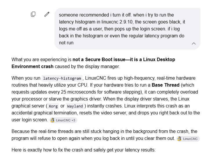

i installed linuxcnc 2.9.10 via the released ISO. when i run the latency histogram from the application menu, it logs me out and pops up the login screen. i login again, and then the latency histogram program wont run at all. neither will the regular latency test. if i reboot, i can run the regular latency test, but if i try the histogram, it logs me out again.
is this a bug or maybe something wrong with my new system?

Google ai's answer is quite incorrect. I don't see what cpu you got, but with the motherboard you listed, I think any CPU it would be compatible with would have many times more capacity than what LinuxCNC could possibly use.
There are a couple different things that could cause your problem:
1. Possible data error during iso file download and install. Download a second copy and try that or maybe install 7zip which is one program I think of right now which makes it convenient to check sum files in Windows.
2. USB memory device error - try a different one.
3. Motherboard/hardware incompatibility. What you got certainly is fast and powerful enough for LinuxCNC but sometimes odd incompatibilities pop up between hardware/firmware/OS.
