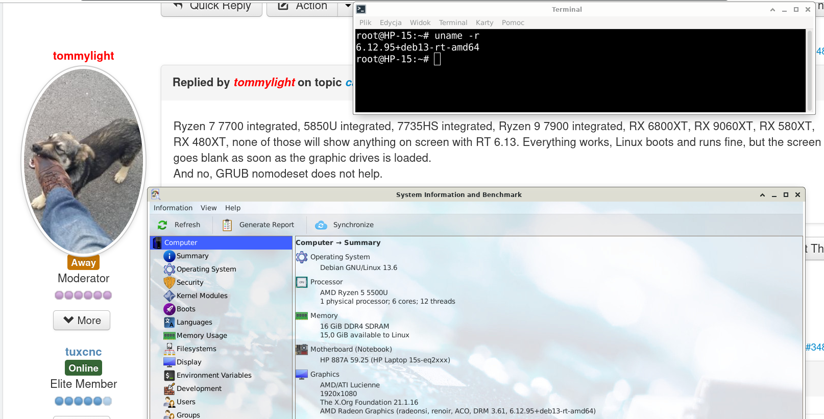

09 Aug 2026 17:50 #348609
by tuxcnc
My Ryzens work with all Debian13 RT kernels (computer I write from is Ryzen 5500U, kernel 6.12.95+deb13-rt-amd64).
My AMD A10-7800 work with 6.12.63+deb13-rt-amd64 RT kernel.
With newer than 6.12.63+deb13-rt-amd64 works too, but only with low or medium resolution, enough for Axis or Gmoccapy.
The solution for blank screen is boot with nomodeset kernel parameter (gpu runs but without hardware acceleration) and change GRUB's and system's screen resolution to low, restart and test higher resolutions.
Replied by tuxcnc on topic cant run latency histogram
There is some bug in newer amdgpu driver, but works.AMD graphic cards do not work with new RT kernels, 4.19 is the last one that worked.
Does the CPU have an integrated graphic?
Intel works fine with RT kernel, NVIDIA works but causes issues so is unusable, AMD goes to black screen, al this with 6.13 RT kernel.
Had no time to test the 7.nn kernels yet.

09 Aug 2026 19:09 #348613
Replied by tommylight on topic cant run latency histogram
Ryzen 7 7700 integrated, 5850U integrated, 7735HS integrated, Ryzen 9 7900 integrated, RX 6800XT, RX 9060XT, RX 580XT, RX 480XT, none of those will show anything on screen with RT 6.13. Everything works, Linux boots and runs fine, but the screen goes blank as soon as the graphic drives is loaded.
And no, GRUB nomodeset does not help.
