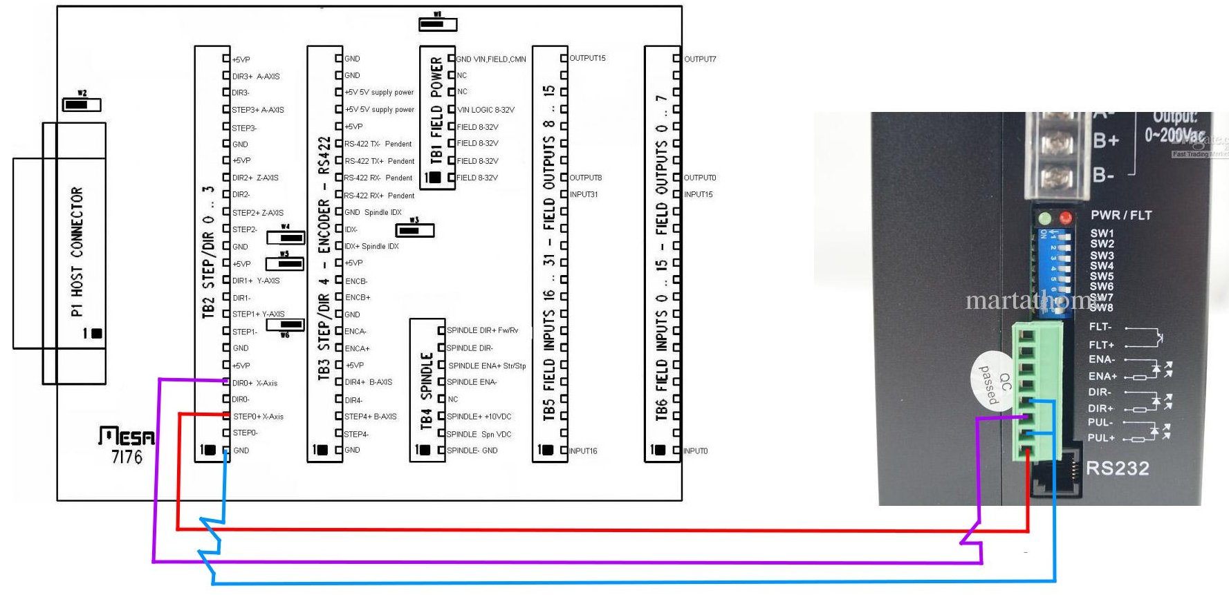

Hi guys!
The engine makes noise being stopped, as I put the principle can not give the correct values to the parameters.
Step_Len: 2500
Step Space: 2500
Dir_hold: 5000
Dir_Setup: 5000

We also want to change the connection of the cables, so what would you say PCW:
Doing this will improve?

First thing I would is change the P term to 1000 (was 50)
The wiring looks correct but sometimes the differential outputs do not work very well with high input
current drives so it might be worth trying with common ground wiring (connect PUL- AND DIR- to ground instead of 7I76 outputs and leave the 7I76 dir- and step- outputs unconnected)
You might also verify that the 5V at the 7I76 is not less then 4.75V or so
We not yet verified the voltage, tomorrow we will.
