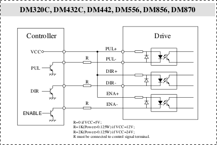

Can you post your hal and ini files?

12 Jan 2017 13:33 #85664
by squan09
Replied by squan09 on topic Mesa 5i25/7i76 + driver leadshine DM2282 digital
Here are the .ini and .hal files I am using. I am currently focused on the X axis so the others can be ignored. I am using the drive setup with 8x microstepping and it is not attached to any lead screws for testing. For now I would like to tune it to get performance similar to when I use the auto tune program supplied by Leadshine.
I am also using the drive in the common anode cofiguration (image attached), with PUL+ and DIR+ connected to +5Vp on pin 6 on the 7i76 nad PUL- and DIR- connected to STEP0- and DIR0- on the 7i76.
Please let me know if there is any other info I can provide and thanks for the help.

12 Jan 2017 13:57 - 12 Jan 2017 14:09 #85666
Replied by PCW on topic Mesa 5i25/7i76 + driver leadshine DM2282 digital
A couple of observations:
I looks like you have only fixed the max_error and PID values for the X axis
also the X axis has some odd settings (max velocity of 50 IPS but max output of 6.25 IPS)
I would fix the max _error/PID values for all axis and remove all the max_output statements as a start
EDIT: in fact with the max_output setting of 6.25 and a step scale of 1600 and 1/8 ustep ratio (1" per turn)
I would expect to throw a following error at 375 RPM

12 Jan 2017 14:24 #85667
by squan09
Thank you. Changing MAX_OUTPUT was exactly what I needed. I was not able to remove it though. I got an error that the variable was not found, so I just changed it to be equal to STEPGEN_MAXVEL. I've attached my updated .hal and .ini for reference.

12 Jan 2017 15:18 - 12 Jan 2017 15:18 #85670
you would have to delete it from the hal file
( deleting it from the ini file will cause the hal file parser to bitch when it doesn't find the constant )
