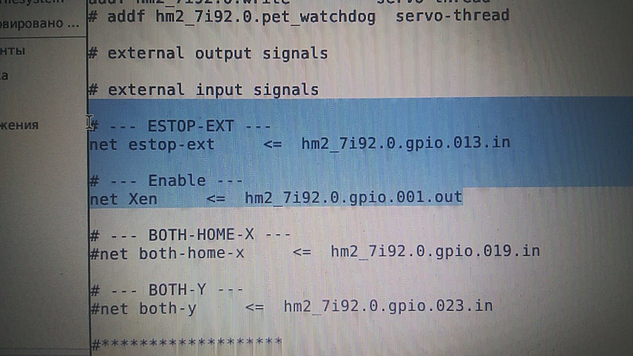

Hello. This is my first experience with the use of EMC2. After the spoiled details on MACH3, I bought Mesa 7i92. The problem is that drivers Leadshine AM882H goes into error if there is no software Enable. When the power is turned on, it indicates a phase error, or a current error. With the software Enable, everything works well. But I can not assign to a free pin - I do not know how to register. I would also like to connect a touch probe and an external e-stop, but it's already secondary. Without software enable I can not work. I tried to write like this:
But still on all free gpio + 5v.
Sorry for my english. Thank you in advance for your cooperation.

Replied by andypugh on topic Mesa 7i92M Support
Is the Xen signal connected to anything else?

24 Oct 2017 04:58 #100739
by Bordug
Replied by Bordug on topic Mesa 7i92M Support
Physically, it is connected to an oscilloscope. I look at the oscilloscope as the signal changes. At the moment there is always + 5V, as on other free iO. In the configuration, I didn't write anything else - I don't know how.
I was meaning in the HAL file, is anything driving the Xen signal?
Also, have you set the GPIO pin in question to output mode (and, optionally, to open-drain mode?)
linuxcnc.org/docs/2.7/html/man/man9/hostmot2.9.html#General Purpose I/O
setp hm2_7i92.0.gpio.001.is-output 1
#setp hm2_7i92.0.gpio.001.is_opendrain 1
But even then nothing will happen unless the Xen signal is driven by a HAL output pin (such as axis.0.amp-enable-out)
