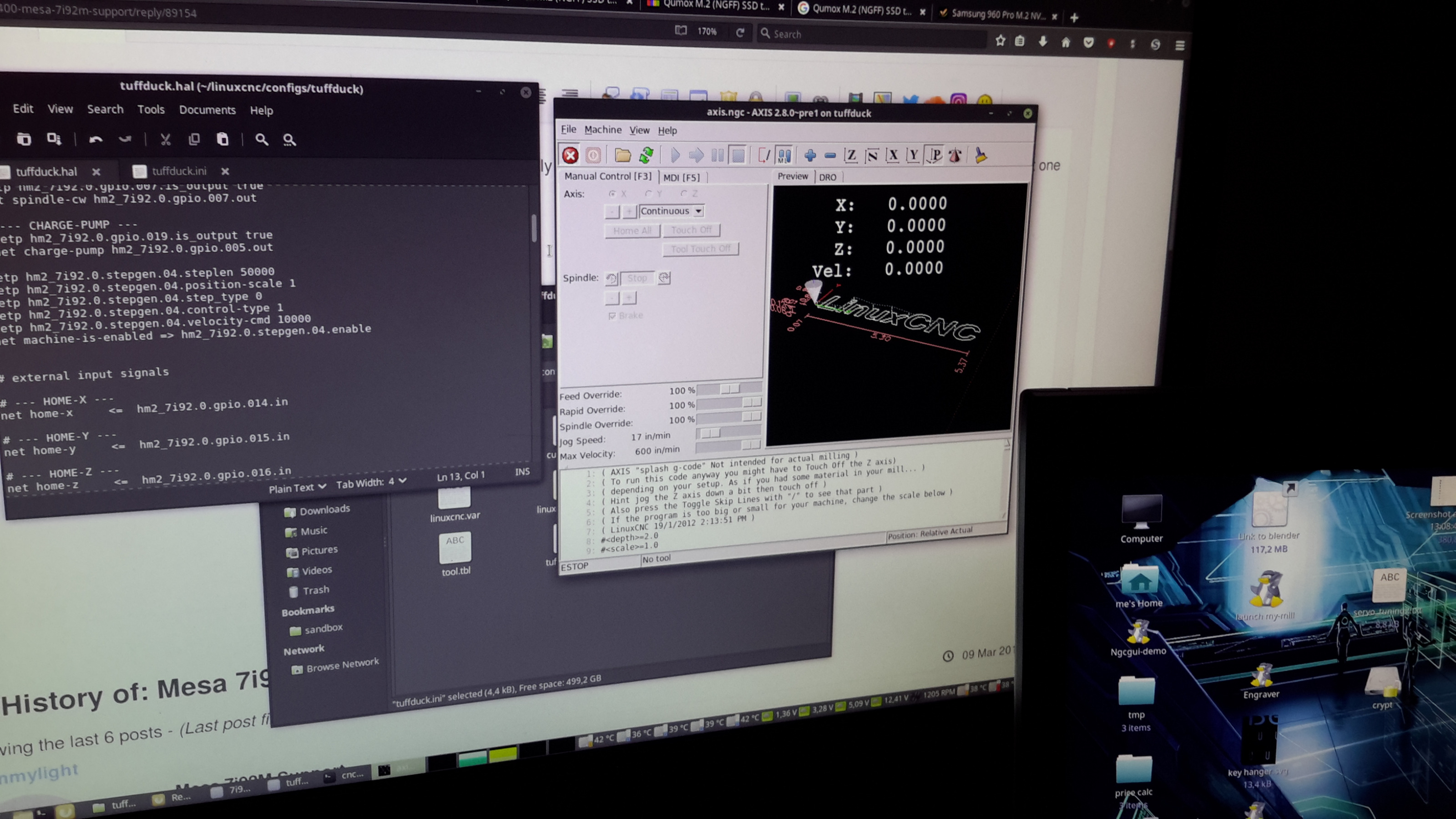

Hi Tom,
I managed to get V2.8 installed. I fired up your build..No error message.. No active charge pump. With the charge pump off the Y axis and the Z axis will move real slow but no X.

A couple of things:
There's no chargepump code in the hal file
you must add the code for stepgen04 I suggested several posts ago
(and bump the num_stepgens # to 5)
Also the step times are too short for the G540 so are likely marginal
I would set the step time and step space for all axis to 2500 ns
BTW its not surprising the motion is slow, from the ini file:
MAX_VELOCITY = 0.0333333333333
You might try changing this to
MAX_VELOCITY = 3
which requires this additional change:
STEPGEN_MAXVEL = 3.75

- Posts: 18122
- Thank you received: 5337
08 Mar 2017 18:40 - 08 Mar 2017 19:04 #89225
I don't think you have the charge pump GPIO assignment correct as a G540 the charge pump is GPIO5 (DB25 P16)
Also the output of the chargepump (charge-pump.out) is not connected to the GPIO pin
I suggested the stepgen way of running the chargpump as it can generate the G540s specified 10 KHz signal

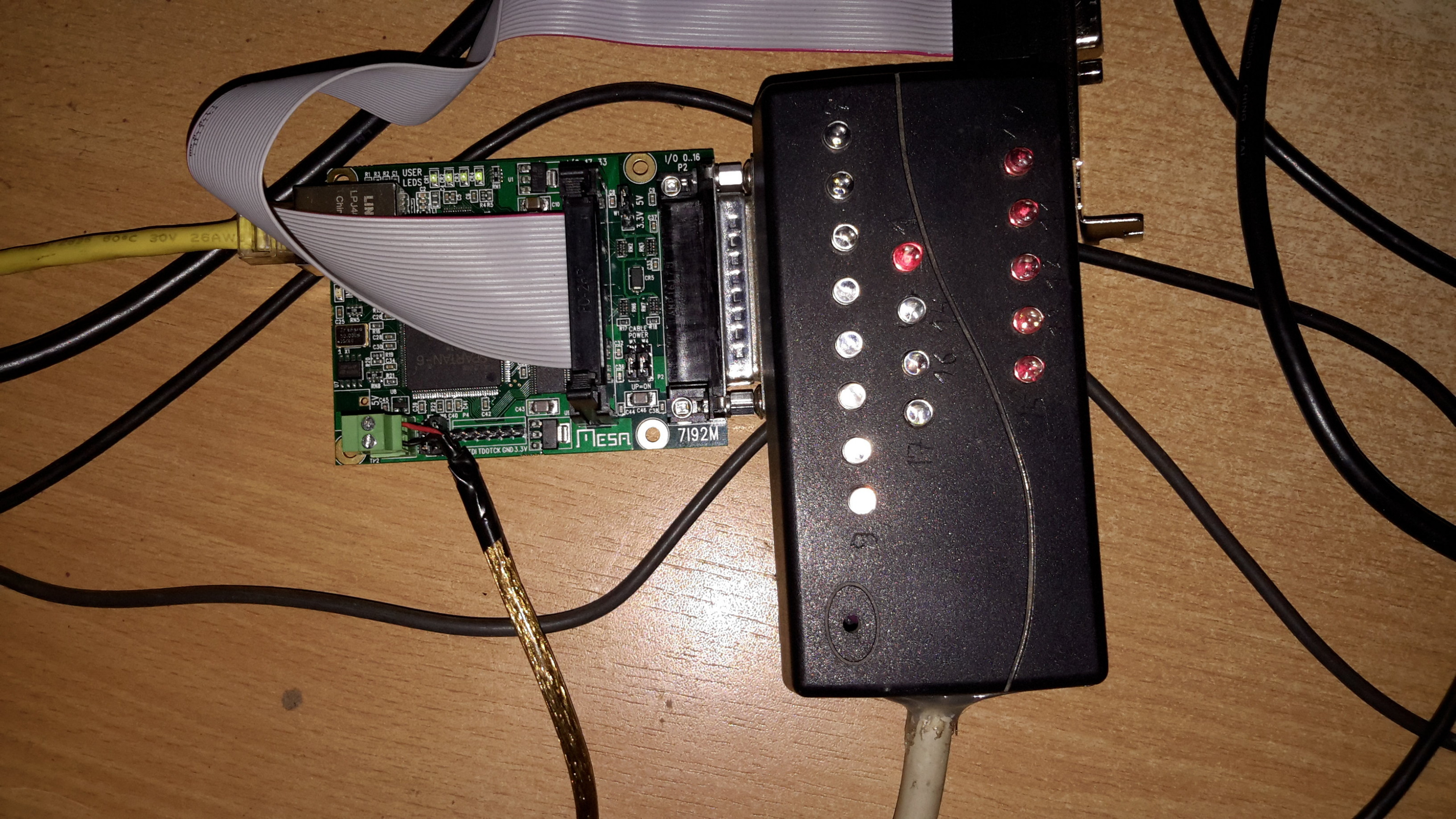

08 Mar 2017 19:16 #89228
Replied by tommylight on topic Mesa 7i92M Support
Thank you PCW, that means i have to check my parallel port control box as i do get light on pin 16, but as the 7i92 has all lights on when not functioning (pull up resistors), and it switches most of them off when active, i did not check for the difference in intensity. Now as you start wondering what i am going on about, i have boxes with parallel port connectors and LED for all the pins, so i can see what is pin is on or off.
