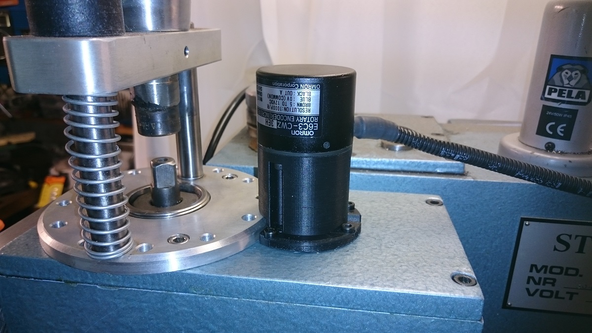

Replied by tecno on topic Help needed to get my 7i76E + 7i85S + 7i73 on my mill going.
Hal show
Turning spindle by hand very very slowly where I can clearly see A/B transitions but nothing on Index.
What is the best way to check spindle Index function within LCNC? Any examples to try?

19 Aug 2017 06:05 #97735
The definitive way would be to "sets xxx-index-enable true" then rotate the spindle and see if it ever goes false.
The software needs to see index-enable go false to start the tapping cycle, but I don't know if it technically requires that it be in the right place unless you are doing rigid tapping.
You could try an experiment where you start a rigid tapping move (MDI) then manually "sets xxx-index-enable false" when you see it get set to true. It will either work or give a following error, I don't know which. If it gives a following-error then it means that it also requires the counts to be zeroed (another effect of index-enable)
I can imagine generating an index pulse in HAL and sending that to the encoder counter working (just as long as you don't peck-tap)

19 Aug 2017 07:03 #97740
by tecno
Sorry No Go so the index pulse is broken.

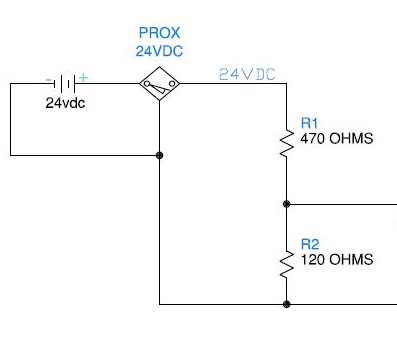

So I will have to go with inductive sensor but all I have are suited for 24VDC.
How can I safely connect these 3-wire sensors like this one www.ifm.com/products/ind/ds/IE5288.htm
Assuming a serial resistor on pin 4 to pin 13 on TB3?
Is this OK with a divider?
Found another better one that can do 3kHz = PNP NO
Done some testing supplying 4.9VDC and I get out 4.3VDC, any chance this can be reliable up to 3kHz?
Specs say to supply 10-30VDC
Last edit: 19 Aug 2017 08:45 by tecno. Reason: Added picture - added text

20 Aug 2017 03:15 #97762
Replied by andypugh on topic Help needed to get my 7i76E + 7i85S + 7i73 on my mill going.
If you use NPN proximity switches you can connect them directly to 7i73 inputs as they act as a switch-to-ground.
I have 24V NPN proxes connected to the 7i73 in my Lathe apron.
(Don't try this with PNP though)

20 Aug 2017 03:17 #97763
by tecno
Spindle encoder on 7i76e with no Index pulse.
Have only PNP for max 3kHz in my bag of tricks
