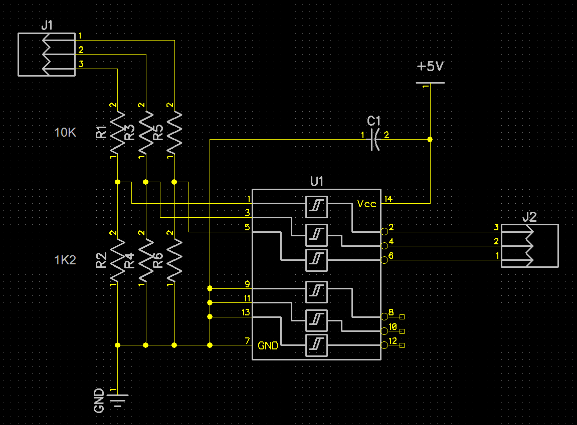

Contemplating to change to another working encoder but this one is for 24VDC, so to make this work I have to use optocoupler and I wonder if PC847 is fast enough? I have boards ready for this type of level conversion.
Problem is that I have no documentation for the encoder so I do not know how many pulses/rev it has.

Just got info from factory here in Sweden that this encoder is 1000ppr.
So my question still is if I go the optocoupler way to get voltages OK, does 1000ppr fit into PC847 specs or do I need
faster optos and if so how fast do they have to be?

21 Aug 2017 10:21 #97819
Replied by PCW on topic Help needed to get my 7i76E + 7i85S + 7i73 on my mill going.
Well, a 1000 PPR encoder will output 1000 Hz square waves (500 usec high/low)
at 1 RPS (60 RPM) so you need < 50 usec response time to get to 600 RPM...

OK so typical rise and fall is 4µs for PC817/847 so it would cut the cake if I have my math correct
That should work though I would choose say 2K for the low side resistors
so you get a valid 4V high at the 74HCT14 input instead a marginally high level of 2.18V
with 1K
with 1K
