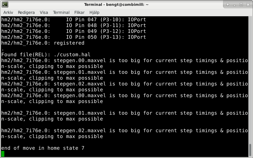

Q3
What parameters do I have to edit?

# these are in nanoseconds
DIRSETUP = 1000
DIRHOLD = 1000
STEPLEN = 1000
STEPSPACE = 1000
If I change to 500 the error message disappears but then I get no movement..
DIRSETUP = 1000
DIRHOLD = 1000
STEPLEN = 1000
STEPSPACE = 1000

26 Aug 2017 21:11 - 26 Aug 2017 21:12 #98053
Replied by rodw on topic Help needed to get my 7i76E + 7i85S + 7i73 on my mill going.
Try increasing these in your ini file.
You could also reduce microstepping but you'll need to change the scale.
These are the settings I'm using on my 7i76e. Some people were horrified I had some so short, but hey its working up to about 90 kHz. This will be hardware dependent (eg your stepper controller)
STEPGEN_MAXVEL = XXX
STEPGEN_MAXACCEL = XXXYou could also reduce microstepping but you'll need to change the scale.
DIRSETUP = 500
DIRHOLD = 500
STEPLEN = 2500
STEPSPACE = 2500
Last edit: 26 Aug 2017 21:12 by rodw.

G'day Rod,
I have no microstepping settings on these AC servodrives not that I can find anyways. Chinese Lichuan B2.
www.europages.se/SHENZHEN-XINLICHUAN-ELE...uction%20Book~2.html
The documentation is very hard to read as it is probably google translated.
Will try to do some more testing to get rid of error message and reach acceptable speed.
These motors/drivers was working OK with Mach3/Kflop where I got very high speeds = just too much
Only difference what I can see is that now I use as in picture instead of only step/dir for input signals to driver.

Sorry but I can not figure out what is wrong in INI or HAL as I get the above error message.
It is possible that some values have been over written by pncconf.
