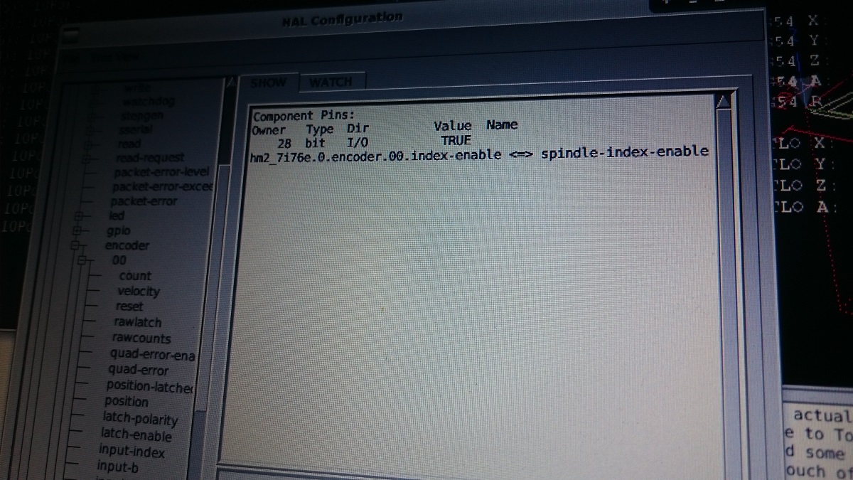

24 Aug 2017 10:44 - 24 Aug 2017 11:38 #97967 by tecno
At last I´ve found it. How-come the wording/digit indication is different ??
Encoder 00 in LCNC and 0 in pncconf, not easy to follow what is what here.
So now I have done setting up spindle encoder but still NoGo.
File Attachment:
File Name: combimill_...8-24.hal
File Size:16 KB
sets spindle-encoder-enable true
Rotating encoder = nothing
shorting pin 13 to GND = nothing
Input-Index in hal show goes low when shorting
Why does it have to be so that pncconf overwrites previous settings = a lot of unnecessary editing!
Last edit: 24 Aug 2017 11:38 by tecno. Reason: added text
24 Aug 2017 12:38 #97968 by PCW
if the index signal (7i76e.0.encoder.00.input-index) is
working and 7i76e.0.encoder.00.index-enable gets set
I dont see any possible way 7i76e.0.encoder.00.index-enable
is not cleared by index

24 Aug 2017 12:45 #97969 by tecno
Stays true turning encoder or shorting pin 13 to GND
24 Aug 2017 12:54 - 24 Aug 2017 12:57 #97970 by PCW
I would expect that to stay true (or false)
show is not dynamic (it only samples the pin/signal when you select it)
You must use watch to look at dynamic signals
Last edit: 24 Aug 2017 12:57 by PCW.

24 Aug 2017 13:37 #97971 by tecno
Did a power down and up and now xxxx encoder.00.input-index is low not high. WTF?

25 Aug 2017 04:38 #97985 by tecno
I hope that the board in my milling machine is OK and only suffering from faulty setup.
All is well when correctly setup. 7i76e.0.encoder.00.index-enable is cleared by index.
