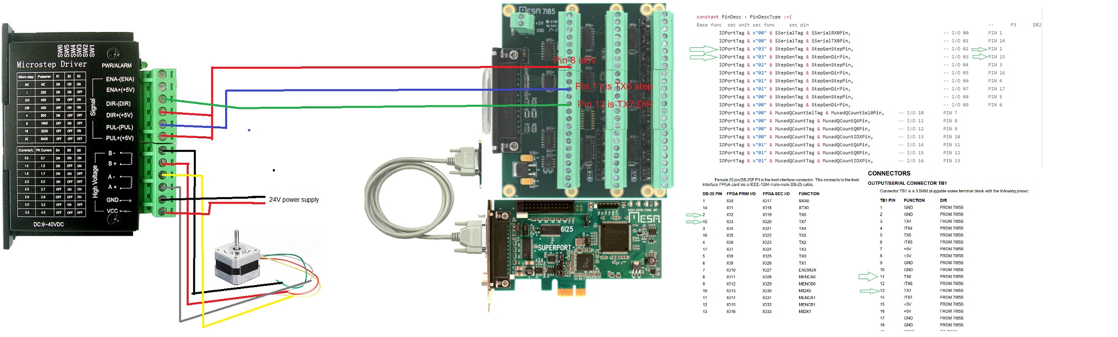

They are differential (and isolated) outputs so your logic analyser needs to go on TX and /TX or you are unlikely to see anything.
Replied by andypugh on topic 6i25 (5i25) + 7i85s + 7i85s PNCconf problems and questions
What is /tx? is that inverted. or is tx pul+ and /tx pul- or what does it mean.

Replied by PCW on topic 6i25 (5i25) + 7i85s + 7i85s PNCconf problems and questions
The 7I85S outputs are differential but they are not isolated
Are you sure you don't have P2 and P3 swapped?
Stepgens 0..3 are on P3 = 7I85S TX0 through TX7
Also that seems like a confusing axis connection
Why would you not assign stepgens in the natural order:
X = Stepgen 0 = TX0,TX1
Y = Stepgen 1 = TX2,TX3
Z = Stepgen 2 = TX4,TX5

Replied by Marcodi on topic 6i25 (5i25) + 7i85s + 7i85s PNCconf problems and questions
That's a good question. Because the first drop-down menu I choose X than Y than Z and that leads to Tx6 and 7. But I will change that. Makes more sense indeed.
How about my schematic for connecting the driver is that looking ok?

Hereby my .hal and .ini files.
The current connection in my schematic isn't doing anything when i test axis or run the program. But if i look to the created hal and ini file, i am not so surprised. It just seems to me, that this 5i25 card has no idea to where to send the signal to the 7i85s.
Could someone check it out who knows what the hal file should look like. As for the moment i am stuck, nothing moves and no signals whatsoever on this TB6600 test driver.
thx
thx
