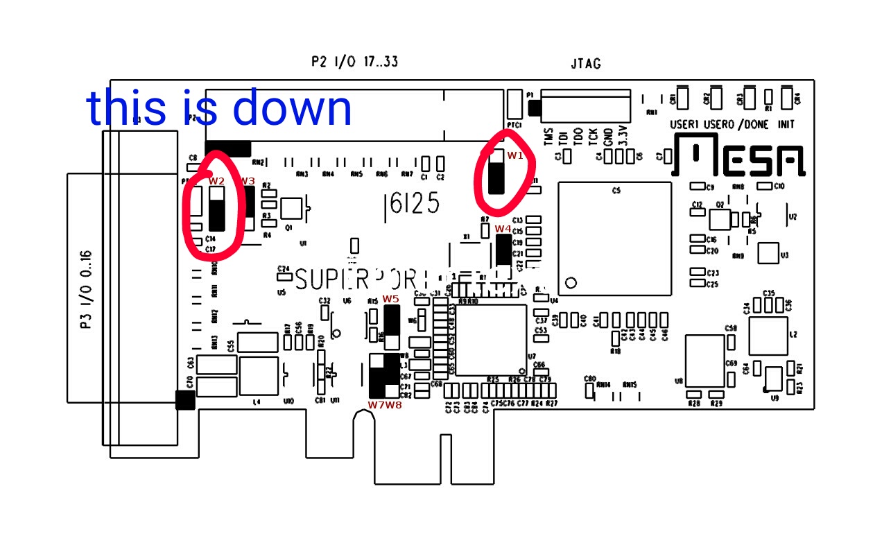

Also how is the 7I85S getting 5V power?
You must either
1. Setup the 6I25 to supply power to the 7I85S:
6I25 W2 UP (for P3 power)
6I25 W1 UP (for P2 power)
7I85S W3 UP (for 5V power from DB25 cable)
2. Setup the 7I85S for external power:
6I25 W2 DOWN (for P3)
6I25 W1 DOWN (for P2)
7I85S W3 DOWN (7I85S must have external 5V applied to P1)
You must either

12 Oct 2017 06:19 #100264
by Marcodi
Replied by Marcodi on topic 6i25 (5i25) + 7i85s + 7i85s PNCconf problems and questions
Most stupid question... Up means if I look at the orientation in the manual that the jumper is towards the top?
If so than they should be correctly.

12 Oct 2017 06:29 #100265
Replied by andypugh on topic 6i25 (5i25) + 7i85s + 7i85s PNCconf problems and questions
"Up" means "when held so that the writing on the screen-print is conventionally oriented"

12 Oct 2017 06:39 #100266
by Marcodi
I am really sorry, that's plain chinese Andy. "Conventionally oriented"
sorry man this one I do not understand. Maybe that's why it doesn't work. Would you have an example or picture what up means in a conventional oriented way.
I must seem like an idiot here, but seriously as a noob that phrase is ultimately demotivating

12 Oct 2017 06:42 - 12 Oct 2017 06:44 #100267
by Ozzyrob
When the screen print is right way up.
It might help to post a picture of YOUR board so that it the orientation of the jumpers can easily be seen.
Replied by Ozzyrob on topic 6i25 (5i25) + 7i85s + 7i85s PNCconf problems and questions
Last edit: 12 Oct 2017 06:44 by Ozzyrob.

12 Oct 2017 06:59 #100268
by Marcodi

12 Oct 2017 07:04 #100269
by Ozzyrob
Is that the way YOUR board is set.
Read the 6i25 manual and you'll understand what the jumper settings mean. Unless you are supplying the daughter board with power via the screw terminals the power must come from the 6i25

12 Oct 2017 07:09 - 12 Oct 2017 07:12 #100270
by Marcodi
Yes, my board is set wrong... Although I read through the manual 3 times by now. I interpreted breakout board disabled as power doesn't need to be provided externally. Just the opposite way it seems. God I feel stupid.
Well let me try some more first this weekend. See if it works than, now I have to go for my job abroad for 3 days. Wish I didn't, I want to keep working on my motors.
The 7i85s is set default to up to take power from the db25cable. And so my assumption that the 6i25 was defaulted aswell to provide power to break out Board. A stupid error on my part so it seems.
