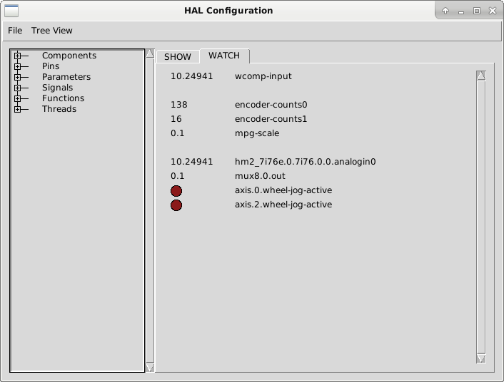

I have now been testing this MPG setup but I get no axis moving. Wcomp + Mux8 works OK.
Enclosed a screendump + hal
Cheers
Bengt
Cheers
Bengt

24 Feb 2018 13:58 #106441
Replied by rodw on topic Time to setup my lathe with 7i76e
It appears you are missing an axis-enable signal.
My hardware has an Axis select so I have this
but in your case as you have both jog wheels active at any time, you probably just need to set these with setp
net axis-select-x => axis.x.jog-enable
net axis-select-y => axis.y.jog-enable
net axis-select-z => axis.z.jog-enablebut in your case as you have both jog wheels active at any time, you probably just need to set these with setp

24 Feb 2018 14:09 #106443
by Mike_Eitel
Replied by Mike_Eitel on topic Time to setup my lathe with 7i76e
Axis and /or joint too ?
I have both connected
Mike
Mike
