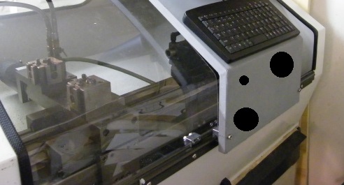

This is how I envision the MPG wheels on my lathe.
Z down left and X up right. Rotary switch Off - On (power to MPG's) - X 0.01 - X 0.1 - X 1 = 4 switch steps
CAT6 cable pre wired to front = Z A/B + X A/B = 4 leads 5VDC = 2 leads leaves me with 2 wires for switch position = 3 resistor values!
Have also been thinking of adding X 0.05 and X 0.5 = 6 switch steps possibly even X 2 = 7 steps
So this way only 1 analog input is used, how to solve this in HAL?
Is there a way to disable these 2 MPG's when code is running if forgotten to switch Off ?
Cheers
Bengt

There should be no need to worry. Jogging (using an MPG is still jogging) is disabled when Linuxcnc is running code in Auto mode or in while in MDI mode.

I have some 1-pole 12-way (restricted to 8) switches that I will use as in PDF.
PCW did say that 5K would be optimal for Analog input so I hope above values are OK.

It think you are setting yourself up for problems.
Read the 7i76e manual again.
The analog inputs have a full scale range of 36.3 volts. Using a 5 volt input is going to limit the resolution to 141 discrete levels out of a possible 1024 (eg 13% of the full scale range) and then you want to split that into 8 ranges....... so it would be easy to get a false reading.
I would use your field power (are you using 24 volts?). This will already be grounded on the 7i76e so the connections will be different.
Connect the 7i76e input to where you show GND and connect the other side (currently going to the input pin) to field power.
Assuming your field power is 24 volts, that will give you 66% of the full scale range so 677 discrete steps to split 8 ways.

The only other feedback I can give after using the 7i76e MPG's is that I doubt you need so many ranges but hey, you might as well add the resistors and then decide.
I am just using 1.0, 0.1 and 0.01 mm jogging and its very quick to touch off the z axis by jogging down until my float switch triggers, then jogging up until it goes out. You should check that you have enough resolution in your motors before trying to set up micron accuracy (0.001mm)
