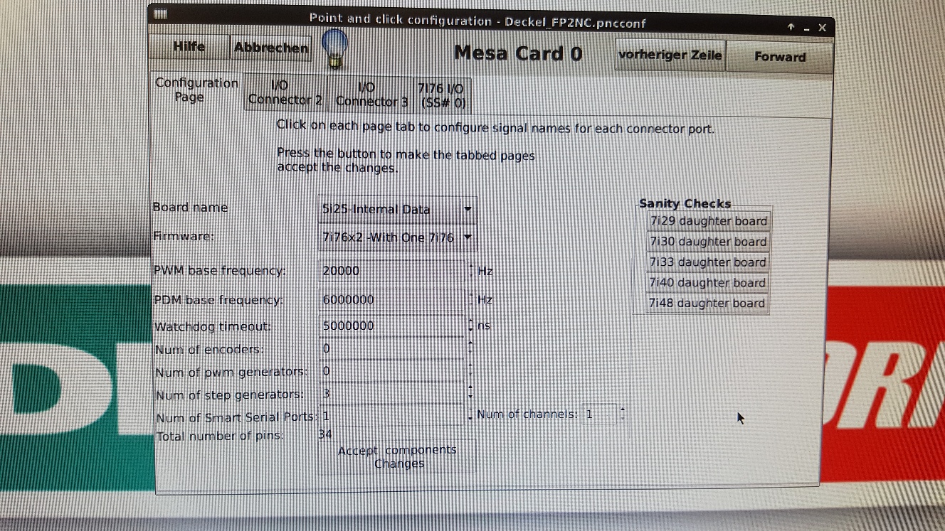

I still work on setting up my Deckel FP2NC with LinuxCNC. The configuration with the 5i25 and the 7i76 works fine so far. The motors move correctly.

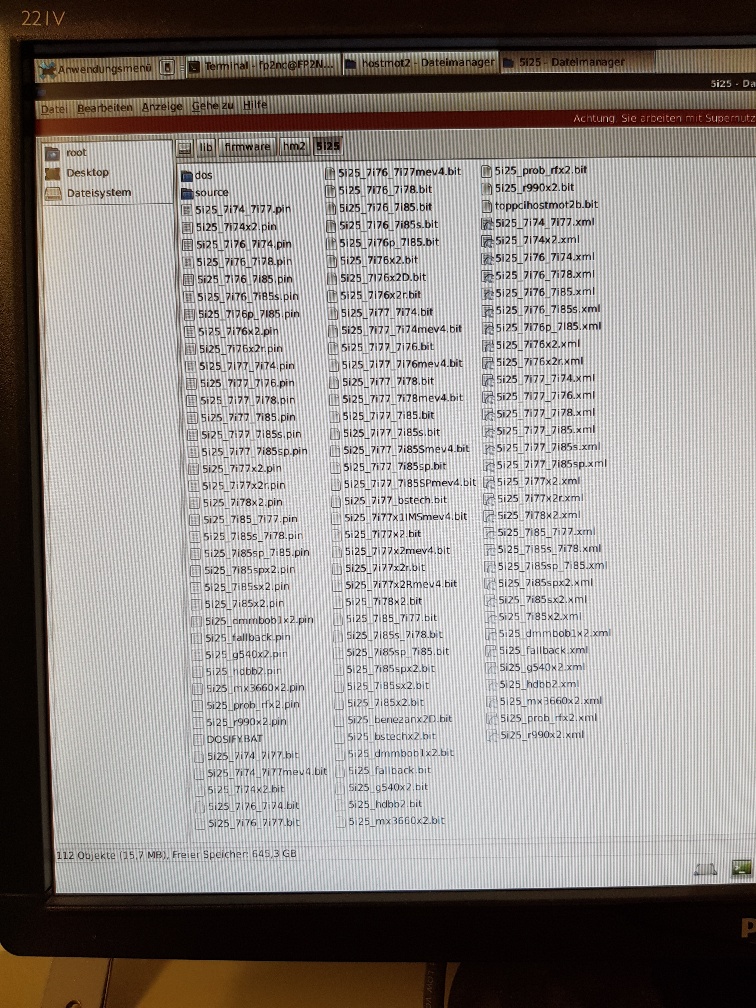

Now I tried to add the linear scales (Heidenhain with EXE, TTL signals) to the configuration. I bought a 7i85 MESA card and connected it to P2 on the 5i25. I flashed the EEPROM with the matching bitfile (sudo mesaflash --device 5i25 --write 5i25_7i76_7i85) which I downloaded form the manufacturer´s website. The PINs readout looks OK to me.
After that I added the required files to the folder "lib\Firmware\hm2\5i25.

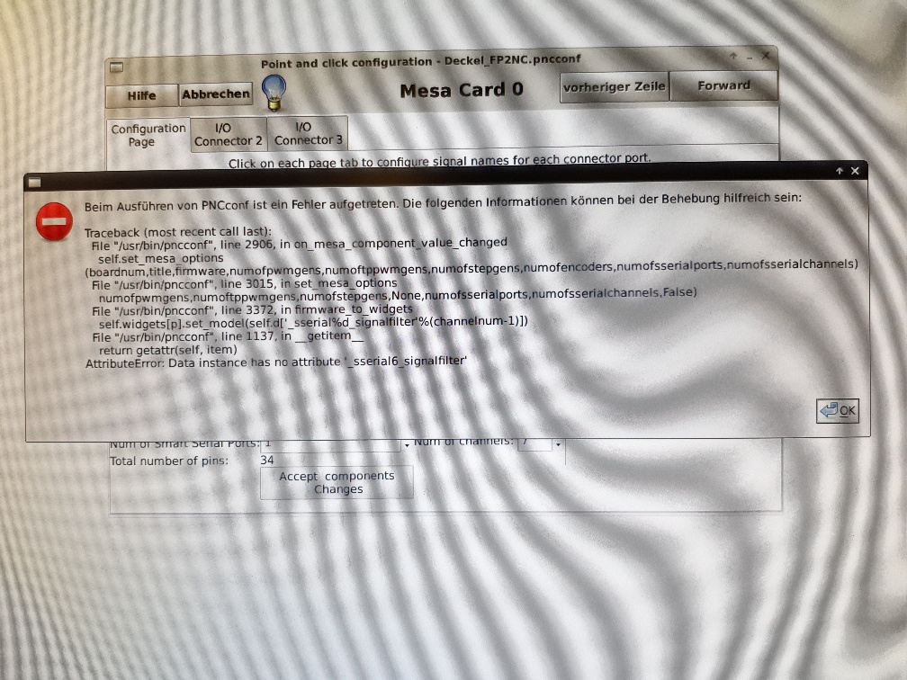

After starting pncconf I tried to choose my configuration and click on "Accept components Changes". I get an error message. I guess the 7i85 is not supported so far in PnCConf.
Does anyone have a suggestion how I can configure my setup using PnCConf? Thanks a lot in advance...

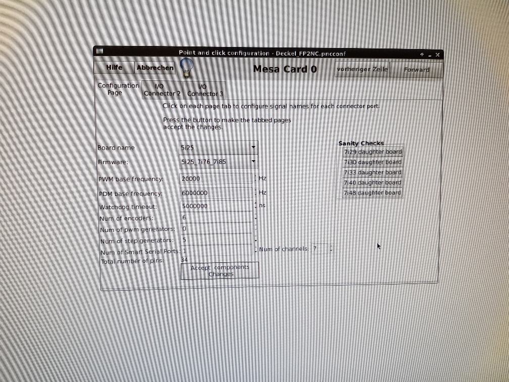

Hi everyone,
I read a lot of threads dealing with the 7i85 and PnCConf in the last days. It seems to be not as simple as I thought... I there a way to add the tab for the 7i85 Pins manually?
So far I have the 7i76 working fine.
My intention was to add the glass scales für 3 axis by connecting the Heidenhain EXE to the 5i85. Im sure someone already had the same idea...
Best regards, Jan

18 Feb 2018 23:38 #106162
Replied by cmorley on topic PnCConf with MESA 5i25 + 7i76 + 7i85
Pncconf does not cover the 7i85 at this time.
It's beyond adding by hand
I would get the configure running without encoders first then (probably with help here) add the encode code manually.
Sorry hopefully in the future I will add the 7i85 to pncconf

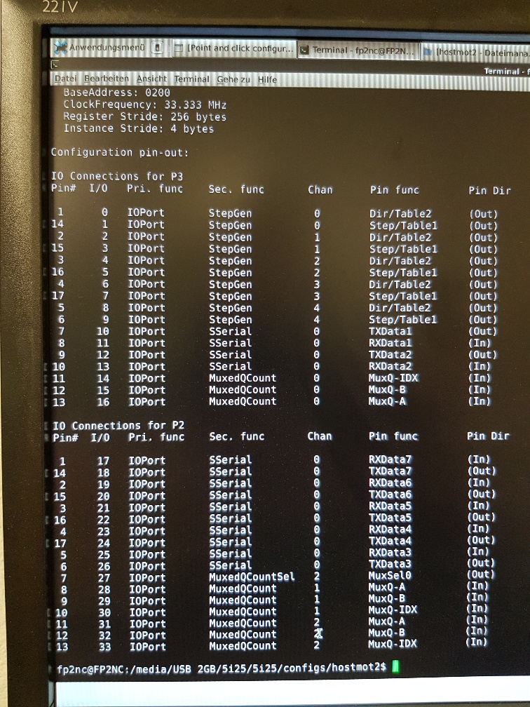

Which data do you need exactly? The pin readout from mesaflash is what I postet in the first picture. I though the sserial pinout depends on the kind of extension card to be connected...
Jan
that is exactly what I am going to to. I reflashed the 5i25 to the 7i76x2 firmware and get my machine running so far. When everything works fine, I´ll try to add the linear encoders.

Replied by PCW on topic PnCConf with MESA 5i25 + 7i76 + 7i85
There really are no hal pins from the 7I85 card since its a passive device (4 encoders +5 RS-422 interfaces)
(depending on host firmware, It can support up to 5 sserial devices on the RS-422 interfaces which will of course create hal pins )
Of course you can list the sserial device pins with
halcmd show pin *7i84*
for example (once the required drivers are loaded)
The 7I85 does not add any pin names, its just a passive device, only sserial devices
add additional pins names ( like the 7I84 I mentioned above )
