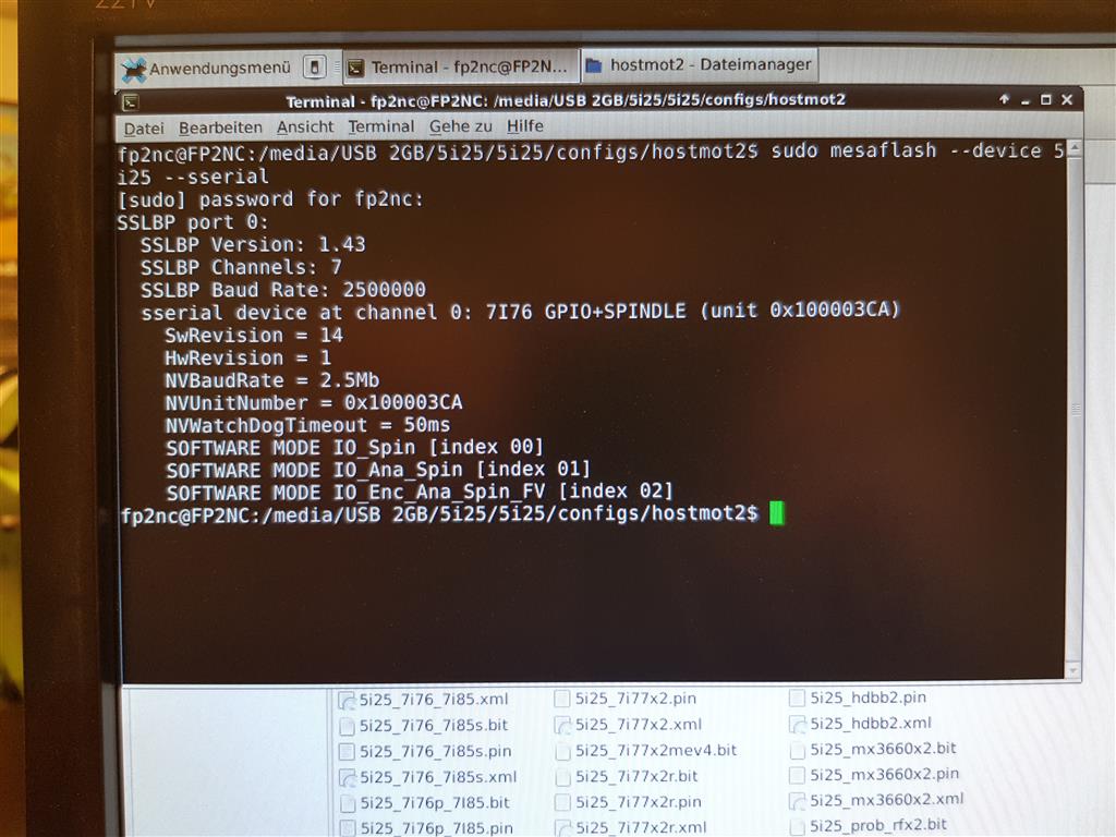

15 Mar 2018 11:11 #107377
by Jan Weber
Replied by Jan Weber on topic PnCConf with MESA 5i25 + 7i76 + 7i85
Hi Chris,
I took a photo of my screen after the --sserial command. The 7i76 connected to P3 is shown, but the 7i85 (P2) isn´t. Is that because of it is a passive device? The Firmware of the 5i25 is flashed to 5i25_7i76_7i85.bit. I tried it the way Andy described. I told pncconf that only one 7i76 is connected and at least the axes move fine. Next step will be to connect the EXE boxes and analyze the data taken with the HAL scope.
Jan
Jan
- Posts: 19908
- Thank you received: 4658
15 Mar 2018 11:13 #107378
Replied by andypugh on topic PnCConf with MESA 5i25 + 7i76 + 7i85
Yes, the 7i85 is passive so won't show. The IO and encoders (etc) will all show up as 5i25 pins.
