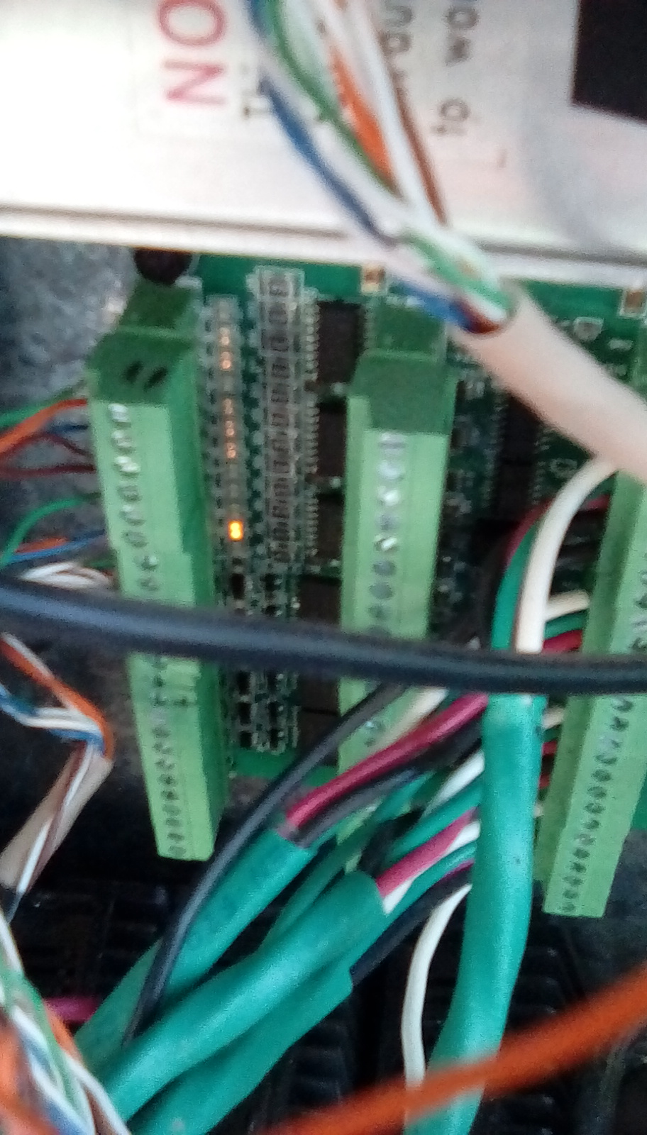

Got it. I'm getting the "limit on error" again and it resolves after removing the "_not" and halshow still isn't showing the limits trip.
Just to confirm, my x-min-home is "hm2_7i96.0.gpio.000.in"

Do the 7I96 input LEDs illuminate?
If not, you likely have a wiring error
(is input common connected to your power supply common?)

LED's are not illuminated so it is my wiring. Am I supposed to run a wire from my PSU ground to the TB3 common (pin12)? I'm going to check out the manual again.

07 Nov 2018 17:02 #120218
by snugglylovemuffin
Replied by snugglylovemuffin on topic Mesa 7i96 and LinuxCNC 2.8 PnCConf
I have rewired my TB3 header and now have lit up almost all of the LED's on the isolated inputs. I also changed my limit switches in HAL to reflect the proper GPIO pin# (0-5).
I grounded off the common pin(11) to my PSU ground, with +24v into the limit switches. I've attached a picture of the pin LEDs, the bright ones are to my relay, the rest are faint (some unlit are to my THC) and one is not lit up at all. Weird. I'm going to see if I can remedy this with wiring.
HOWEVER, I pulled up halshow and halscope and I was not able to actuate any of my limit switches... I'm completely at a loss as to why that is. I'm currently swapping from 10 to linux because my network card doesn't like linux. I'll grab my newest HAL/INI and post them here for you to check out.
- Posts: 18122
- Thank you received: 5337
07 Nov 2018 17:47 #120224
Replied by PCW on topic Mesa 7i96 and LinuxCNC 2.8 PnCConf
Looks like you have pairs of LEDs lit,
This means you are just looking at AC noise.
Perhaps you don't really have the 24V common connected to the 7I96 input common, (pin 12) just frame ground or something similar.
If you have a voltmeter you should be able to read 24V from the 7I96 input to the input common pin, (when your limit switches are on) if not, there's still a wiring error.

You know what I did, I grounded my bus bar to my power supply, my mistake. How about my relay, is that working proper or is that not working properly either?
