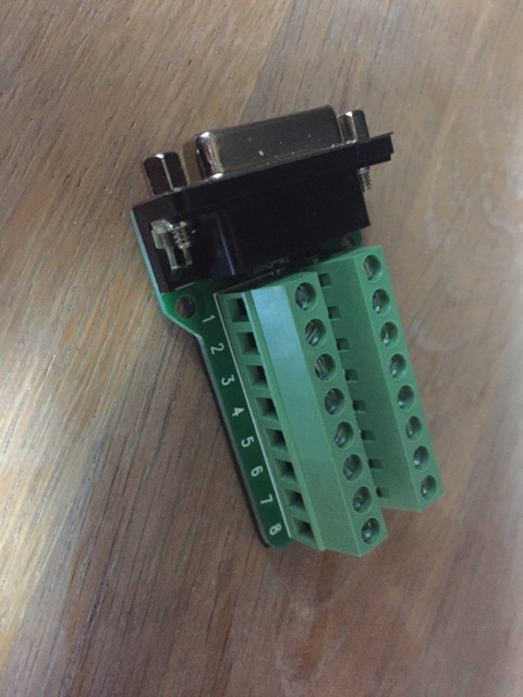

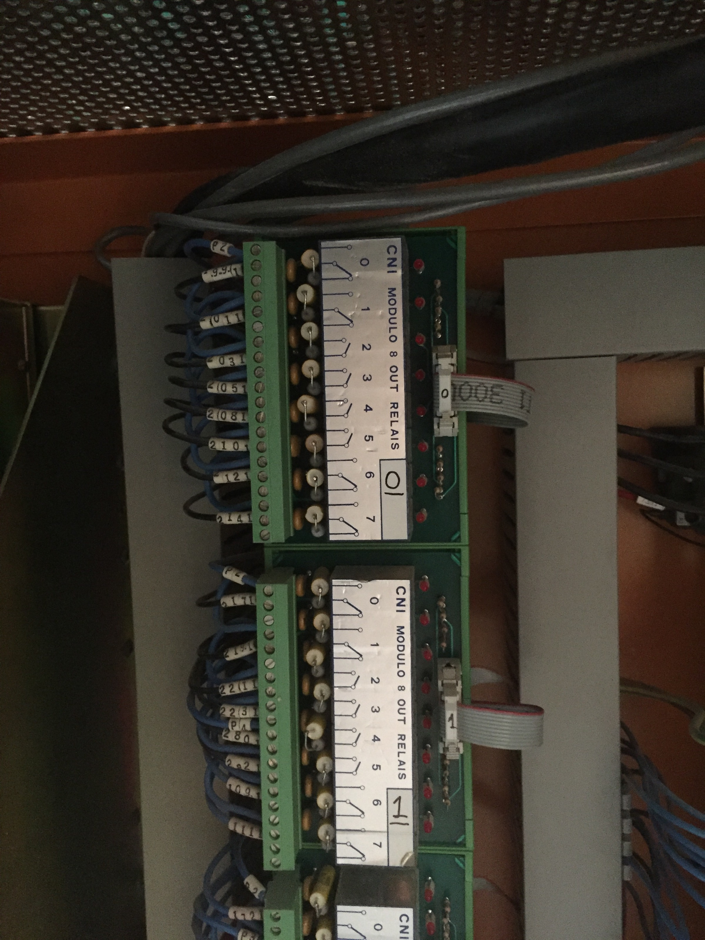

All the wiring (IO, encoders, .. ) to the current controller is done via SUB-D connectors.
I've buyed a couple of these. This way I don't have to cut the connectors.
And I was aware of the E-stop loop. I will connect these to the Mesa.
Same for all the other IO's. The outputs are all connected via relaiscards, and the inputs via optocouplers. (see picture) to the controller.
That will make the job easier.
