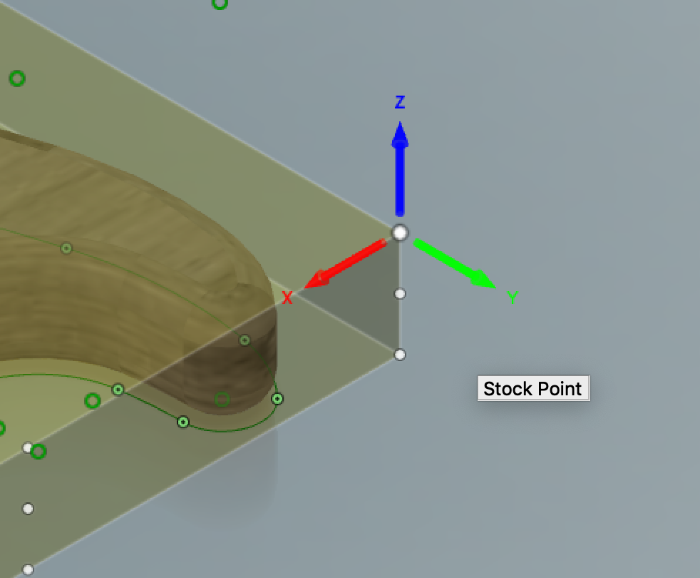

But I have another question. I don't have much experience, so my question can be stupid. But anyway
My machine is a Biesse Rover. This machine has retractable stops to align the material. The stops I want to use is on the left and at the rear.
But now I see that LinuxCNC has a different WCS system.
Maybe I don't use the right words, but I mean that I'm not able to set the correct WCS in Fusion 360 (and linuxcnc) . If I align the material to the rear left corner, this means that the +Y-axis direction should point to the front of the machine.
The +X-direction to the right, and the +Z-axis upwards.
Can I solve this?

19 Jun 2019 19:28 #137321
by bevins
Replied by bevins on topic Test LinuxCNC without motors and encoders connected
Your machine homes back left probably. Most Biesse does.
In Fusion360 you have to change your WCS to match when you do your cam.

19 Jun 2019 19:36 #137322
by Peterdeleu
Replied by Peterdeleu on topic Test LinuxCNC without motors and encoders connected
Indeed, home is left back.
I've spend hours to find a solution, but it looks like the WCS is fixed. The only thing that you can do is change the origin and turn it around. Changing the direction of only 1 axis is impossible.
In the screen capture included in this message is the origin correct, also the X and Z axis, but I want to point the Y to the other site.
If I do so, the X turns the other way...

19 Jun 2019 19:50 #137323
by HueyHQ
Replied by HueyHQ on topic Test LinuxCNC without motors and encoders connected
My Busellato is similar.
I've re-configured my machine axes so that Y-axis runs from the back stops (home) and negative towards the front (originally, that was positive direction like yours). Also did the same for the Z-axis for best CAM-compatibility, but it sounds like the Biesse is opposite?
I don't use Fusion360 (yet) so can't help set your WCS, but in the package I use, the WCS is in the top-left corner and I model in the X+/Y- quadrant.

19 Jun 2019 20:00 - 19 Jun 2019 20:02 #137326
by bevins
That looks wrong to me. Facing my biesse, left to right X asix back to front Y axis. My machine homes back left.
I just tried fusion360 and I can get it correctly. You should be able to also. I dont like how fusion360 does their WCS as it is a bit tough to get it right.
Wait...... if your Y is pointing to the back of the machine then I think that is correct.

19 Jun 2019 20:10 #137329
by Peterdeleu
In fusion, my Y is pointing backwards yes, but is this correct? Shouldn’t it point forwards? This is the + directiion of the biesse.
- bevins
- Posts: 1947
- Thank you received: 338
19 Jun 2019 20:29 #137332
by bevins
Thats correct.
Thats correct.
