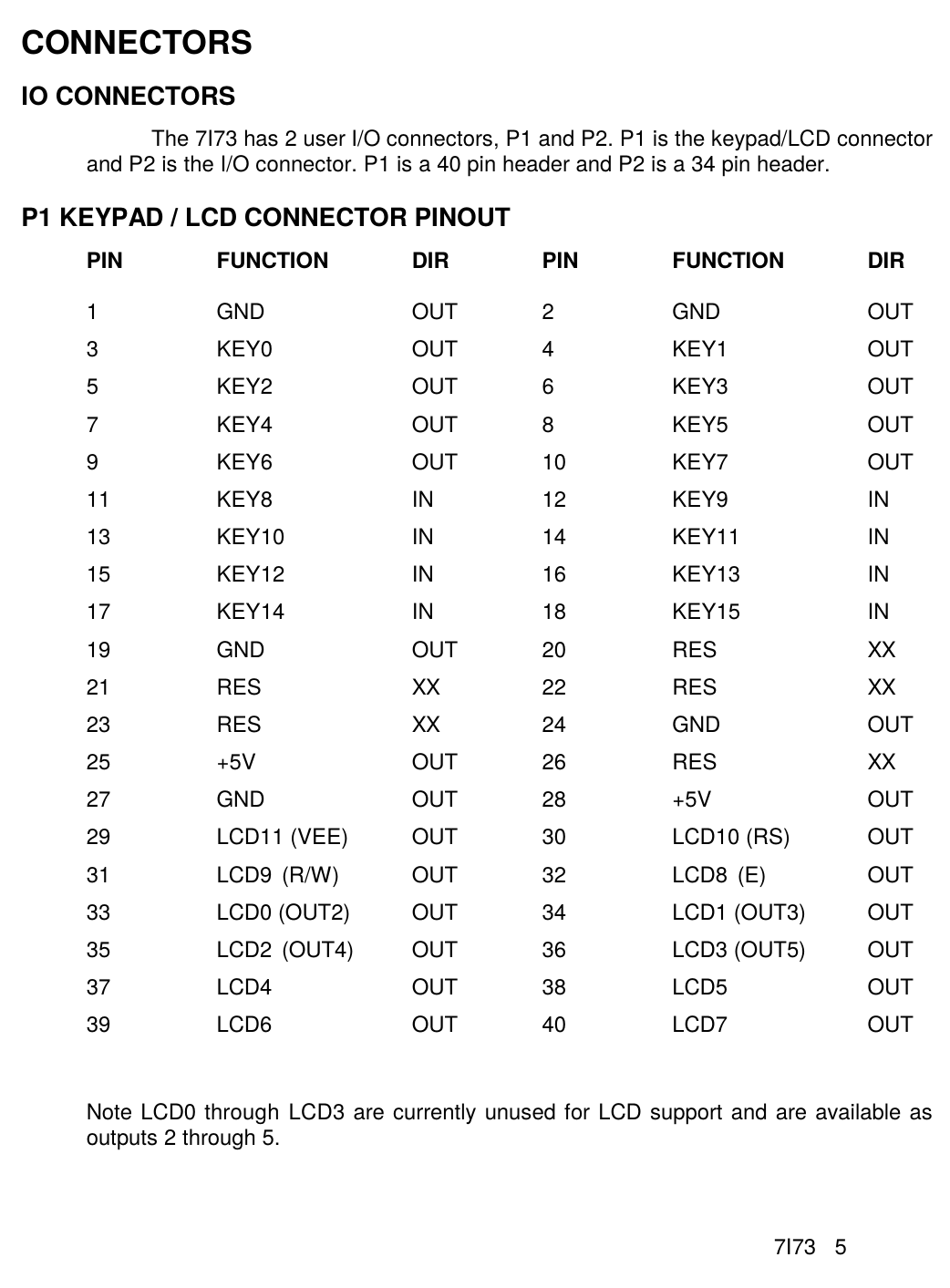

The 7I73 does not have ports, OUT2 is on P1 pin 33 (manual page 5)

Page 5:
and page 7
I don't see any information, that the connectors are the same port?!?

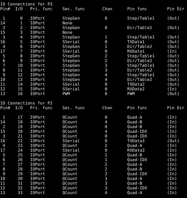

Output from mesaflash looks like this:
So I have TXData1/RXData1, TXData2/RXData2 and TXData3/RXData3
are the postfix number of the pins [SPort] or [SChan]?

On the FPGA pinout list , the sserial "Chan" field is the port (all 0 here)
and the RX/TX pin suffix is the sserial channel

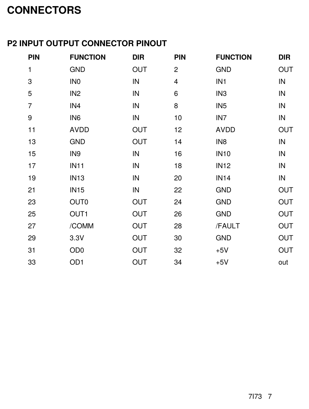

So to use the Pin10 of the second connector of the third 7i73 the pin-notation would be
hm2_5i25.0.7i73.0.2.input-15
right?

No, that would be input-07 (7I73 manual page 7)
