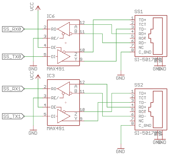

06 Dec 2019 04:15 #152139 by andypugh
Replied by andypugh on topic 5i25 + 7i73
It doesn't appear to have found the 7i73. How is the 7i73 connected to the 5i25?

06 Dec 2019 05:53 #152145 by Reinhard
Replied by Reinhard on topic 5i25 + 7i73
I build a BOB with this group:
How does it fail?
error is something like "glade not found" - and I installed all glade related libs already
06 Dec 2019 06:06 #152147 by andypugh
Is the 7i73 powered? I guess that your BoB does not power it through the CAT5 cable?
(And if the 7i73 is powered from a separate 5V, is it jumpered for that)
06 Dec 2019 06:15 #152149 by Reinhard
OUPS - my fault.
Sorry! didn't think about that :(
