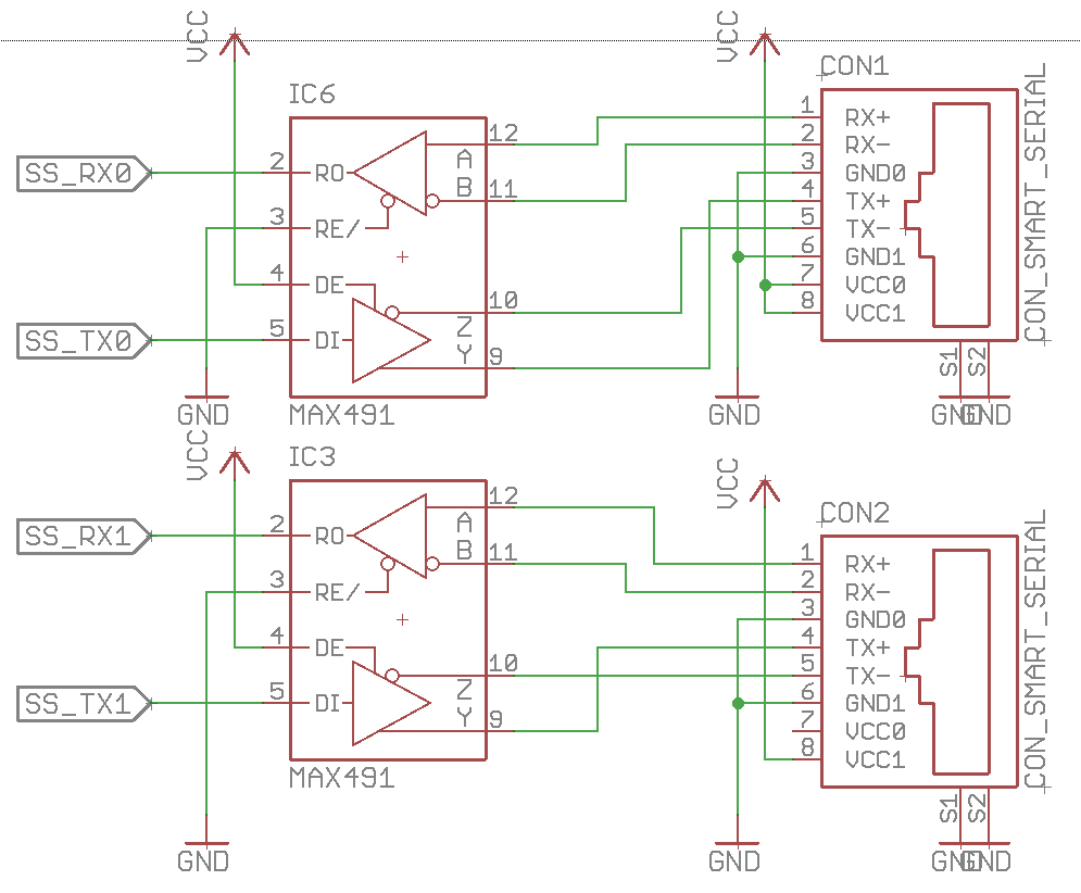

07 Dec 2019 09:27 #152260 by Reinhard
Replied by Reinhard on topic 5i25 + 7i73
Powering the 7i73 did not change anything (a red led shines after powering on, so I think I did that right) - no reaction on "show pin".
I tried standard patch cable, as well as crosslink cable - as I don't know, whether I connected the signals on my bob right.
As no test succeeded, I disconnected the 7i73 and connected an oscilloscope instead.
I thought, on issuing the show pin command, I should see some spikes on the smart serial lines - but there was no rumor at all ...
... and as I don't know the right command syntax, I tried "show pin 7i73" as well as "show pin hm2_7i73" according to the fact that "show pin hm2_5i25" shows some output for the main card.
I don't know, how to continue. Any help is very appreciated.
07 Dec 2019 09:55 - 07 Dec 2019 09:57 #152264 by PCW
Replied by PCW on topic 5i25 + 7i73
Probably a pinout issue
(Also that looks like a jack with an Ethernet transformer, if so that will not work)
freeby.mesanet.com/7i74sch.zip
might help
There would be no hm2_7i73 pins but
halcmd show all | grep 7i73
should show all 7i73 pins/parameters

07 Dec 2019 10:20 - 07 Dec 2019 10:43 #152265 by Reinhard
Thank you for your attention!
Previously I overlooked the stars in the command, so I tried all variants again.
No change.
"halcmd show all" issues an error like "Unknown 'show' type 'all'
Am I right, that a show command should give some spikes on the oscilloscope connected to the smartserial lines?
Thanks for the link - I'll dive into it
How can I verify, that I got the wrong jack and which one will be appropriate?
by the way - I used this connector
Last edit: 07 Dec 2019 10:43 by Reinhard. Reason: added link to connector I used
07 Dec 2019 11:08 - 07 Dec 2019 11:09 #152267 by PCW
halcmd show all works for me: (I dont have a 7I73 here but do have another sserial card=7I69)
peter@pcw-HP-EliteDesk-800-G1-USDT:~/linuxcnc/configs$ halcmd show all | grep 7i69
26 bit OUT FALSE hm2_7i95.0.7i69.0.1.input-00
26 bit OUT TRUE hm2_7i95.0.7i69.0.1.input-00-not
26 bit OUT FALSE hm2_7i95.0.7i69.0.1.input-01
26 bit OUT TRUE hm2_7i95.0.7i69.0.1.input-01-not
26 bit OUT FALSE hm2_7i95.0.7i69.0.1.input-02
26 bit OUT TRUE hm2_7i95.0.7i69.0.1.input-02-not
That jack look OK but your schematic shows a CT pin which would only apply to
a jack with built in transformer, so its very likely you have the jack pinout wrong
(the pinout of the first channel of the 7I74 jack is correct for a single jack)
Last edit: 07 Dec 2019 11:09 by PCW.

07 Dec 2019 22:43 - 07 Dec 2019 22:43 #152312 by PCW
The pinout in your schematic is not correct for a plain RJ45
Use the pinout from the 7I74 schematic:
RJ45 PIN  FUNCTION
1         TXA NON-INVERTED TX
2         TXB INVERTED TX
3         RXA NON-INVERTED RX
4         GND
5         GND
6         RXB INVERTED RX
7         +5V
8         +5V
Last edit: 07 Dec 2019 22:43 by PCW.
07 Dec 2019 22:54 - 07 Dec 2019 22:56 #152313 by Reinhard
thank you for your support!
I just happened to discover the connector in your schematics and created a new symbol for eagle.
This is the new picture:
I forgot pin7 of second connector - will fix that right now.
Ah - I changed RX and TX, as I suppose, that my RX should connect to your TX - right?
Last edit: 07 Dec 2019 22:56 by Reinhard.
