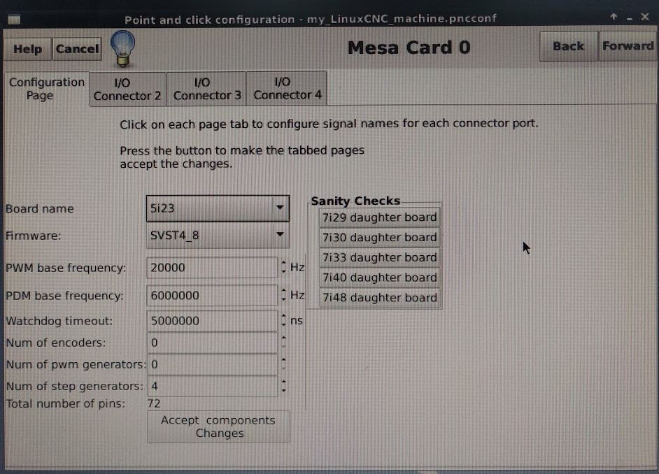

- terry1992
- Posts: 18
30 Oct 2019 06:53 #149117
by terry1992
Replied by terry1992 on topic How to add a new Mesa card to pncconf?
- Posts: 7368
- Thank you received: 2181
30 Oct 2019 07:10 #149118
Replied by cmorley on topic How to add a new Mesa card to pncconf?
are you using it with the parallel port ?
