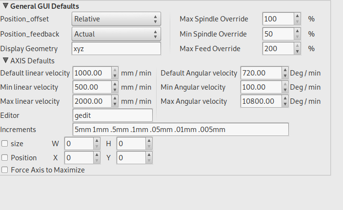

Thank you that is a relief,
I am new to plasma cnc my search showed that they have up to max velocity 9500mm/min so default should be 9000mm/min? I think
that makes it clear why mine is slow
with 33,3mm/s
I like to use the wizard and not already tweak by hand a default setup.

12 Mar 2020 03:37 #159854
Replied by cmorley on topic default and max velocity limited?
So I upped it to 20000.

- Posts: 7368
- Thank you received: 2182
12 Mar 2020 13:06 #159897
The file to change is screen.glade
it's in that src/emc/usr_intf/pncconf folder but must be installed in lib/python/pncconf folder
Chris
Chris

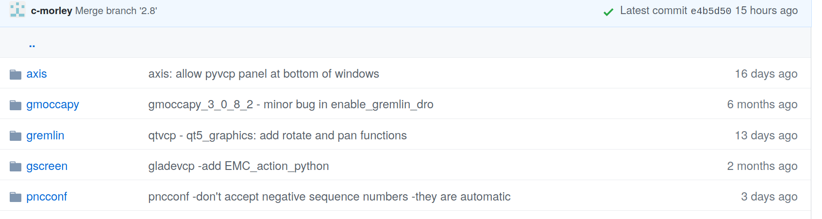

12 Mar 2020 13:51 - 12 Mar 2020 13:52 #159907
by CNCFred
Replied by CNCFred on topic default and max velocity limited?
Chris, pls. check previous post of me, (the picture)seems commit and push not done so far it seems!
still 3 days old.
can you tell me the calculation, I am not able to get this out of the linuxcnc documentation.
thank you...
still 3 days old.
thank you...

12 Mar 2020 14:09 #159912
Yes sorry it seems I forgot to push it to master
Here you go:
Here you go:
