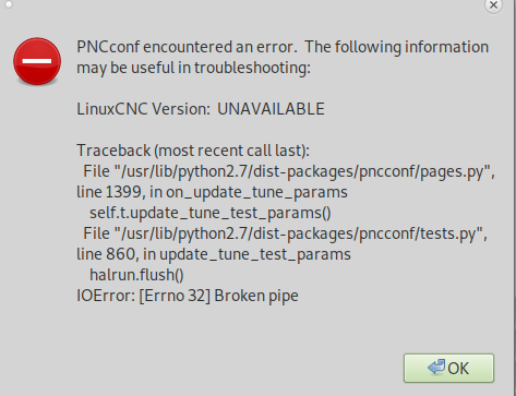

- CNCFred
- Posts: 219
- Thank you received: 43
12 Mar 2020 16:22 #159934
by CNCFred
Replied by CNCFred on topic default and max velocity limited?
replaced all of them worked!!
thx a lot!!
thx a lot!!

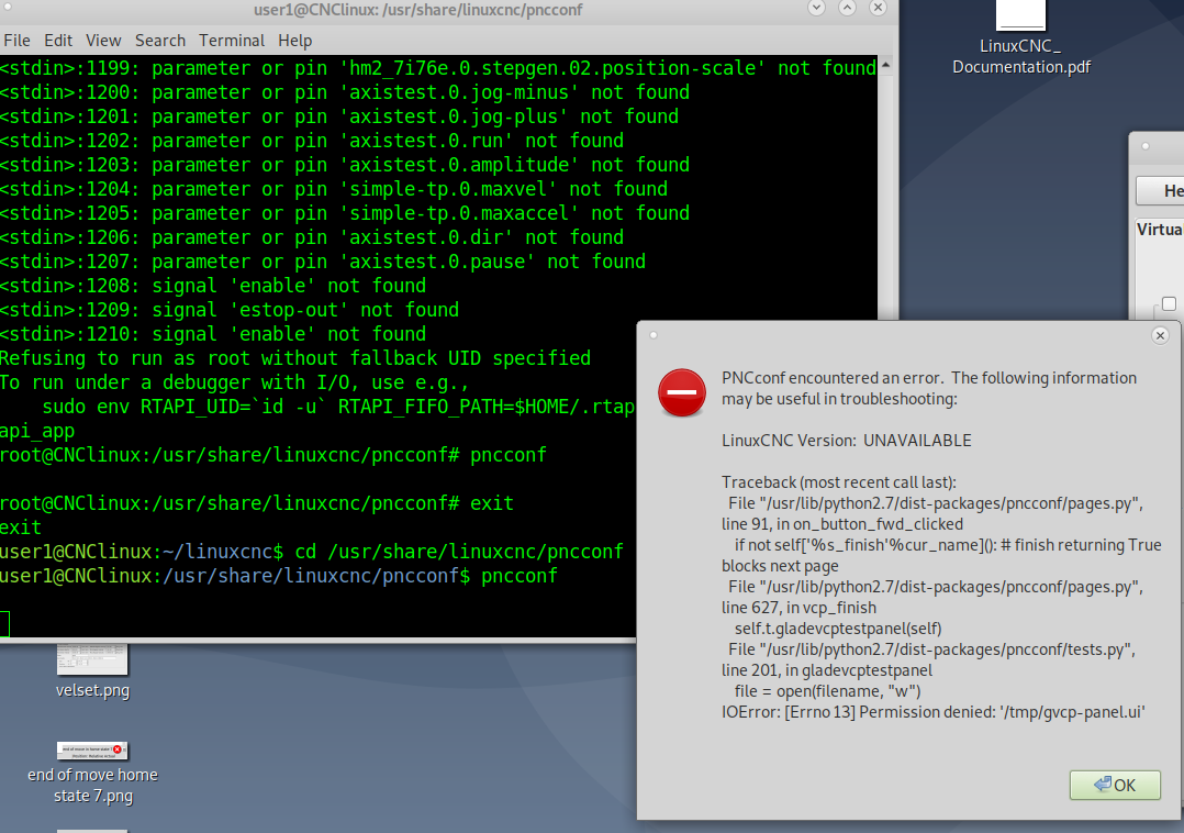

- CNCFred
- Posts: 219
12 Mar 2020 16:47 #159939
by CNCFred
- Posts: 7368
- Thank you received: 2182
12 Mar 2020 16:53 #159942
Replied by cmorley on topic default and max velocity limited?
Sorry that's not enough information to trouble shoot. If you run pncconf from the terminal it should give more info.
Chris
Chris
- CNCFred
- Posts: 219
13 Mar 2020 14:44 - 13 Mar 2020 15:44 #160072
by CNCFred
sorry, forget this request ....screen.glade must have been corrupted, downloaded new from github , and copied where it should belong...works!!
sorry again..
sorry again..
