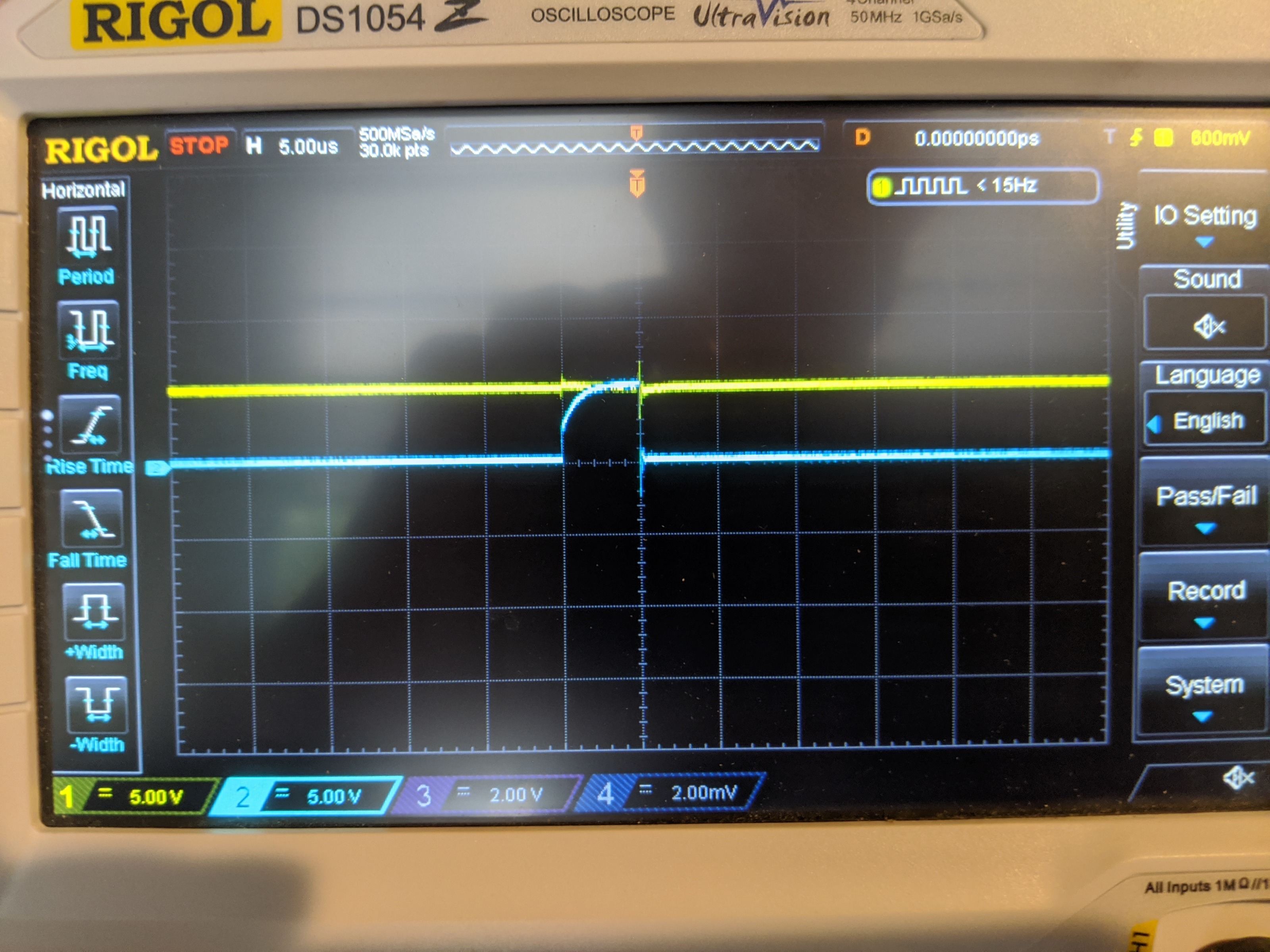

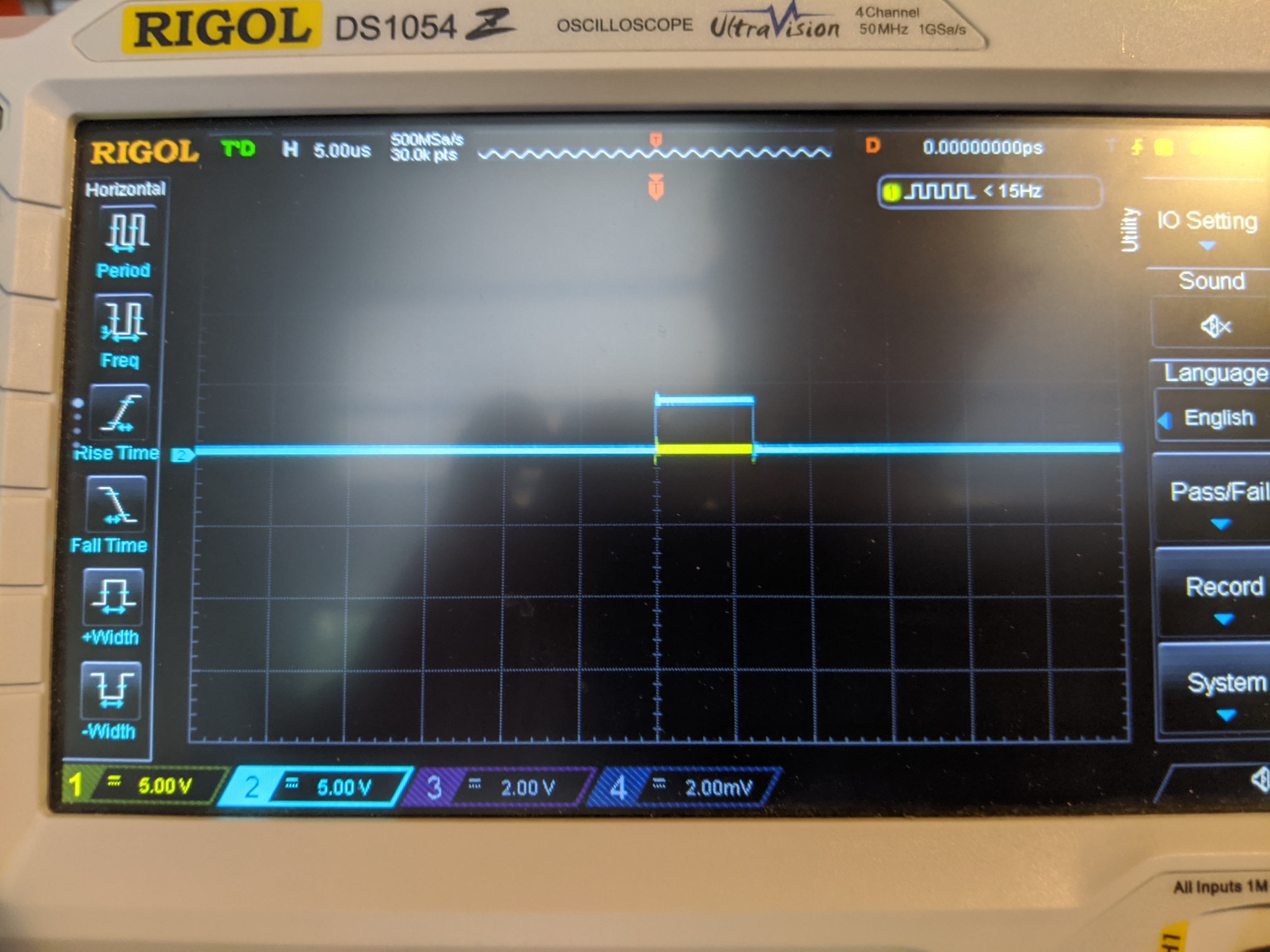

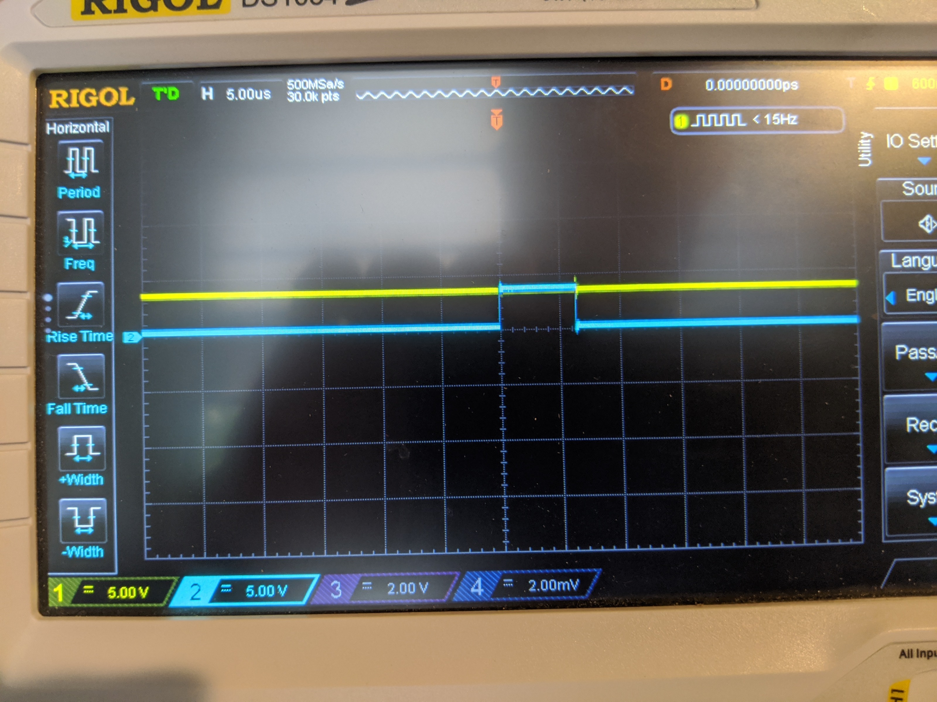

Ok, I changed the Serv thread period and the P values.
The step and direction signals look MUCH better, no strange behavior.
Alas, the machine still doesn't move.

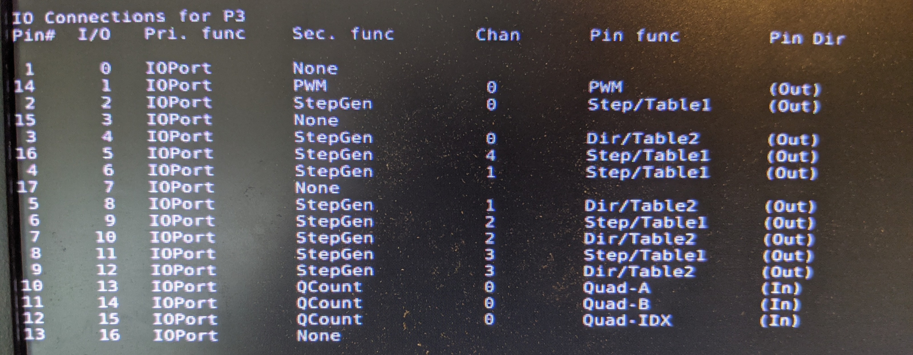

What does
mesaflash --device 5i25 --readhmid
say ?
say ?

07 Jul 2020 15:12 #173906
by naja452
Replied by naja452 on topic Stuck configuring 5i25 to run G540

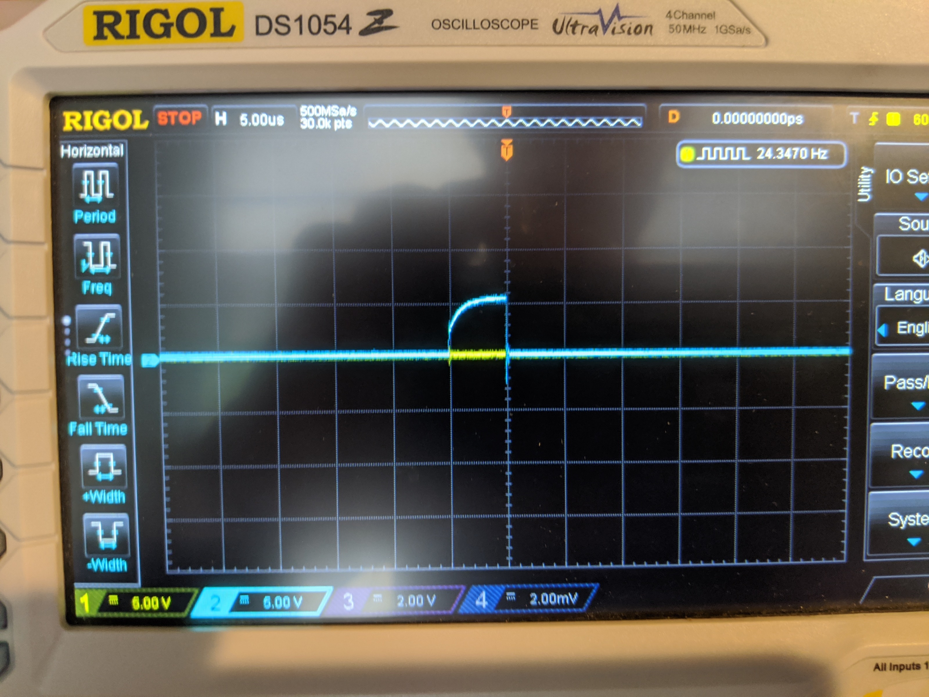

Replied by PCW on topic Stuck configuring 5i25 to run G540
It might be that the bus switch has been damaged (since you have a bad output)
and is loading its 4V power supply (that sets the pass-through voltage and is just a resistive voltage divider) so you are not getting enough high side drive to generate steps

I'm not a huge fan of that answer;) , but it's looking more and more like it might be the case
Do you know if P2 uses a different bus by chance? I ordered an adapter with the hope of reassigning everything to P2 for testing.
Checking the loaded output voltage would probably tell
P2 uses a different bus chip but it may use the same 4V (not sure)
If the G540 only outputs 3.3V signals you could set the I/O tolerance for
3.3V and then the bus interface chips are powered by 5V
(unfortunately the G540 manual has no output signal specs)

Scratch that, I found the W3 jumper on the 5i25 that does what you suggested, I'll try that.
EDIT: I just checked the G540 Rev8 manual, looks like the spec sheet says input is 3.3-5v.
Fingers crossed!
Fingers crossed!
