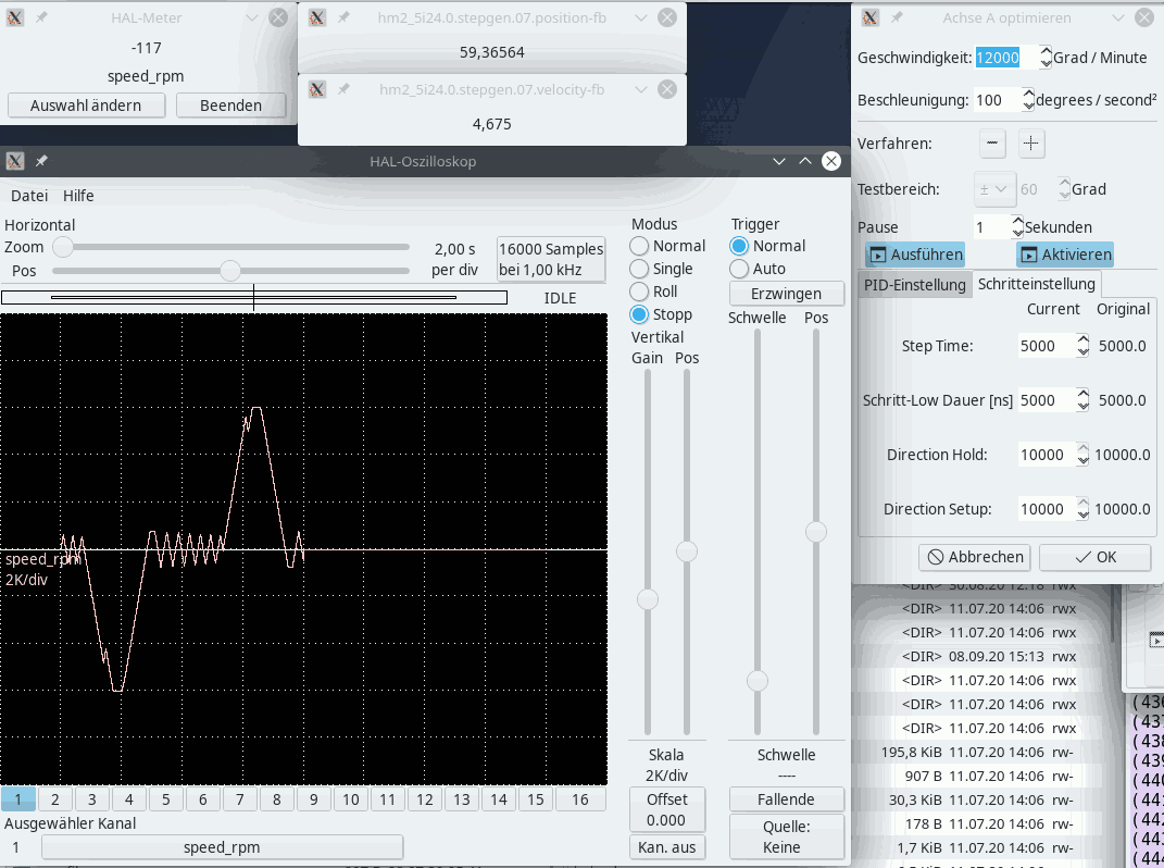

and the slow part of the test is this:
Anyway ...
its obvious to see, that Hal-Meter does not reflect the configured top-speed (beside the fact, that the value -6000 is anything but not speed rpm - right label would be something like degrees/minute).
"velocity-fb"- value of -100 will most probabely be mm/second.
None of the values is related to the topspeed of 12000 degree/minute.
by the way:
Hal oszilloscope is shown, but its impossible to select anything useful.
With an acceleration of 100 degrees/s² I was able to hear (and watch) the ramping.
Interestingly the acceleration is not steady/smooth - there is some break impuls during acceleration.
Opposed to that deceleration is steady/smooth.

12 Sep 2020 01:17 #181827 by Reinhard
Replied by Reinhard on topic tune stepper function
I was able to bring halscope into play :)
This is what I was talking about:
This speedcurve is right for stepper tuning. But it would be helpful, to get some recomendations about what to do or a rating about current settings.
This way I see the curve, I know, it should be different, but I don't know what to do or what parameters to change ...

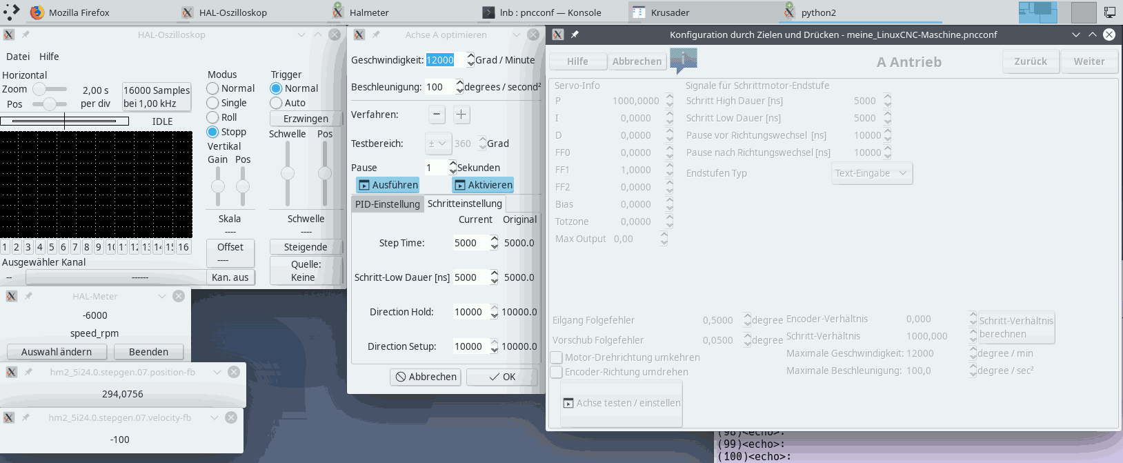

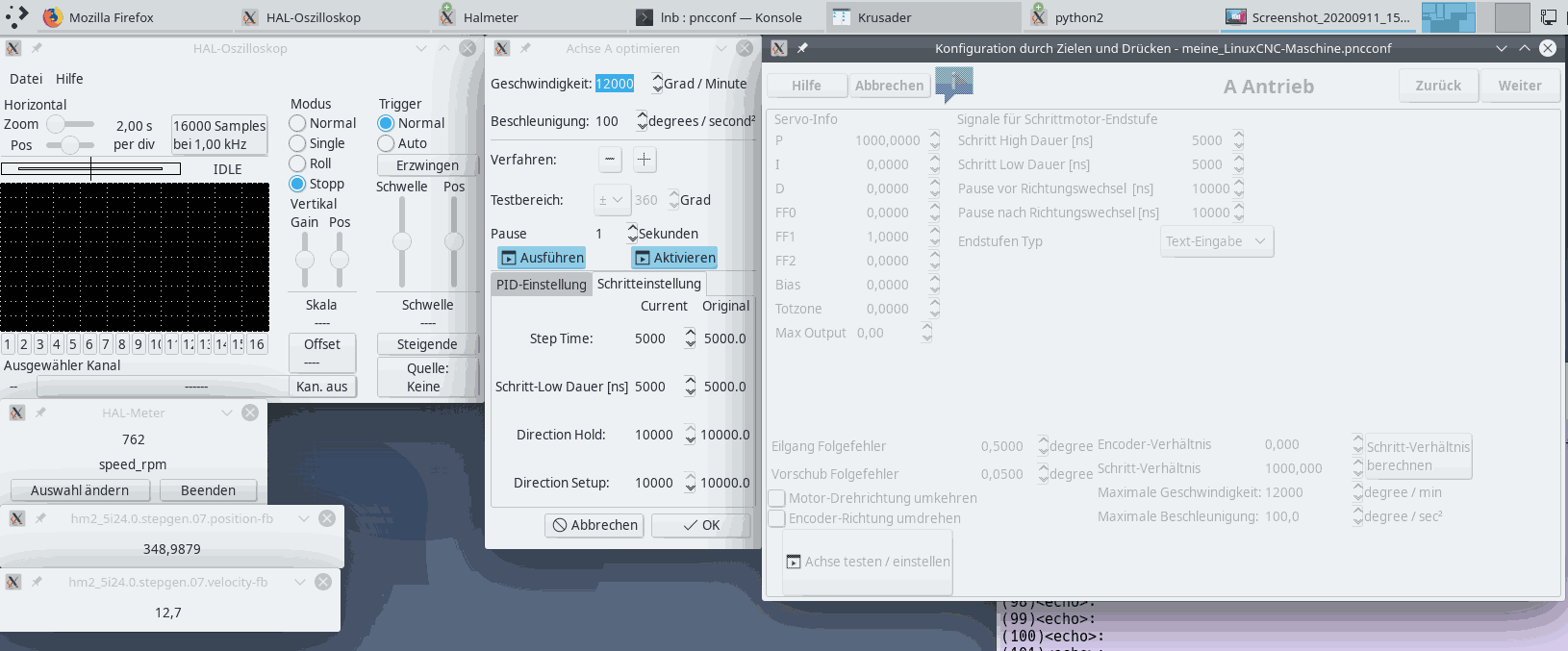

12 Sep 2020 08:39 #181882 by Reinhard
I did some more tests and it looks like speed reported by halmeter is correct.
That means, that someone acts as limiter.
I changed max speed from 12000 to 6000 and there was no difference in sound or scope curve.
When I reduced speed below 6000 sound and scope change output.
Then I started a halshow in parallel to pncconf. In halshow I selected to watch hm2_5i24.0.stepgen.07.velocity-cmd which showed the "real" speed, the motor should run. But due to the unknown limiter, that value does not reach hardware.
Real speed means, when I selected 12000 in testpanels combobox, velocity-cmd rised upon 211, which is bit higher than my expectations. Then I entered 15000 in combobox, but motor worked stil without problems.
If the driver would be fired with matching steprate to velocity of 15000, the driver would produce some errors, as that speed is out of specs.
