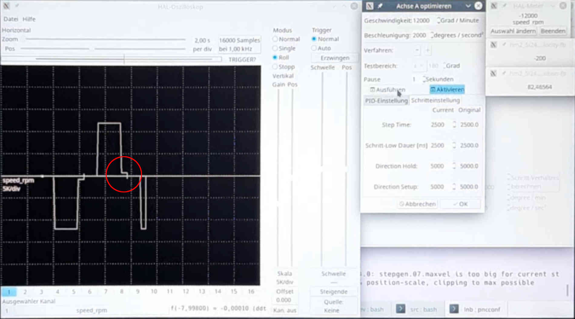

03 Oct 2020 23:11 #184780 by Reinhard
Replied by Reinhard on topic tune stepper function
Different motor/driver, similar problem:
Timings are set according driver specs.
What causes the braking ramp slowing down to fast, so that a slow movement is necessary.
And where is the speed for that slow motion configured?
Slow-motion speed is 12.7°/s
After a quick grep I found that numbers in halfile at a line like this:
setp pid.a.maxerror 0.0127
analogy by chance or related values?
@cmorley
Chris, would it be possible, to link sampling of halscope to run-button of axis-tune dialog?
Would be nice to be able to examine recorded data after stopping motor without any hurry.

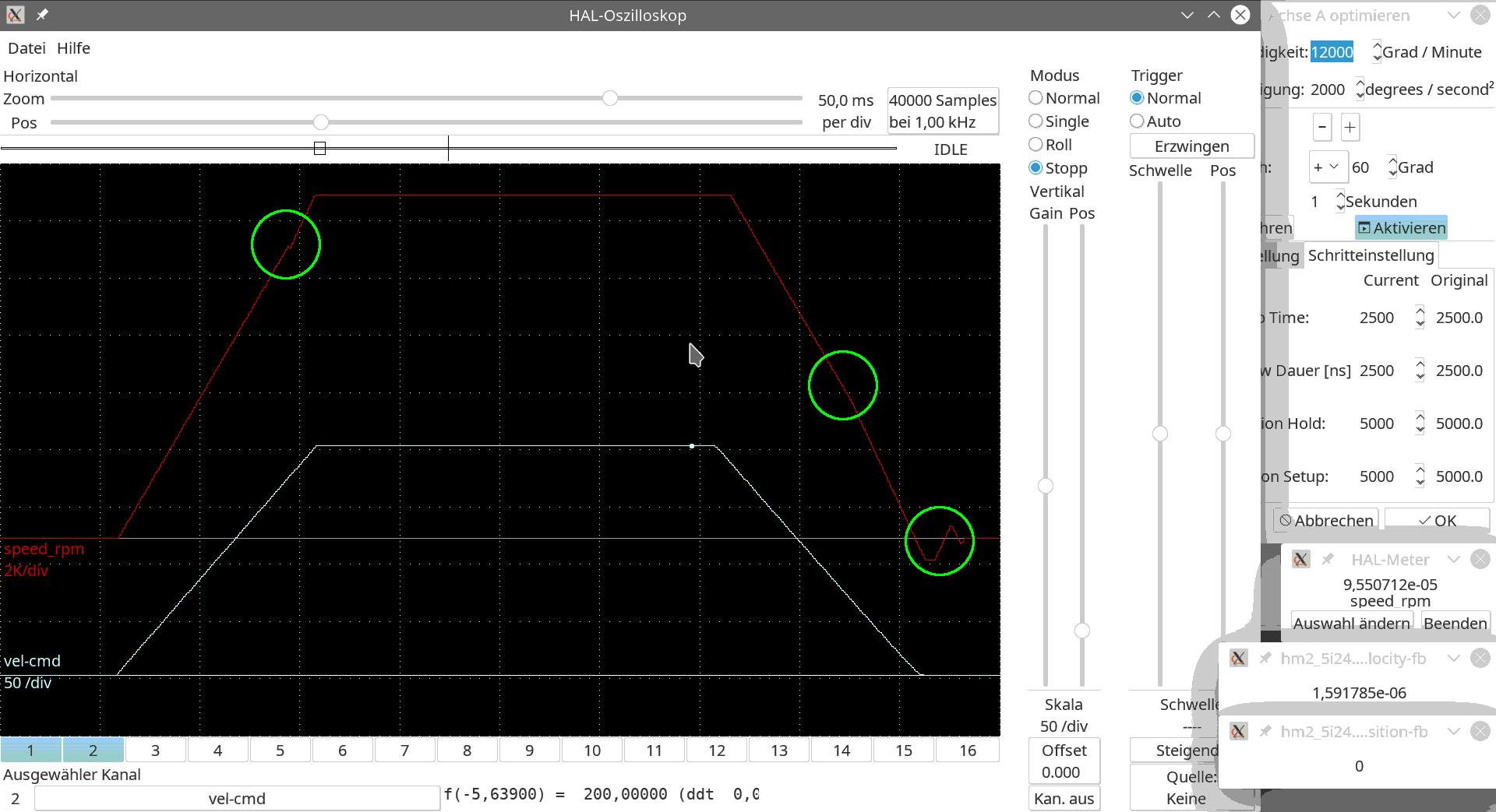

04 Oct 2020 02:56 #184785 by Reinhard
I finally got into roll/stop function of the scope :ohmy:
So I could grab a more detailled picture of what is happening:
Any hints, how I could find out, why the motor does not follow commanded velocity?
04 Oct 2020 07:35 #184805 by PCW
Replied by PCW on topic tune stepper function
Probably because you have no headroom in the stepgen velocity
(that is your step timings bound the maximum velocity so the PID does bad things)
04 Oct 2020 07:42 #184806 by Reinhard
So the white curve is NOT (?) what goes out to stepper driver?
What do I need to add to scope to see the output of PID?
04 Oct 2020 08:01 #184807 by PCW
The white trace is basically the stepgen velocity command
( fed forward via the PIDs FF1 = 1.00 parameter )
But if you have the stepgen's steplen and stepspace
settings too long for the commanded rate, the stepgen will be
unable to follow.

04 Oct 2020 08:14 #184809 by PCW
Any stepgen that does not violate minimum step pulse high and low timings will have these
limitations. That is if I have a step length of 2.5 usec and a step space of 2.5 usec, the
minimum total period is 5 usec or 200 KHz. If I command a higher speed, the step generator
will lag behind. In addition there needs to be some control overhead so the actual maximum speed
will need to be somewhat lower than 200K steps per second.
