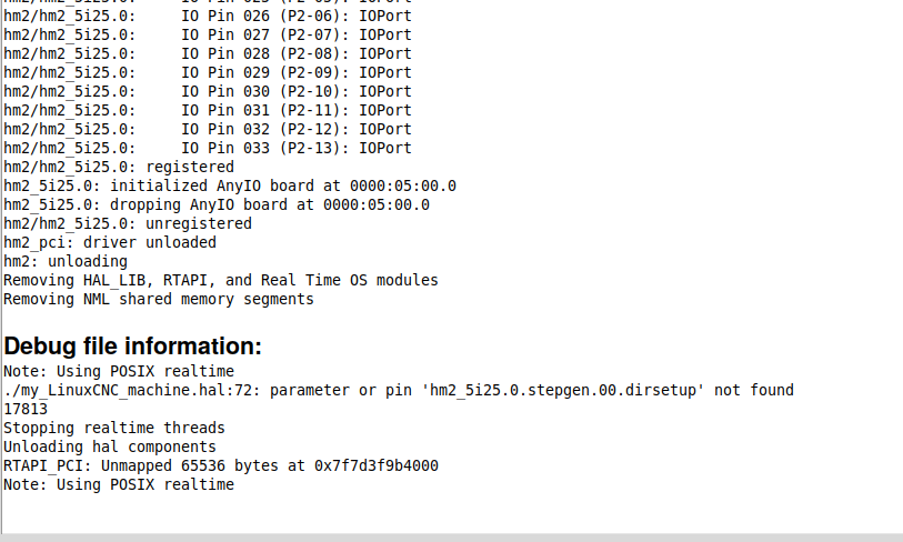

- Posts: 35
05 Nov 2020 23:57 #188466
by kevin19

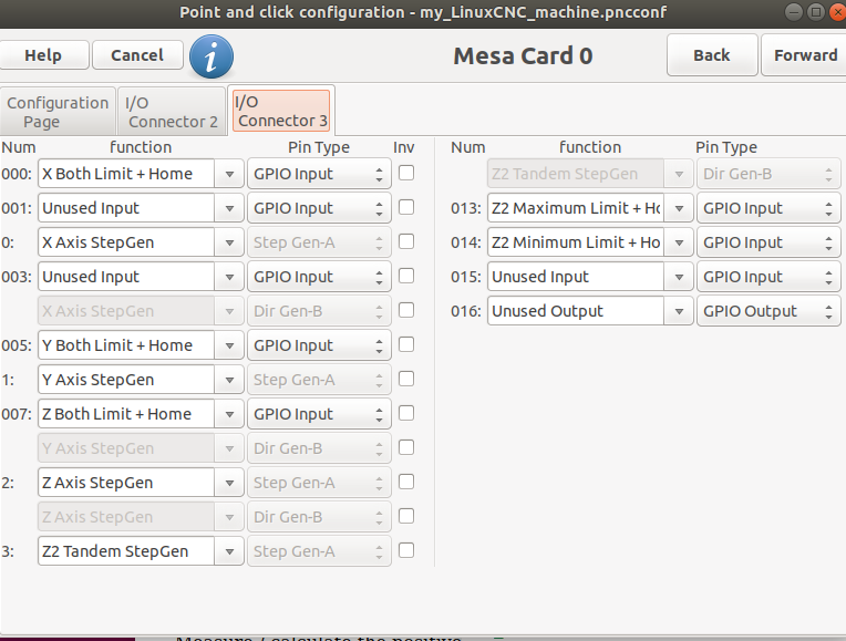

06 Nov 2020 00:30 - 06 Nov 2020 00:58 #188468
Replied by PCW on topic pncconfig error
Did you flash the FPGA card with the 5i25_g540x2.bit firmware?
sudo mesaflash --device 5i25 --write 5i25_g540x2.bit
sudo mesaflash --device 5i25 --reload

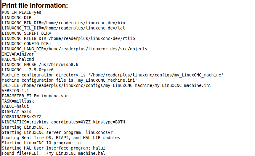

- kevin19
- Posts: 35
06 Nov 2020 08:56 - 06 Nov 2020 09:10 #188482
by kevin19
Replied by kevin19 on topic pncconfig error
thank you for your help:)

- kevin19
- Posts: 35
06 Nov 2020 15:18 #188508
by kevin19
- Posts: 18103
- Thank you received: 5326

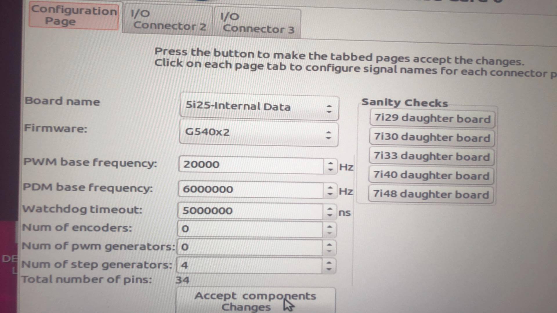

06 Nov 2020 16:54 #188518
Did you select g540x2 and the press "Accept components Changes"
Do you have a 7I75 in between?

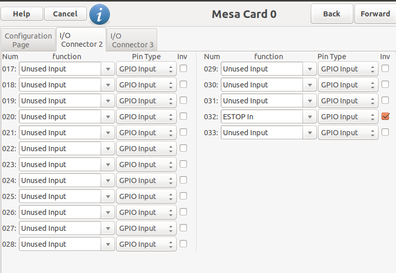

- kevin19
- Posts: 35
06 Nov 2020 17:19 - 06 Nov 2020 17:21 #188520
by kevin19
Last edit: 06 Nov 2020 17:21 by kevin19.
- Posts: 18103
06 Nov 2020 17:21 #188521
Does the I/O connector 3 tab show the stepgen pins?
- kevin19
- Posts: 35
06 Nov 2020 17:27 #188522
by kevin19
- Posts: 18103
06 Nov 2020 18:19 - 06 Nov 2020 18:49 #188527
Yes the step generator setup is done by step generator number.
(which can be a little confusing as the I/O is setup by GPIO number)
Last edit: 06 Nov 2020 18:49 by PCW.
The following user(s) said Thank You: kevin19
