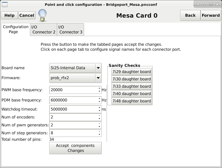

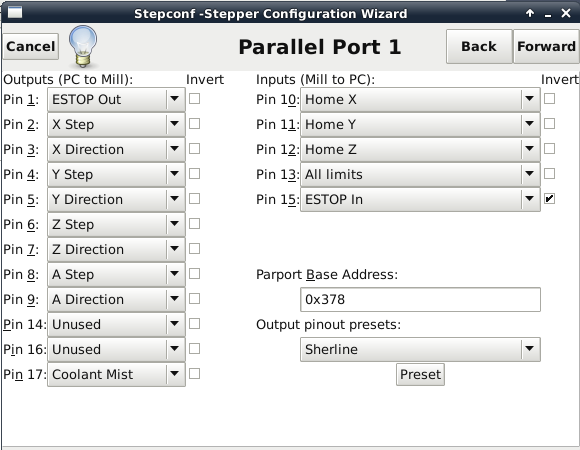

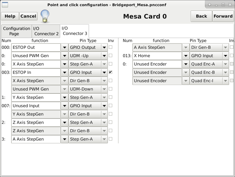

I just changed my 4 axis Bridgeport Series 1 CNC mill from Parallel port control to a Mesa 6125. I have a Probotix breakout board. The first attached photo shows how my I/O was configured with the Parallel port. I reflashed the card with the 5i25_prob_rfx2.bit firmware. I was able to stumble through PnCConf enough to get my Axes to move correctly and to get my E-stop switch to work. However, I cannot figure out how to assign my home and limit switches in PnCConf. Can anyone give me specific guidance on what I need to change where to finish the setup? I have also attached my PnCConf setup screens and my hal file. I ran Linuxcnc on this machine for the past 8 years but am totally new to the Mesa card and have never edited a Hal file in the past. Thanks!

Oh i get it now - you want it to match your existing breakout board.
Sorry I didn't pick that up right away.
I'm not up on how the pins correspond to the parallel port pinout.
maybe the docs for mesa 5i25 has it.

Sample pinout for 5i25 or 6i25, the pin and parallel pin numbers are the two first numbers:
Configuration pin-out:
IO Connections for P3
Pin# I/O Pri. func Sec. func Chan Pin func Pin Dir
1 0 IOPort None
14 1 IOPort PWMGen 0 PWM (Out)
2 2 IOPort StepGen 0 Step (Out)
15 3 IOPort None
3 4 IOPort StepGen 0 Dir (Out)
16 5 IOPort StepGen 4 Step (Out)
4 6 IOPort StepGen 1 Step (Out)
17 7 IOPort None
5 8 IOPort StepGen 1 Dir (Out)
6 9 IOPort StepGen 2 Step (Out)
7 10 IOPort StepGen 2 Dir (Out)
8 11 IOPort StepGen 3 Step (Out)
9 12 IOPort StepGen 3 Dir (Out)
10 13 IOPort QCount 0 Quad-A (In)
11 14 IOPort QCount 0 Quad-B (In)
12 15 IOPort QCount 0 Quad-IDX (In)
13 16 IOPort None
IO Connections for P2
1 17 IOPort None
14 18 IOPort PWMGen 1 PWM (Out)
2 19 IOPort StepGen 5 Step (Out)
15 20 IOPort None
3 21 IOPort StepGen 5 Dir (Out)
16 22 IOPort StepGen 9 Step (Out)
4 23 IOPort StepGen 6 Step (Out)
17 24 IOPort None
5 25 IOPort StepGen 6 Dir (Out)
6 26 IOPort StepGen 7 Step (Out)
7 27 IOPort StepGen 7 Dir (Out)
8 28 IOPort StepGen 8 Step (Out)
9 29 IOPort StepGen 8 Dir (Out)
10 30 IOPort QCount 1 Quad-A (In)
11 31 IOPort QCount 1 Quad-B (In)
12 32 IOPort QCount 1 Quad-IDX (In)
13 33 IOPort NonePlease Log in or Create an account to join the conversation.

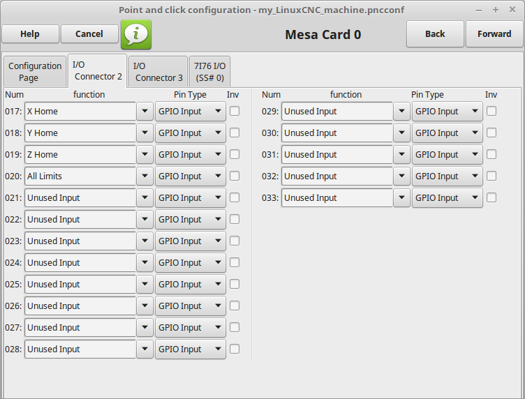

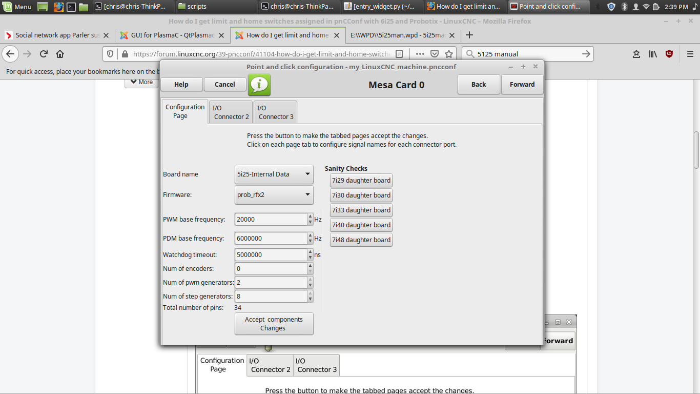

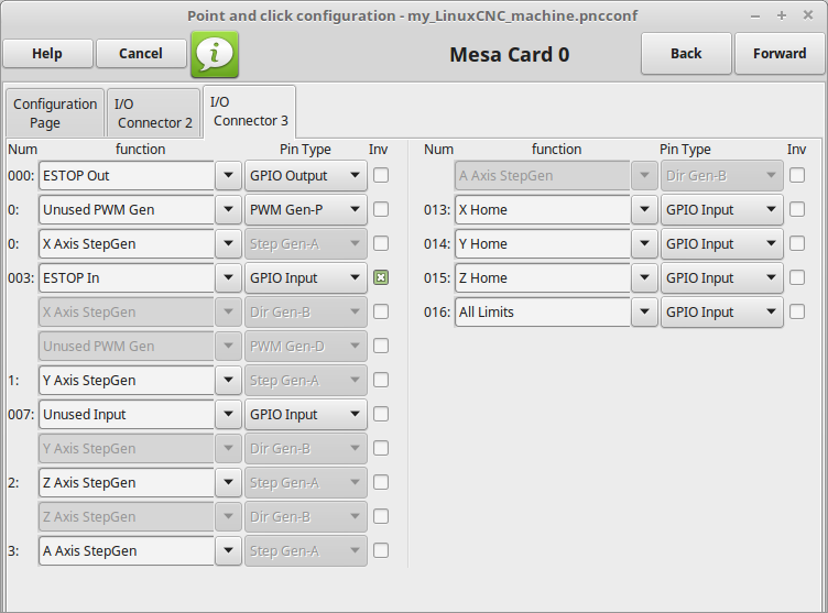

Thanks cmorley and Tom for putting together the last pieces of the puzzle. I did a lot of googling last week, and just did not have a good conceptual understanding of pncconf, as it relates to the firmware on the mesa, and as it related to the physical pinning of the standard 25 pin cable.
I just went down and changed both my Encoders and PWM generators (I don't plan on analog spindle control for the foreseeable future) to "Zero" and of course, that freed up all the rest of the I/O. I have successfully toggled the coolant on and off, and that works, and when I intentionally jog into the limit switches, Axis sees the trip and dumps me into "Override Limits" mode, just like normal.
Next thing is for me to get the rates, directions, home switch locations and home resting positions set. Fortunately, I have all my data for that, so it will just be the trial and error to make sure that my directions are right.
Thanks a million for all the help guys. I don't know how many hours of searching and studying it would have taken me to get this on my own, and I really appreciate the detailed replies.
