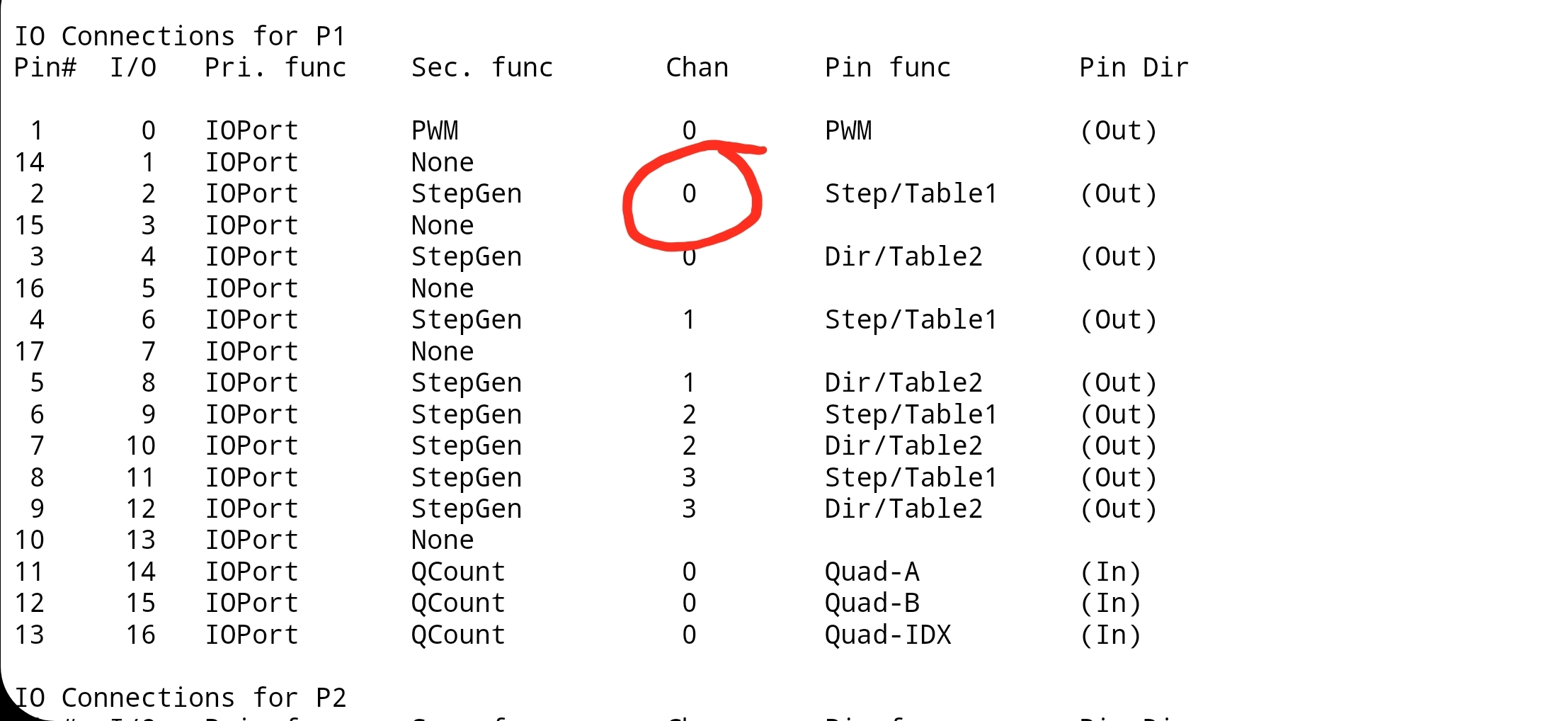

02 Feb 2021 17:47 #197494
by jonnydeen
Replied by jonnydeen on topic 7i98 and 5abobx3 firmware
I have realised that my previous post was inaccurate. I've gone back over the mesa pin assignments using --readhmid and it should work with the bob I have. However when I try to test with a motor and drive Its still incorrect.
For example: x step should be Port1 pin 2 but no, It's actually P1 pin 4.
I have even ruled out the bob and wired P1 pin2 to the stepper drive. It stayed high so the motor just stepped as expected and held.
Then I tried pin 4 and it worked fine with the x axis jog buttons.
Truly stumped by this.

02 Feb 2021 18:37 #197499
Replied by PCW on topic 7i98 and 5abobx3 firmware
Sounds like you have the x axis connected to stepgen 1

02 Feb 2021 19:06 #197501
by jonnydeen
I thought that also but y step is P1 pin6. I checked the hal and checked the bit file and the hal reads x axis is joint 0, y is1, z is 2 etc.
is that indeed referance to the particular numerical value of the axis?
The bit seems to reflects this too. I will double check though. Still very new to this so thank you for your patience.

02 Feb 2021 19:15 - 02 Feb 2021 19:17 #197502
That would make sense if you mapped
X = joint0 --> stepgen1
Y = joint 1 --> stepgen2

03 Feb 2021 04:42 #197537
by jonnydeen
i would agree but it doesnt explain why the dir pins are what they are
x dir = p14
y dir = p16
z dir = p17
again i found these by trial and error. i found step first by pressing jog and jumping the stepper drive step pin to the bob output pins.
then secured the step wire and jumpered the dir signal checking each pin and jogging back and forward looking for the motor reversing direction.
x dir = p14
y dir = p16
z dir = p17

03 Feb 2021 04:55 #197538
by jonnydeen
and i have realised that x is set as stepgen1 in hal so 4 is technically correct however the breakout board normally uses pin2
if i can understand how the direction pins are going where they are i can always look into writing a new bit file to better suit my needs

03 Feb 2021 09:53 #197558
I think I would renumber the stepgens
starting with 0 first so
X=joint0=stepgen0
Y=joint1=stepgen1
Z=joint2=stepgen2

03 Feb 2021 09:57 #197560
by jonnydeen
That would indeed be much simpler, thanks
Any thoughts as to why the direction pins are not where I'd expect them?

03 Feb 2021 10:10 #197562
I would first renumber the stepgens and try again
