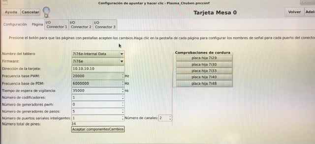

by chuben
I only get connectors 1 - 2 and 3 but not SS # 0
Replied by chuben on topic No found 7i76e
- Posts: 22017
- Thank you received: 7493
29 Jan 2021 12:36 #197051
Replied by tommylight on topic No found 7i76e
Click on "accept components changes", the lowest button with "aceptar.......
- chuben
- Posts: 63
29 Jan 2021 12:54 #197053
by chuben
I've already done it several times and nothingClick on "accept components changes", the lowest button with "aceptar.......
- Posts: 22017
29 Jan 2021 12:59 #197054
Ok that might be an issue with the language, but not sure.
- chuben
- Posts: 63
29 Jan 2021 13:10 #197056
by chuben
I am from Spain and I have it configured in Spanish in case it can help you
And what can I do?Ok that might be an issue with the language, but not sure.

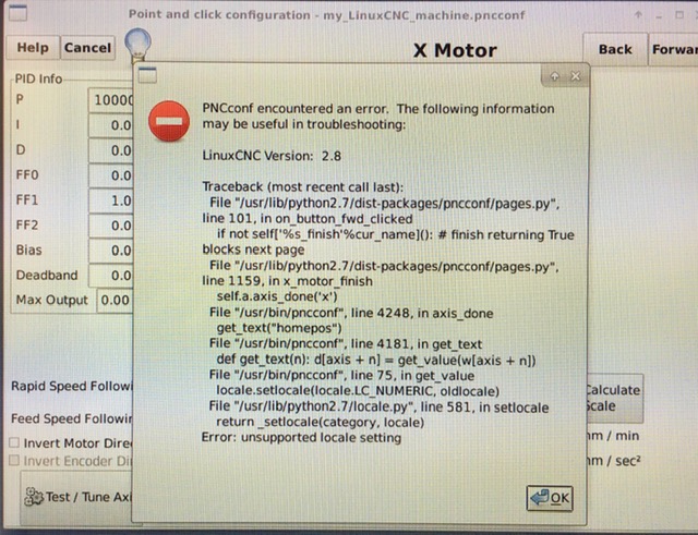

- chuben
- Posts: 63
03 Feb 2021 12:54 #197545
by chuben
Hello, I have changed the language from Spanish to English and it works fine. But now I get another error
- itsme
- Posts: 78
- Thank you received: 21
03 Feb 2021 15:53 - 03 Feb 2021 15:53 #197559
by itsme
Replied by itsme on topic No found 7i76e
I also changed to English and it worked right away.
Did you change to en_US.UTF-8?
