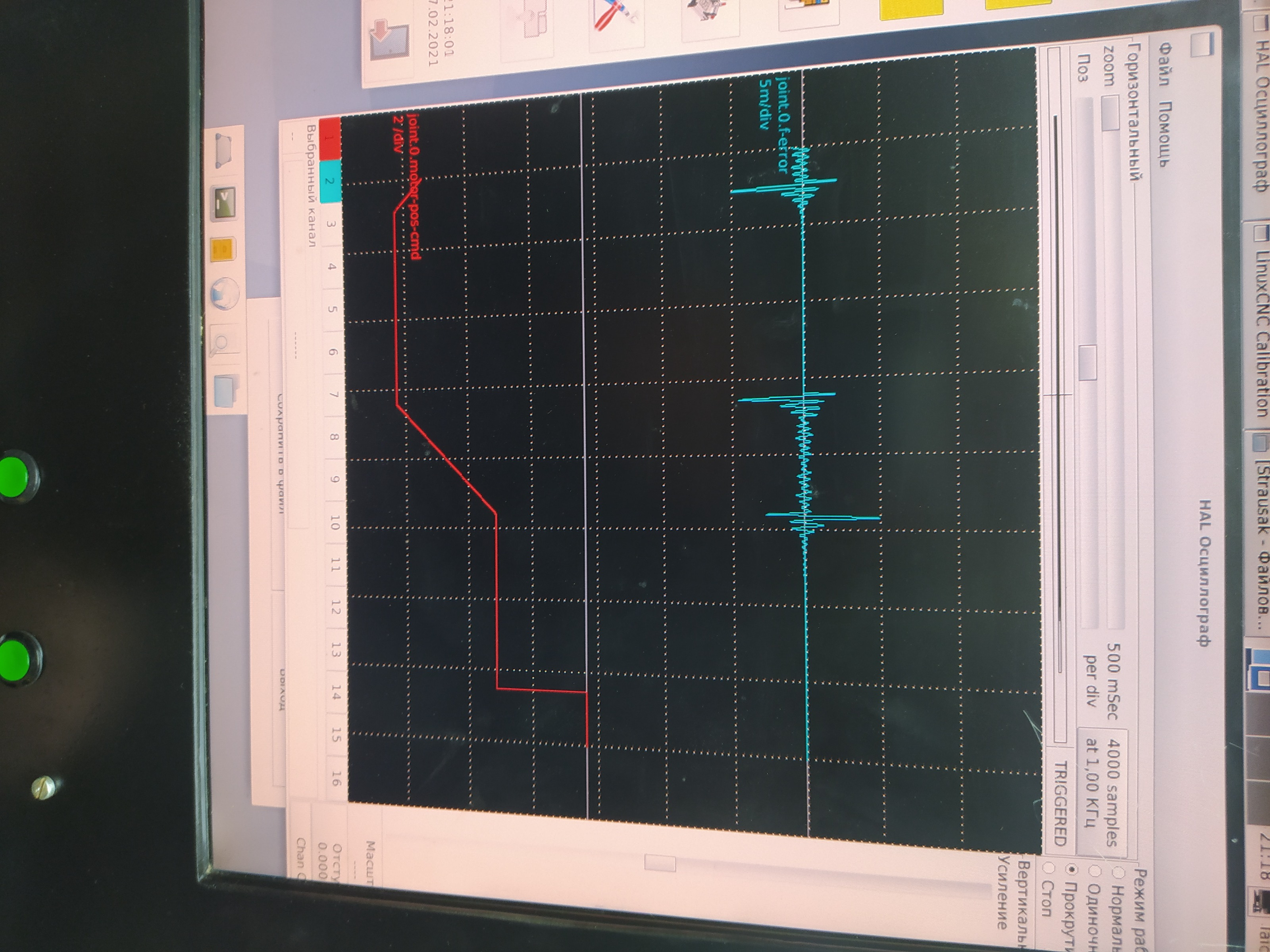

Jerks/overshoots when jogging can be caused by incorrect (too high) FF1

To avoid jerks/oscillations set all P terms to say 2
and _all_ other PID terms to 0 to start
Then you need to look at one of the tuning tutorials,
open the calibrate menus and tune one parameter
on one axis at a time.

Today i worked with one axes X.
I set P value to 20 and FF1 to 0
Then stepped by instructions i got:
P value: 40
FF1:0.22
Motor on 60mm/m run smooth and silent.
But in stop position, DRO make little jumps and in f-error line was some little amplitude noise. I heard vibration.
I decided to grounded computer directly to ground line.
And know what, noise disappeared. I got nice horizontal line in f-error signal. Motor stand still, DRO not moved.
In calibration menu i corrected FF1 to 0.24 and line f-error stand at center. On start/stop ware splash line. So i changed FF2 value to 0.0008.
What i have:
P = 40
FF1 = 0.24
FF2 = 0.0008
From 1 to 240mm/m motor move without hits and f-error signal so little change. But in 250mm/m amplitude f-error rise over 20 times and motor start/stop with hits.
In manual written thar servo/joint can move with 10000/5000 mm/m (reduction ratio 2/1)
Need to tune more?
Photo after tune.
P value: 40
FF1:0.22
What i have:
P = 40
FF1 = 0.24
FF2 = 0.0008
Need to tune more?
Photo after tune.

1. Can you post your current hal and ini files?
Edit I see you added these, I don't see anything wrong at first glance
2. A screen shot of the halscope plot would be a lot more legible
3. Plotting the following error versus velocity rather than position is easier to interpret
Last edit: 30 Apr 2021 14:11 by PCW.

30 Apr 2021 14:37 - 30 Apr 2021 14:38 #207476
This statement will limit the maximum output voltage to +-1V
or 1/10th of full velocity. This is likely the reason you get a following error
when attempting to move at higher speeds. it should be set to 0 or 10
Replied by PCW on topic Mesa 5i25 + 7i77D can't cofig
[JOINT_0]
TYPE = LINEAR
HOME = 0.0
FERROR = 10.0
MIN_FERROR = 1.0
MAX_OUTPUT = 1
Last edit: 30 Apr 2021 14:38 by PCW.

by Taichi
Replied by Taichi on topic Mesa 5i25 + 7i77D can't cofig
I set max_output = 1 on first start pncconfig.
And successfully forgot about it.
Ok, weekend will end, i will try to make graphics f-error vs velocity.
You know, I don't know what the end result should look like. I have no experience in this.
Do I have to achieve a perfectly smooth graph or should the graph not go beyond of max_error in all operating modes?
Also, the time zone prevents us from communicating normally. Anyway, thanks you for the help.

30 Apr 2021 15:58 #207488
The errors will always be there depending on how much you magnify them...
Your plot currently shows a peak error of 5 microns
and a error during (slow) motion of less than 1 micron.
I would say that is quite good for a standard mill,
If you can maintain that accuracy up to higher speeds.
Your current following error limits are huge (1 to 10 MM!)
If you have errors of this size it means a setup error or
hardware fault. These large following error limits are good
for tuning but should be reduced once tuning is complete
