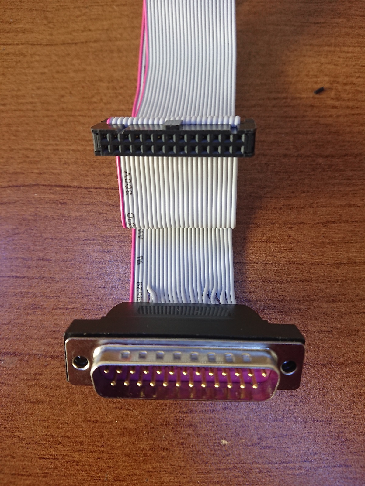

- garrettmin
- Posts: 60
19 Mar 2022 11:47 - 19 Mar 2022 13:05 #237722
by garrettmin
Replied by garrettmin on topic trouble shoting "Pin 'hm2_5i25.0.7i76.0.0.input-24' does not exist 4977"
Diagnostic = Bad Cable @ DB25 to IDC26
7i92 Manual has statement:
the 7I92 can supply up to 1A of 5V power to each of the daughter cards. If you use this option you must verify that the interface cable does not tie the eight parallel port ground wires together as some cheap printer cables do. Mesa supplied IEEE-1284 cables are the best option
7i92 Manual has the DB25 to IDC26 Pinout:
DB25
1 & 14
2 & 15
3 & 16
4 & 17
Is this the correct Pinout for Mesa DB25M to IDC26?
DB25
1 & 14
2 & 15
3 & 16
4 & 17
Last edit: 19 Mar 2022 13:05 by garrettmin.
- Posts: 18120
- Thank you received: 5337
19 Mar 2022 12:00 #237723
Replied by PCW on topic trouble shoting "Pin 'hm2_5i25.0.7i76.0.0.input-24' does not exist 4977"
Yes, a IDC cable HDR26 --> DB25 has the correct pinout.
(with pin 1 --> pin 1 and HDR26 pin 26 unconnected)

- Posts: 18120
19 Mar 2022 17:10 - 19 Mar 2022 17:11 #237749
A correctly made IDC cable is all that's required .
(as long as you have IDC-HDR26 pin1 to IDC-DB25 pin one, its correct)
Is field power connected on the 7I76?
Normally you would _not_ connect to VIN but rather connect
to field power (and leave W1 in the left hand position)
Last edit: 19 Mar 2022 17:11 by PCW.

- Posts: 18120
19 Mar 2022 19:17 #237756
Again, a correctly made IDC cable is all that's required .
(as long as you have IDC-HDR26 pin1 to IDC-DB25 pin 1, its correct)
A hand soldered cable can certainly be wrong however.
For the 7I76 to work with the 7I92, you need:
1. 7I92 with 7I76 firmware installed (verify with mesaflash --readhmid option)
2. 7I76 connected to primary 7I92 connector (P2) with proper (pin 1 to pin 1, IDC) cable
3. 7I76 has both 5V and field power supplied (and W1 left)
4 7I76 W3 left (operate mode)
