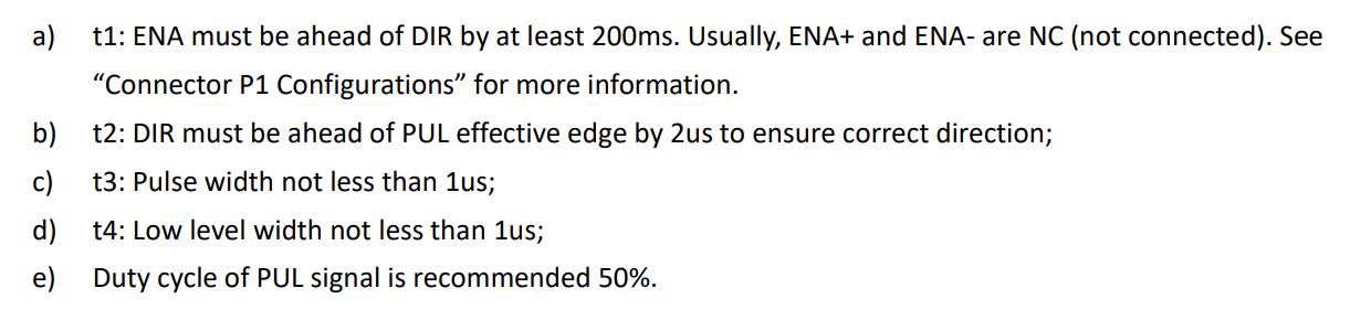

I've got steppers with integrated drivers (JMC) which are not on the list for stepper drive timing(This one: wiki.linuxcnc.org/cgi-bin/wiki.pl?Stepper_Drive_Timing ).  What I found what I think might be related (but what I admittedly don't really understand well) is this:
Remark:
b. t2: DIR must be ahead of PUL active edge by 6μs to ensure correct
direction;
c. t3: Pulse width not less than 2.5μs;
d. t4: Low level width not less than 2.5μs.
"PUL" and "Pulse" mean Step/STP here.

11 Sep 2021 17:08 #220264 by PCW
I would set the setup and hold times to 10000.
This is 10 us, ample margin relative to the
drives 6 us specification.
Initially I would set the step time and step space to
5000 (5 us), double the drives 2.5 us minimum limits.
The only reason to reduce these times is if you cannot
reach the desired speed with 5 us/5us timings (100 KHz)
I would leave the drive with rising edge trigger
