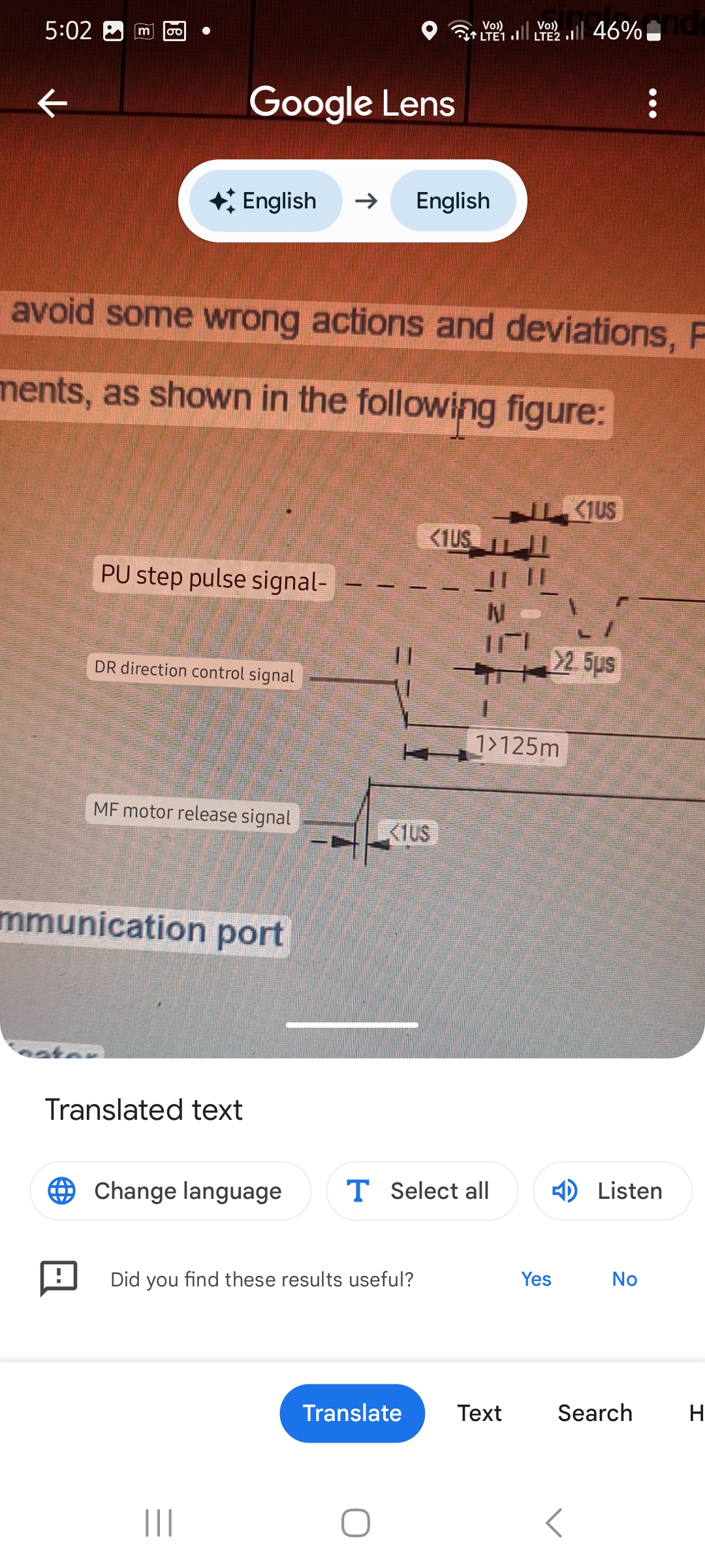

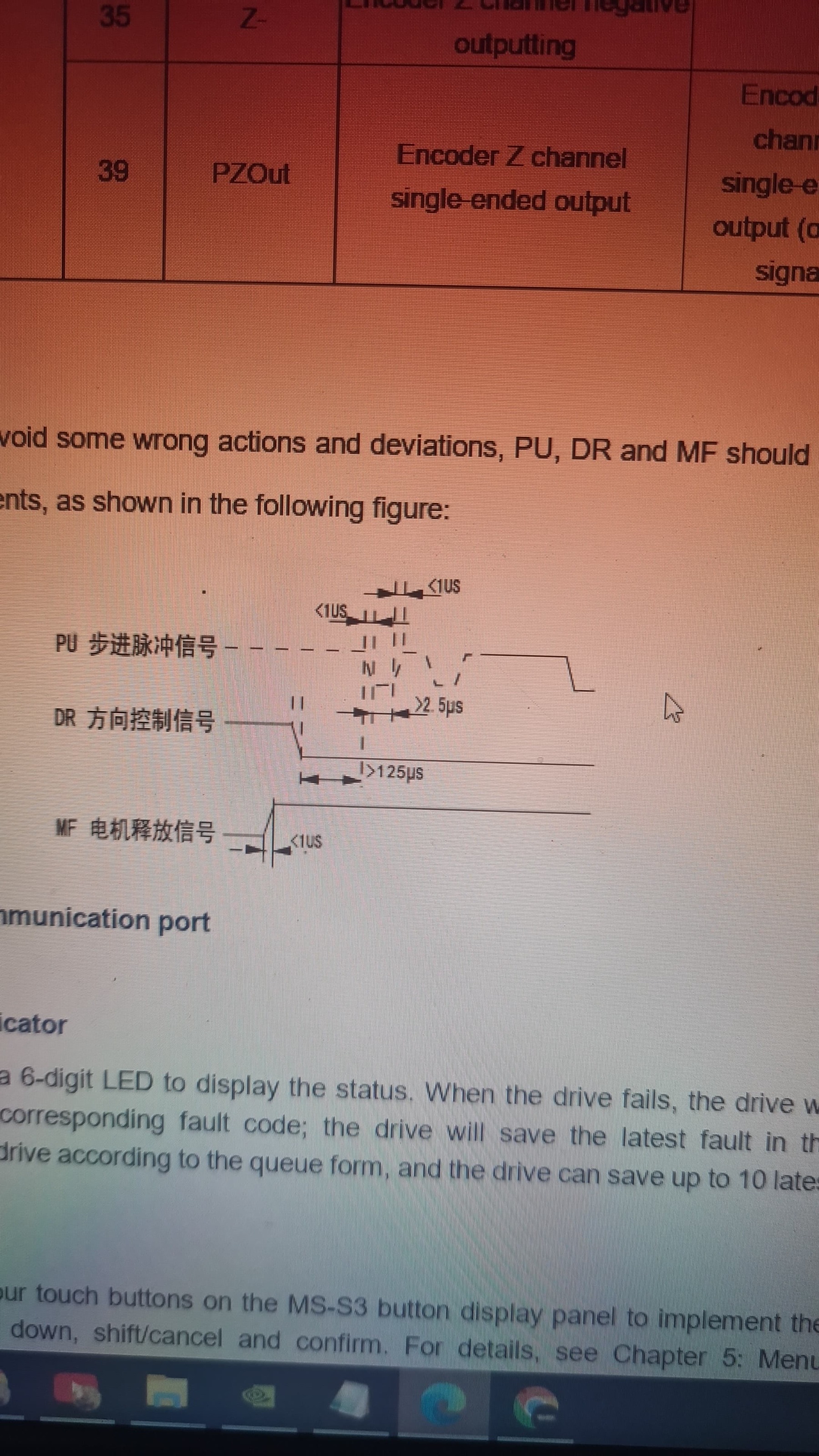

- visharc
- Posts: 4
05 Apr 2024 11:45 - 05 Apr 2024 11:50 #297639
by visharc
Replied by visharc on topic How to find the right Step Time/Step Space?
Last edit: 05 Apr 2024 11:50 by visharc.
- Posts: 18065
- Thank you received: 5308
05 Apr 2024 12:44 #297642
Replied by PCW on topic How to find the right Step Time/Step Space?
The specifications miss the minimum step pulse high
time and direction hold time but this should work:
Steptime = 5000
Stepspace = 5000
Dirsetup = 130000
Dirhold = 130000
Note that the picture shows active low
step pulses so make sure you invert
the step outputs (LinuxCNC default is active high)
Steptime = 5000
Stepspace = 5000
Dirsetup = 130000
Dirhold = 130000
The following user(s) said Thank You: visharc
