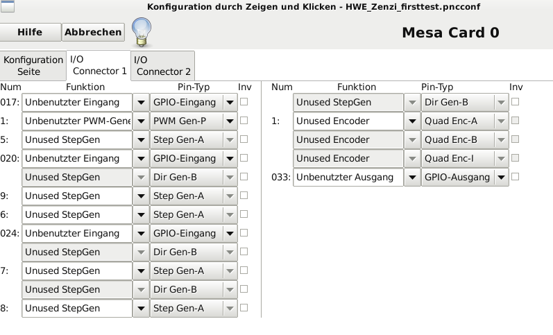

I am changing from an old 32-bit parallelport-PC+DIY-driver to a new 64bit-PC with ETH+7i92+ DIY-driver board setup.
I have to switch to a 64-bit machine to use the latest linuxcnc-2.8.1 version.
I want to replace my parallelport with the MESA 7i92.
The 7i92 is connected and can be read via mesaflash.
When I run the pncconf-wizard I have the following choices for 7i92-firmware:
7i76x2
7i76x2 with one 7i76
7i77_7i76
7i77x2
7i77x2 with one 7i77
G540x2
I think I can just use the default firmware and config of the 7i92 - no need to flash - since I can easily connect my step/dir signals to the 7i92 as needed, due to my DIY-driver.
But what is the default firmware of the 7i92 when it is delivered from Mesa ?
Which of the above selection would match the default firmware ?
I tried to read the firmware-version with "mesaflash" - but no option is giving me the firmware version.
The mesaflash shows me the following configuration as attached in mesaflash_config.txt
I am also wondering about the numbering of the pins in the pncconf wizard I/O connector GUI - see attached in pnccofn_IOCpnnector.png. Why are they not numbered from 1,2,3,.... but using 017, 020 etc. ?
Do I really need to flash the 7i92 board or can I use the default config ?
What would be the correct setup in pncconf for the default 7i2 firmware?
I also searched the forum for a step-by-step tutorial for a 7i92 setup, but did not find a complete one.

1. I would probably re-flash with g540x2 firmware
2. You would normally use connector 2
3. The 3 digit numbers are GPIO numbers for simple input output access,
the 1 digit numbers are module numbers (like stepgen 0,1,2,3 etc)

- Posts: 37
08 Oct 2021 12:12 - 08 Oct 2021 12:15 #222563
by hwe
Replied by hwe on topic 7i92 default firmware version and pncconf
Hi,after finalizing my pncconf-setup and starting Linuxcnc, I get the following error:....hm2_pci: rtapi_app main: No such device (-19) ...Please see the error-report attached.What I am doing wrong ?

If you used pncconf configuration for a pci card,
you will need to change the driver name in the hal file
from hm2_pci to hm2_eth (and add the ip address to the
driver command line)

Like this:
loadrt hm2_eth config=" num_encoders=1 num_pwmgens=0 num_stepgens=5 sserial_port_0=00xxxx ip=192.168.1.121"
Or which commandline you refer to ?

loadrt hm2_eth board_ip=192.168.1.121 config="some config stuff"
