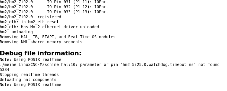

Looks like this now:
loadrt [KINS]KINEMATICS
loadrt [EMCMOT]EMCMOT servo_period_nsec=[EMCMOT]SERVO_PERIOD num_joints=[KINS]JOINTS
loadrt hostmot2
loadrt hm2_eth board_ip="192.168.1.121" config=" num_encoders=1 num_pwmgens=0 num_stepgens=5 sserial_port_0=00xxxx"
#setp hm2_5i25.0.watchdog.timeout_ns 5000000
loadrt pid names=pid.x,pid.y,pid.z,pid.s
addf hm2_5i25.0.read servo-thread
addf motion-command-handler servo-thread#
EDIT: corrected to board_ip=192.168.1.121 but no success. Same error.
So - first complained about watchdog.timeout - I commented out
Now - complains about "hm2_5i25.0.read not found"
Is there a tutorial somewhere I can follow to setup a simple 7i92 configuation ?
Shouldn't be so hard to config this .....

Replied by PCW on topic 7i92 default firmware version and pncconf
Look's like you made a 5i25 PCI card configuration.
To use that hal file, you would need to replace
all instances of '5i25" with "7i92".

You are my hero - it works !
Maybe with all the fiddling with IPs and so on, I missed to choose 7i92 for my latest pncconfig.
dummy me !
dummy me !
