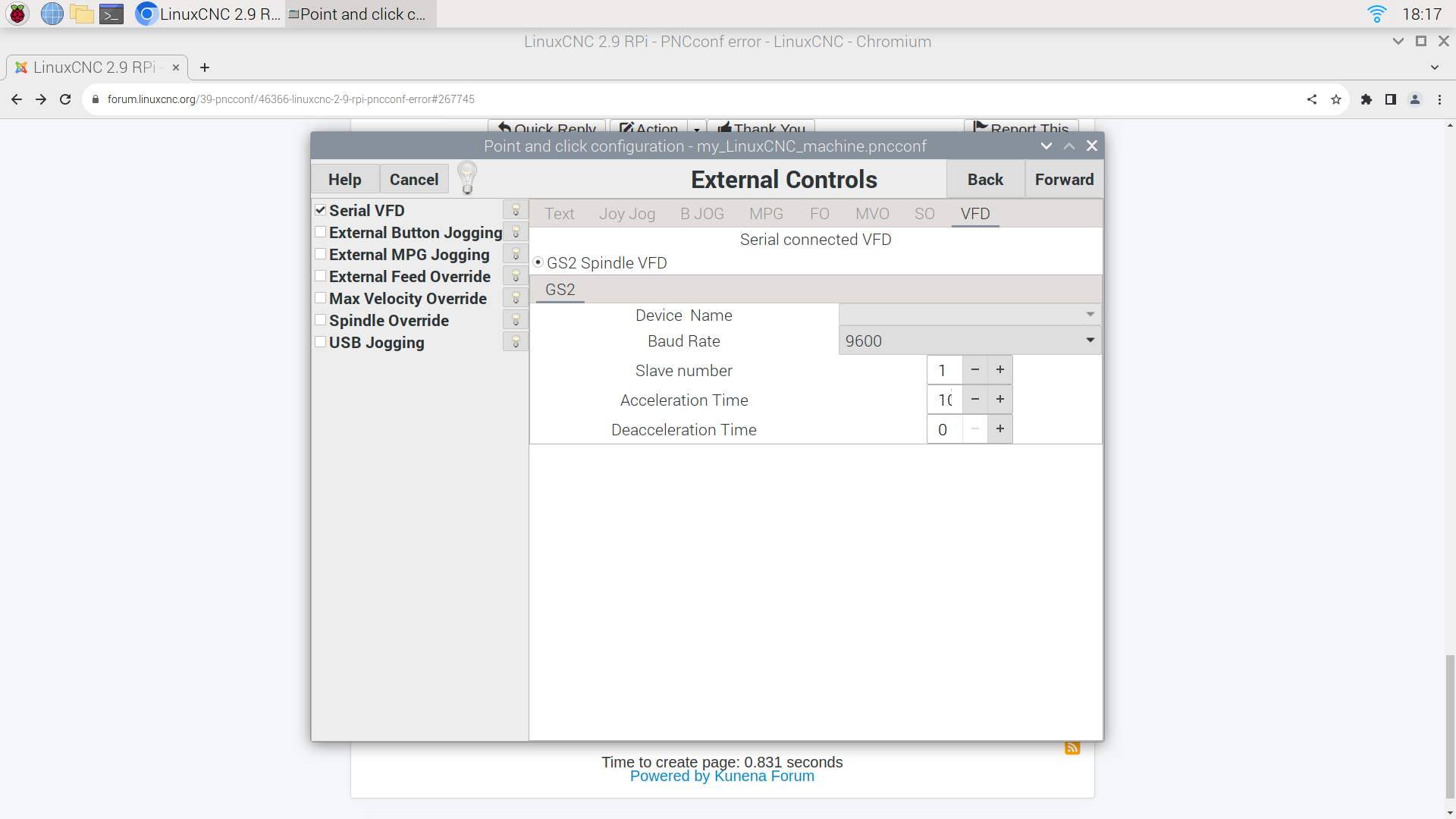

29 Mar 2023 01:14 #267749
Replied by cmorley on topic LinuxCNC 2.9 RPi - PNCconf error
on the external controls page, click on 'serial vfd'
Please post an image of that page.

29 Mar 2023 01:21 #267750
by mor
Replied by mor on topic LinuxCNC 2.9 RPi - PNCconf error

I get the error before the Mesa page; see above post with attached image.
Ok I see the serial port entry is not filled.
let me look into that.
in src/emc/usr_intf/pncconf/pages.py
modify the function to this:
def search_for_serial_device_name(self):
match = os.popen("""ls /sys/class/tty/*/device/driver | grep 'driver' | cut -d "/" -f 5""").read().split()
if len(match) <1: return
model = self.w.gs2_vfd_device_name.get_model()
model.clear()
for item in match:
name = '/dev/%s'%item
model.append((name,))Please Log in or Create an account to join the conversation.
