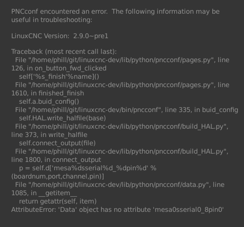

My PI4 has finally finished updating and FWIW I don't see the issue on a RIP build. I probably have an older kernel (5.15.27-rt35-v8), not sure if that would make a difference.
The error I posted before only happens if I select the 7i96s_7i74 firmware which seems to be the default.

Looks like an off by one error. I'm just not sure if the firmware data is wrong, or the parsing function is wrong. I would need to have the firmware output from mesaflash to test with.While waiting for my RPI to update I ran PNCconf to the end and noticed this error if I selected a 7i96s:
I don't see that if I select a 7i96.
I'll change it so at least it doesn't crash. Thanks.

I could only see 8 in this attachment

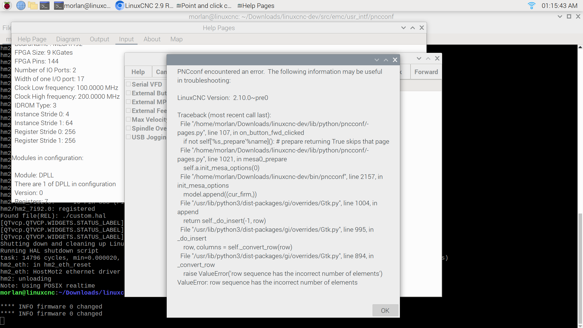

When I try to reopen the .conf file, I get the attached error. I did use custom HMID on the INPUT page of help. Terminal shows: **** INFO firmware 0 changed. Do you think that's the cause?
