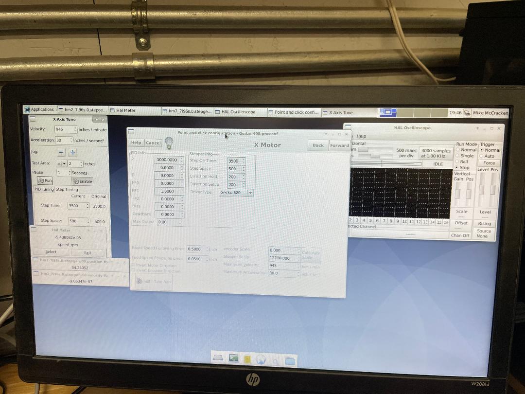

Hello,
I am working on retrofitting a late 90's Gerber Sabre 408 with LinuxCNC. The PC that was running Gerbers proprietary software finally died so I decided to move to LinuxCNC.
My setup:
Mesa 7i96s
3x Gecko G320x servo drives
Original servo motors (Parker RX320ER1026)
Original Encoders (Renco 324599-03)
I got the software loaded, rewired everything (Gerber didn't make this part easy), Got the VFD changed to take a 0-10v signal, etc.
Where I am stuck is on the X, Y, Z configuration. Originally I used the Gecko 320 configuration from the drop down in the pncconf because I fugured that the "x" shouldn't change much. There was motion but not the distance I expected. Then I found the settings for the G320X and that provides no motion of the motors. This is my first build and I feel so lost when it comes to setting up the servos. I have no clue what the encoder counts are, how many steps per revolution, etc.
Any help on dip switch / software settings on this would be much appreciated.

One thing to remember on step length settings is that the manufacturers numbers are
_minimum_ values so these should not be used in a real system. Unless it interferes
with the maximum speed, I would start with values double the manufacturers minimums.
As far as scaling goes, if you know the ball screw pitch, the number of steps per turn
and any gearing between the motor and the ball screw, this can be calculated. If you dont have this information you can determine it with successive approximation (as long as you have good measuring tools)

So, if I understand correctly, the step on time, step space, direction hold, direction space should be doubled as a starting point?
I found this info online and believe that it may be accurate:
for the X, and Y axis which should allow me to calculate my scaling.
servo encoder counts per revolution: 4000
Servo teeth: 28
Lead screw teeth: 70
Pitch: 20mm
counts per mm: 500
Servo teeth: 28
Pitch: 20mm
counts per mm: 500

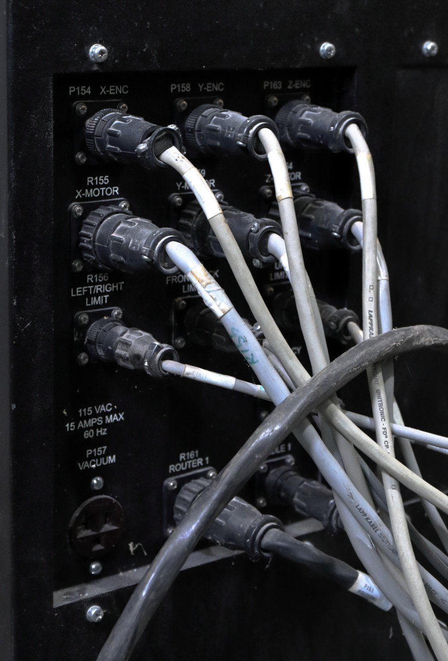

I have retrofit two Gerber Sabre 408's with LinuxCNC, and plan on retrofitting at least one more in the near future. I use Mesa cards and custom adapter PCBs mounted onto a plate that becomes a bolt-in replacement for the original Gerber motherboard in the top of the electrical cabinet.
Here is a video of the first machine I did (it has an after-market ISO30 ATC spindle):
Gerber Sabre 408 retrofit with LinuxCNC 3D routing foam

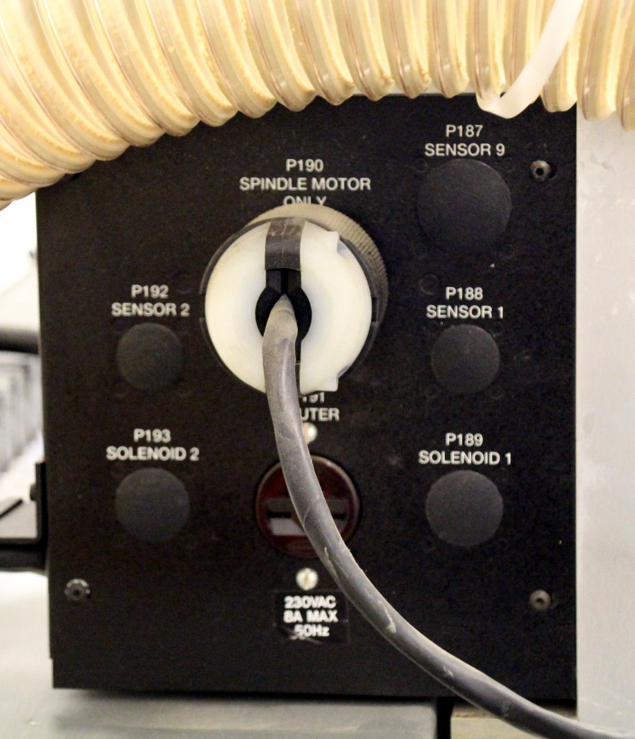

If your original setup had the "high frequency spindle" option, then you have a Perske (non-ATC) or Colombo (ATC) spindle with a Saftronics/Yaskawa VFD in it's own electrical box. This box is controlled by two signals: a relay to turn the spindle on, and Modbus over RS-232 (not RS-485!) to control the spindle speed.
If you have a "dumb" 120V router (like a Porter Cable, etc.) hooked to the outlet on the side of the Z axis, then your spindle is controlled by a relay within the main electrical cabinet. (None of our machines are like this.)
My current setup provides access to the following:
If you are interested in buying a retrofit kit from me, please private message me.
--Forest
- encoder feedback from the servo encoders
- analog torque / enable signals to torque-mode brushed DC servo drives
- limit/home switches
- +5V & +24V power from the motherboard power connector
- controlling the "high frequency spindle" electrical cabinet via Modbus
- respecting the physical E-stop buttons on the machine itself
- no pendant support (the original pendant was proprietary with a brain of it's own)
- controlling the 120V "dumb" spindle electrical outlet on the side of the Z axis
- controlling the 120V vacuum electrical outlet on the electrical cabinet (for dust collection?)
- listening to the optional auxiliary sensors on the side of the Z axis (does anyone ever use them? Our machines just have hole plugs and no connectors...)
--Forest

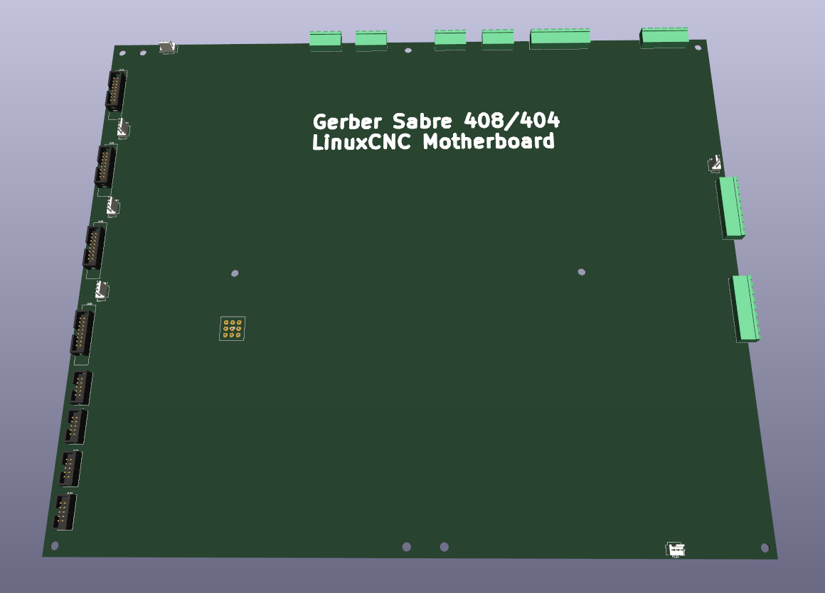

I am actively working on a monolithic motherboard replacement, attached is a photo of the physical form factor. I am 90% done with the schematic, and then will knock out the trace/component layout on the board. The motherboard is huge (14x17") so there aren't space issues thankfully.Has anyone else made progress on this recently?
Am looking to do the same but am new to CNC controllers and finding it hard to judge the overall cost
I expect to have prototypes within a month, I'll keep you all posted.
