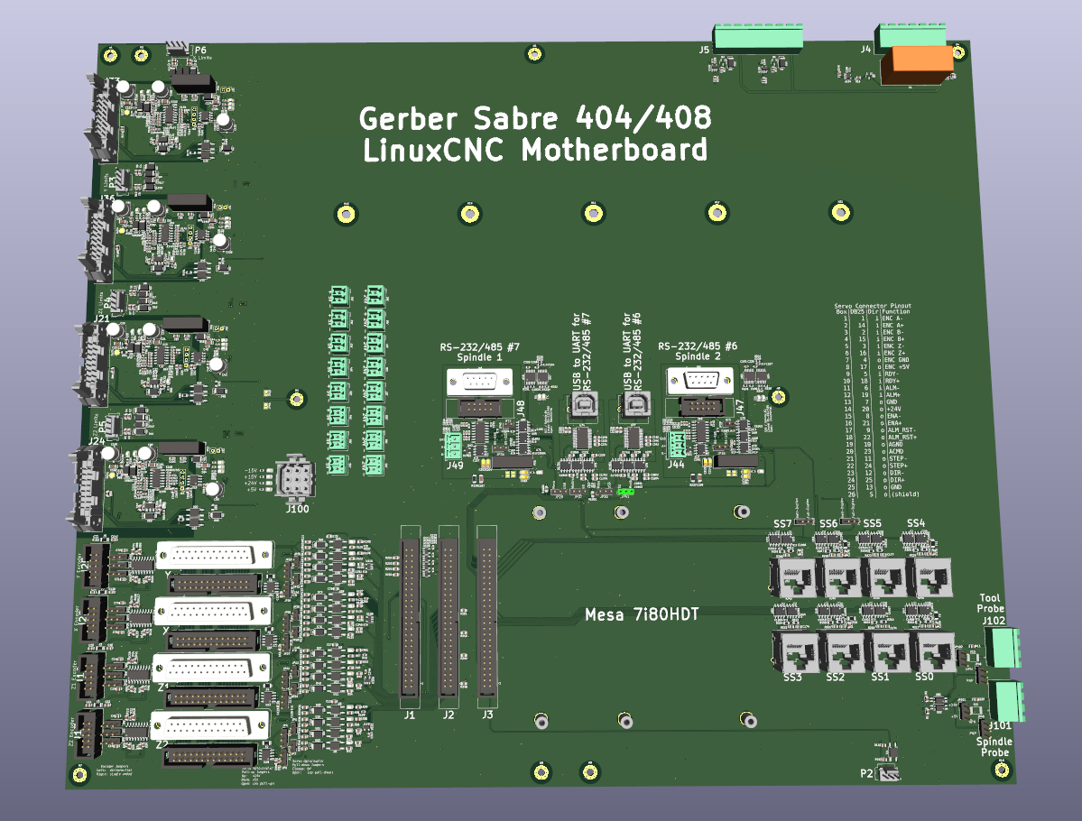

Here is the progress with the retrofit motherboard, I am just a couple "work days" away from sending the design off for fabrication.

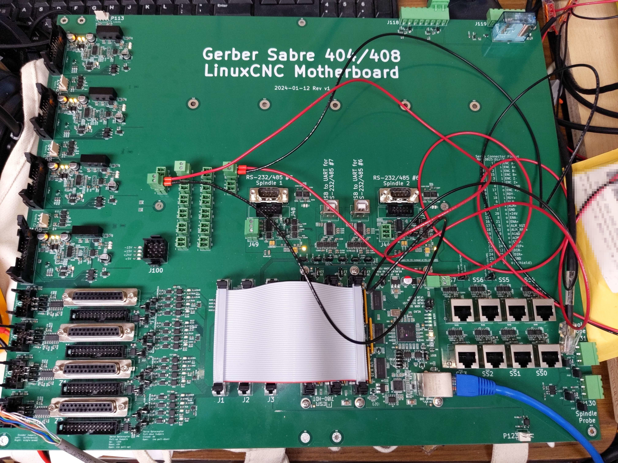

I received the prototype batch of PCBs, and have begun testing (photo attached). I have verified that the following is working:
  • ±10V analog outputs to servo drives
  • encoder inputs
  • servo drive related outputs: enable & alarm reset
  • servo drive related inputs: drive ready & alarm
  • limit/home switch inputs
  • spindle enable relay
  • "vacuum" & "router" outputs (drive relays in the electrical cabinet that control 120VAC outlets)
  • expansion spindle probe and tool probe inputs (24V/5V selectable power, PNP/NPN selectable trigger)
  • SmartSerial expansion (6 channels, up to 8 if not using Mesa PacketUARTs)

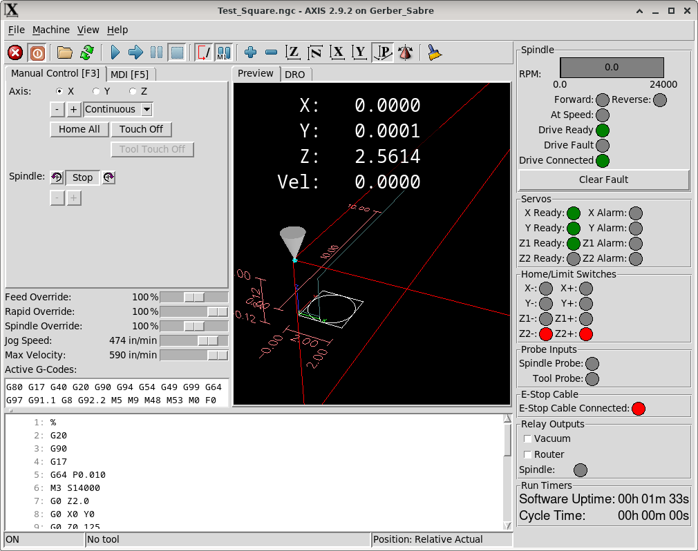

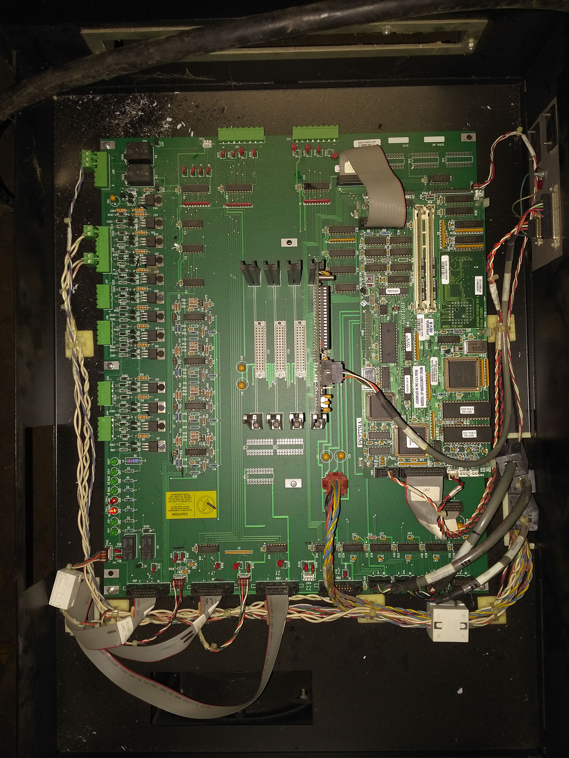

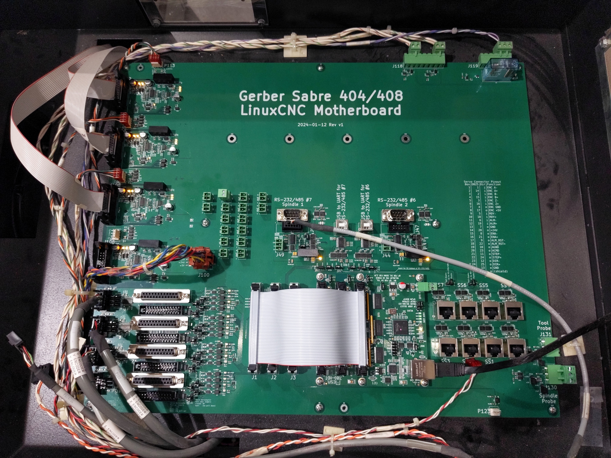

I have completed testing the Gerber Sabre LinuxCNC retrofit motherboard, and everything works! I attached a photo of the motherboard installed in the electrical cabinet, as well as a photo of the original motherboard for reference. There is also a screenshot of LinuxCNC.
