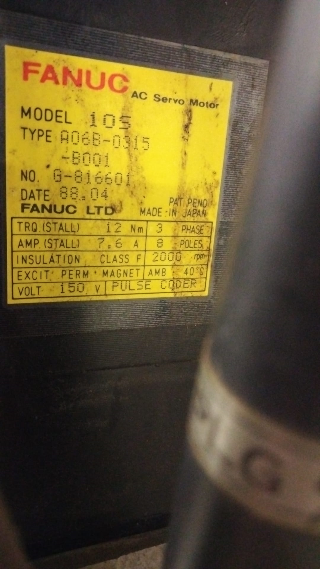

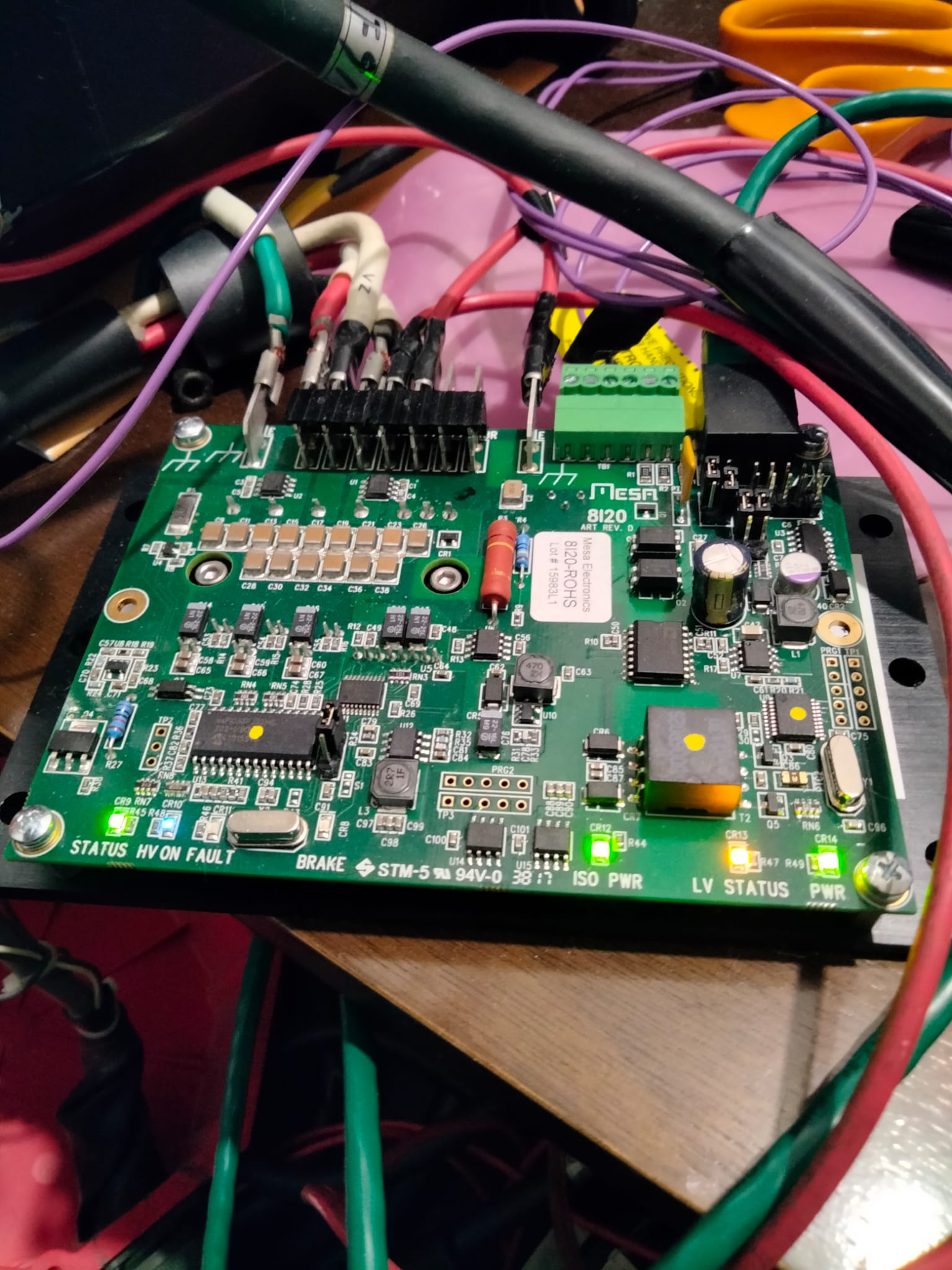

18 Dec 2022 14:07 - 18 Dec 2022 14:17 #259851 by saquzi
Replied by saquzi on topic 7i97+8i20 error function not found
This is the current servo i am copying with..
And current wiring if something seems off here... 8i20 from left to right: servo GND, UZ, VZ, WZ, battery - (55vdc), battery +, and additional groung to the servo, then enable 5vdc + - on the  smaller tb6 connector..

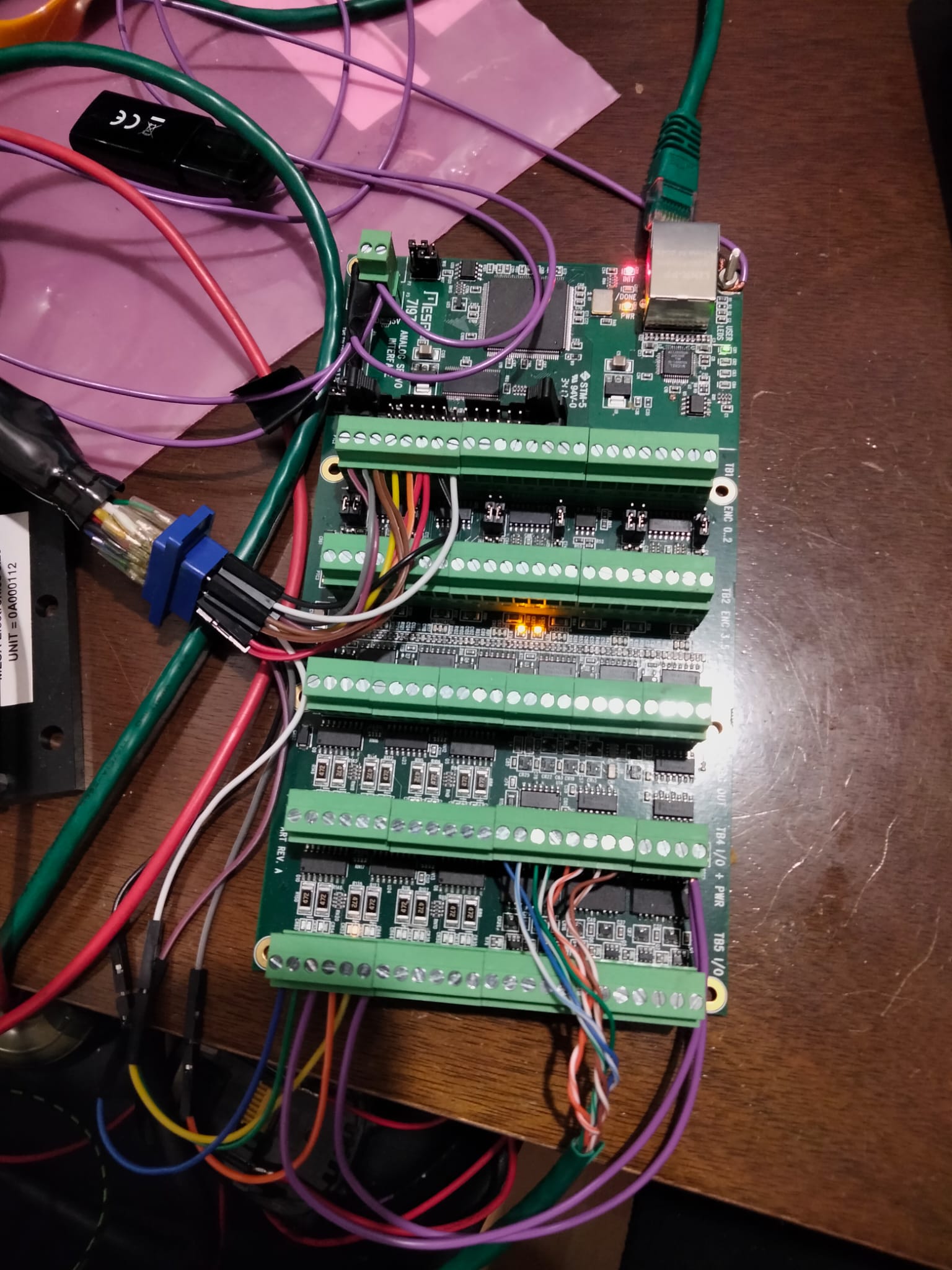

18 Dec 2022 14:22 #259853 by PCW
Replied by PCW on topic 7i97+8i20 error function not found
what does:
halcmd show all hm2
report?
18 Dec 2022 14:42 #259854 by PCW
Also my guess is that the stall current listed on the motor nameplate
is the continuous stall current, not the peak current. So its likely
that you would need to set the 8I20s peak current to 20 or 30 A
(2000 or 3000) to get the full potential torque from the motor
Yeah wondered that too, just tried to play safe for testing at 7.5a
18 Dec 2022 17:39 #259863 by PCW
OK
what does:
halcmd -kf
halcmd: unlinkp hm2_7i97.0.8i20.0.0.current
halcmd: setp hm2_7i97.0.8i20.0.0.current 5
do? does it cause motor motion (or detent torque)
(the "halcmd: " is a prompt, don't type it)
18 Dec 2022 18:00 #259864 by saquzi
Tried that, it caused the servo to move :) and can turn it with hand, will "locate" itself in every 90degrees apart.
18 Dec 2022 18:14 #259866 by PCW
OK that means the 8i20 is enabled and working
so lack of motion is probably some problem(s)
with BLDC setup, either initialization or feedback
