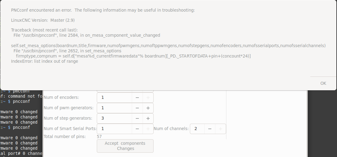

I'm still low enough on the learning curve to find HAL totally confusing. So I was wishing that pncconf had contained the 7c81 information. I found a thread about how to add a MESA card which led me to this document in the github repository.
Great document. Only two things I didn't understand. 1) What are "discovered sserial devices"? 2) I just don't understand this paragraph at all. What logical number?
Using this document and the pin file generated based on the default firmware loaded into the 7c81 I edited /usr/lib/python3/dist-packages/pncconf/private_data.py after making a backup copy.
In the pin file, all pins list the primary function as IOPORT. So I used the secondary functions. I don't know if that is correct. Here is what was added in the MESA_INTERNAL_FIRMWAREDATA section.
This was added in the MESA_BOARD_META section.
I called this a 5ABOBX1 because it doesn't match the 5ABOBX2 or 5ABOBX3 pin files.
It almost works, but not quite. It gets to the "Mesa Card 0" screen, and you can select the card and firmware. I only need a PWM for spindle speed, so I reduced Num of pwm generators to 1. It's a 3 axis mill, so I reduced Num of step generators to 3. But Accept component Changes has an error. It has this same error even if I don't reduce any counts.
Something I added is causing an index to go out of range, but I'm not sure what exactly.
I'd greatly appreciate any and all review of this as I may have made multiple mistakes.

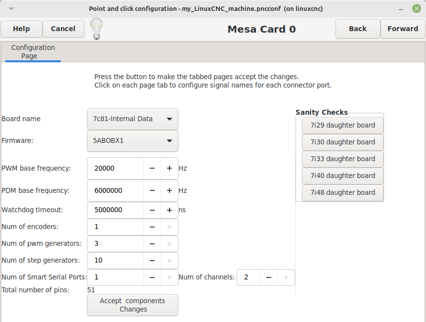

OK, I figured out the "index out of range" error. To paraphrase Monty Python "Then, shalt thou count to three 24. No more. No less. Three 24 shalt be the number thou shalt count, and the number of the counting shall be three 24. Four shalt thou not count, nor either count thou two, excepting that thou then proceed to three 24. Five is right out."
I hadn't understood the difference between calling a pin a GPIO or NUSED. NUSED means fake. If there are less the 24 pins you have to add fake pins till the array of pins equals 24.
Here is the new MESA_INTERNAL_FIRMWAREDATA text.
I also tweaked the line in the MESA_BOARD_META section.
This seems to work correctly. Would still appreciate any additional information or feedback.

You can use pncconf to create a configuration for say a 5i25/G540
and then edit the ini file created to change the card name from 5I25 to 7C81
and finally edit the hal file to change the driver name from hm2_pci to hm2_rpspi
