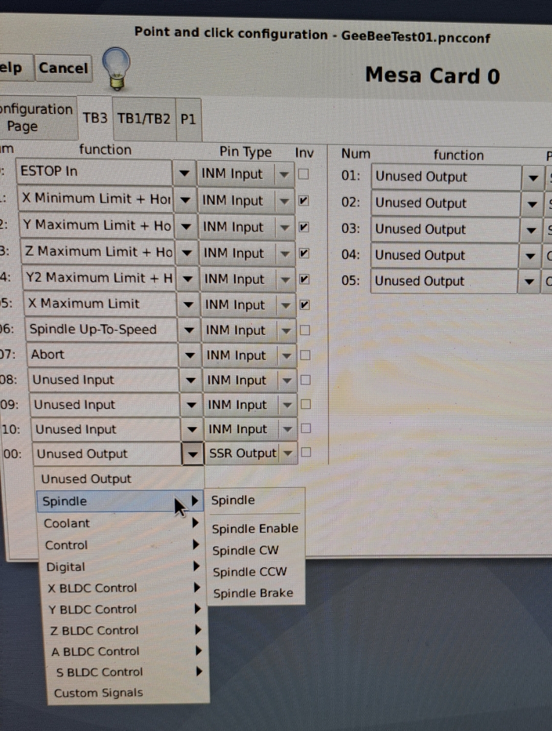

28 Jul 2023 01:56 - 28 Jul 2023 02:12 #276419
by supermoto
If I attach PSU (-) to DCM, and then an output (-) to DCM, is that correct?
Isn't that the same as the output (-) to PSU (-)?
I have:out0(-) to DCMOut0( ) to VFD FOR
Still can't get spindle to be active when pressing [F9]
I tried assigning the output to "Spindle Enable" and also "Spindle CW" also cycled through parameters in VFD for that input between "Run", "For rotation", "FOR/REV" for each iteration.
Should i be able to meter any output voltage between Out0( ) and Out0(-) when active (when LED is on)?
Replied by supermoto on topic Logic assignments for VFD/Spindle control and EStops (7i96s)
Yes. the UPF and DRV outputs are sinking (pulldown) outputs.
If you wish to wire these tot a 7I96S isolated input you would need to connect the 7I96S input common (TB3 pin 12) to 24V and the 24V supply common to DCM.
The VFD's FOR and REV inputs must be grounded to activate so you would connect for example:
7I96S OUT4 --> VFD FOR
7I96S OUT4- --> DCM
Last edit: 28 Jul 2023 02:12 by supermoto. Reason: formatting

28 Jul 2023 02:11 #276423
Replied by PCW on topic Logic assignments for VFD/Spindle control and EStops (7i96s)
Before connecting to the 7I96S outputs, I would verify FOR and REV operation
with a switch, when this works, you can replace the switch with the appropriate
OUTN+,OUTN- pair (the OUT4,5 don't care about polarity but OUTs 0..3 do))

29 Jul 2023 11:55 - 29 Jul 2023 11:58 #276523
by supermoto
I am not getting the VFD enabled when connecting:
DCM to FOR
And
DCM to REV
(both switches closed)
I have VFD parameters set where FOR is "run" and REV is "For/Rev" as described here:
www.diycncdesign.com/linuxcnc-2.8-huanyang-vfd.html
So I'm not sure if there's something wrong with the hardware (i don't think so because all other functions work as expected), or there's still something I'm missing (the more likely scenario).
DCM to FOR
And
DCM to REV
Last edit: 29 Jul 2023 11:58 by supermoto.

29 Jul 2023 16:10 #276528
Does sound like a setup issue with the drive since the same wiring worked in the linked page
- supermoto
- Posts: 43
- Thank you received: 3
30 Jul 2023 11:13 #276556
by supermoto
You were correct!
My VFD parameter PD001 was set to 0, instead of 1.
I got the enable command working by connecting Out0(-) and Out0(+) to DCM and FOR respectively.
Ill move on to the other functions and see if they are operational now too. (Both inputs and outputs)
