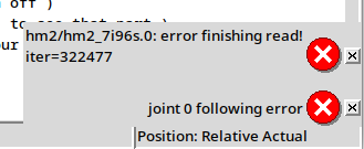

I was getting the following errors mainly on the synced Y, although I also got it on the X during a couple of tests. I've' been playing with this thing most of the evening and am still not happy with the way it is running. I have a configuration that I am more comfortable with than I was before but... (there's always a "but") I am suspicious that the little mini pc that I am running this on may have some issues. I have noticed that after a certain number of times running, stopping, running linuxcnc to test, the performance starts to degrade. A restart of the pc helps but I don't know that I trust this OS install (done way back in May). I am tempted to wipe it and start from scratch - I remember getting it running was a bit of a pain (at the time) and I read elsewhere on this forum that there is a bookworm distro that may be easier to get working that what I went through. On the other hand, it is (mostly) stabile. Maybe I need to dig into stepper tuning further?

I think I should have prefaced the following errors with:
I am getting a "hm2/hm2_7i96s.0: error finishing read" error. I didn't notice this until after reloading Linux on this box. I just spent the last hour reading the back and forth forum.linuxcnc.org/27-driver-boards/4691...error-finishing-read which I must say is very entertaining but not encouraging. I've got a few things to confirm and check out on that box and then I'll get back to everyone on this.

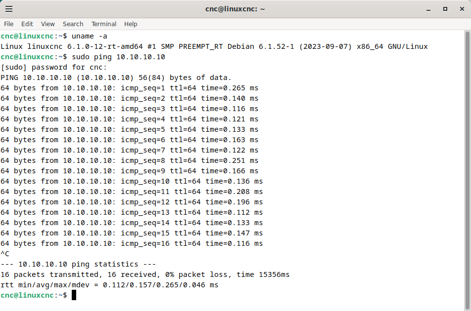

OK that's different, that means the the Ethernet latency is bad enough to cause
multiple sequential dropped packets.

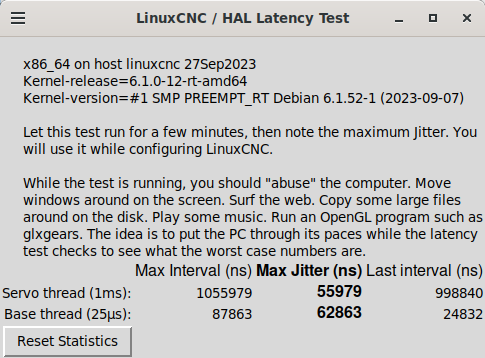

Did you run a standard latency test?
What does:
uname -a
report
Whats does
ping 10.10.10.10
report?
What does:
uname -a
report
Whats does
ping 10.10.10.10
report?

27 Sep 2023 20:39 #281740
by Sparkman61
Replied by Sparkman61 on topic A little help understanding what's going on with the pncconf wizard...
Take a gander.
- Posts: 18026
- Thank you received: 5295
27 Sep 2023 21:59 - 27 Sep 2023 21:59 #281743
Replied by PCW on topic A little help understanding what's going on with the pncconf wizard...
That does not look terrible though you may be better off with a newer
(say 6.4 or 6.5) kernel.

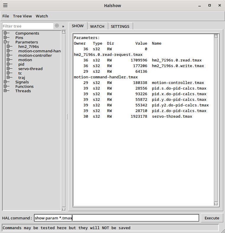

Can you run LinuxCNC and print the results of:
halcmd show param *.tmax

29 Sep 2023 14:02 #281859
by Sparkman61
Well, one day turned into two - here is a screenshot of the hal command window right after jogging around and getting the error(s) (see attached). If I need to install a different kernel, how would I go about that?
