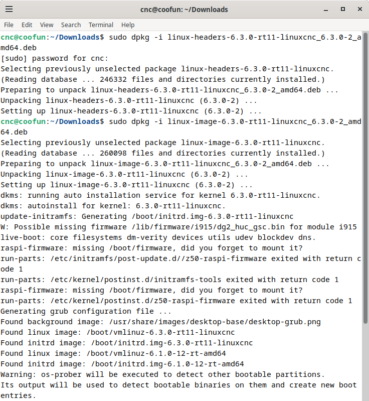

Finally got it downloaded and ran per instructions but the sudo dpkg -i linux-image ... exited with errors - some of this looks like it might be related to raspberry PI but before I execute this, I thought it best to ask if this is "normal". Please see attached.

Replied by rodw on topic A little help understanding what's going on with the pncconf wizard...
Odd, the raspi error was a bug in Bookworm 12.0 that was fixed in the 12.1 update. I had not see it break before.
Forget the kernel for now. Do
sudo apt update
sudo apt upgrade
That should get you to 12.1
Then do the dkms driver thing
sudo apt update
sudo apt upgrade

The suspense was killing me so I went forward without confirmation that the errors thrown were not going to be too dangerous and at least the thing sill boots - with the 6.3.0-rt11-linux #2 SMP PREEMPT_RT kernel no less! Moreover, ethtool confirms that it is using the r8168 driver.
Now to test linuxcnc and see if it still throws errors. If it does, I guess I'll be in the market for a new PC to run this on. Wish me luck!
